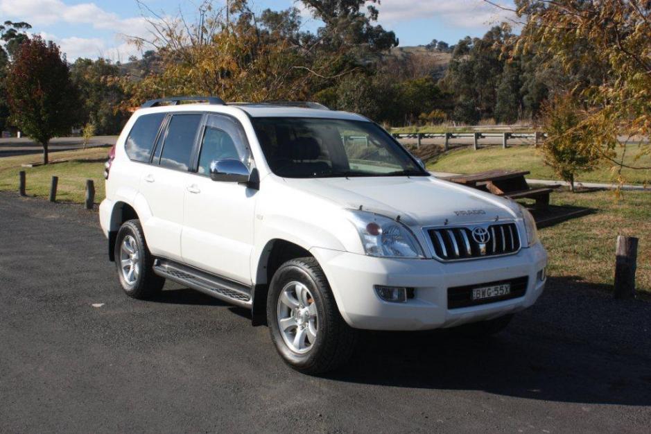

We picked her up May 2011 and as you can see from the pic she was basically a blank canvas as far as mods were concerned, and was very tidy except for a decent scuffing on the front BumperThis was the start of what I see as a long journey which[I] may take a while to complete!
Penny is a 2003 120 Series Pearl V6 Petrol Prado.Originally looking for Diesel GXL Manual at the time but there wasn't any suitable locally and interstate the story was the same.We then found this one which was within the same price range, in a Grande ( which creates it's own problems which I go into later ) and it was Petrol.
