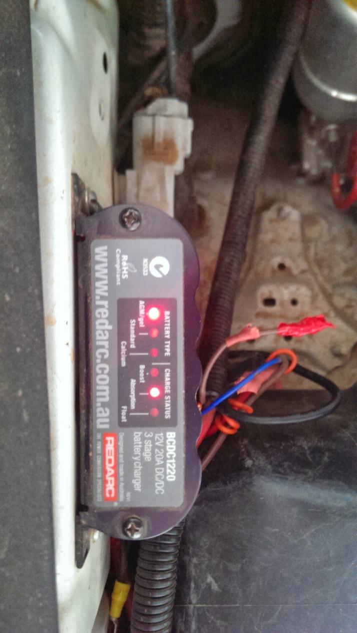

              RedARC BCDC for keeping everything fully charged, mounted on the RHS firewall. Easy to read the display to check what's going on, also thinking of adding an ARB Sidewinder meter in the rear above the 12V to compliment.

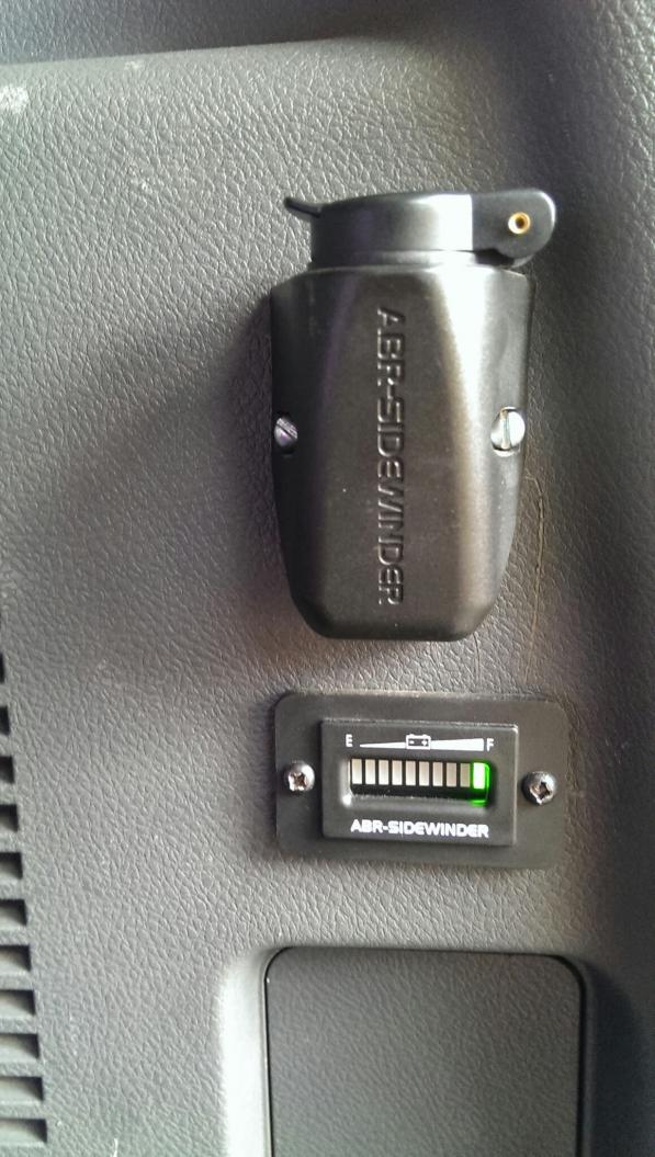

                    Finally got around to getting the ABR-Sindwinder gauge in..... and the Hella socket, much neater and stronger connection....
Name:	ABR Sidwinder Gauge.jpg
ID:	645582Click image for larger version
Name:	Redarc BCDC1220.jpg
