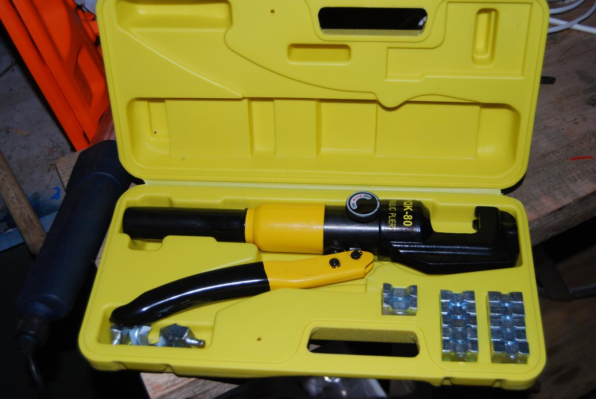

        4. New 8-Tonne Hydraulic Crimper Tool (This thing is awesome!)

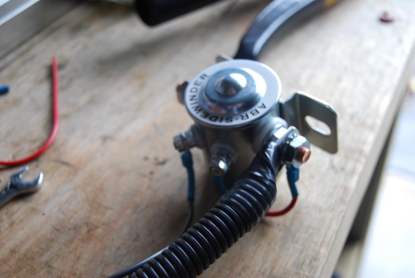

        2. Wiring up Solenoid before install

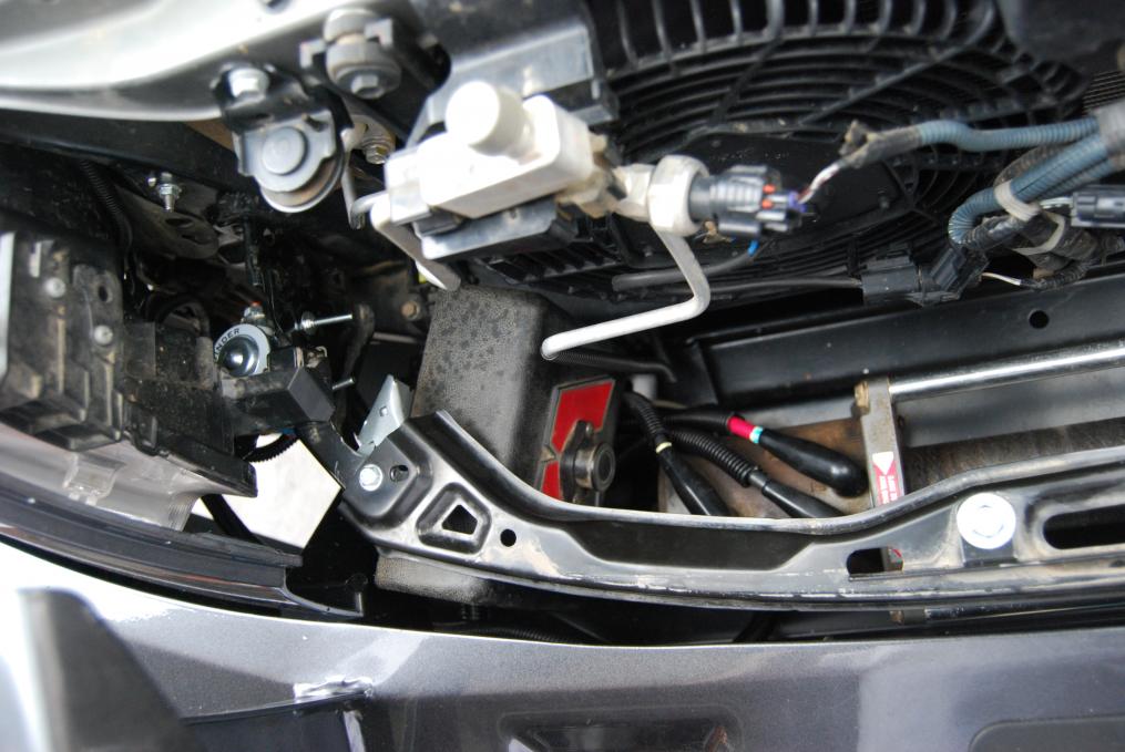

        3. Mounted up below the front right headlight.

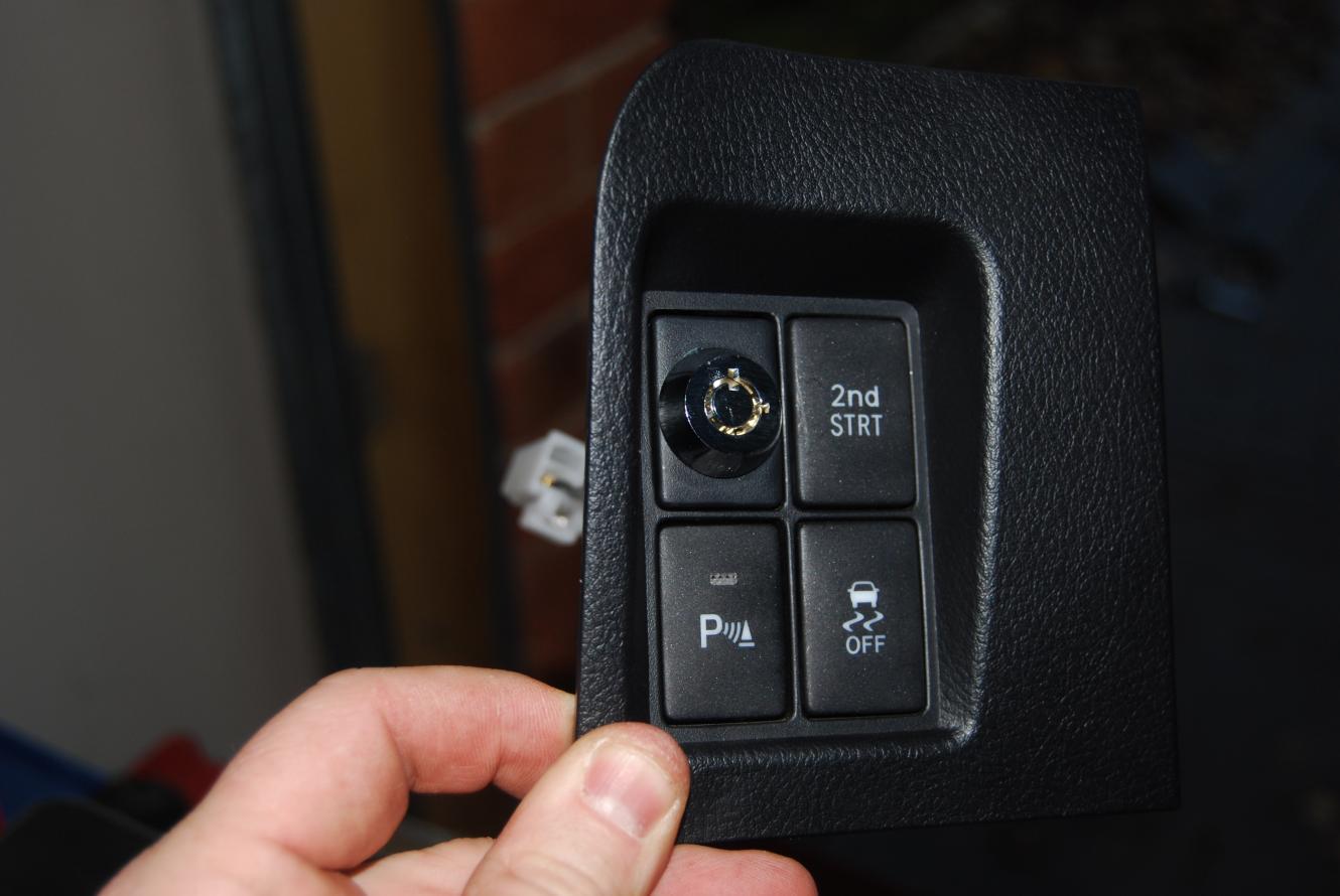

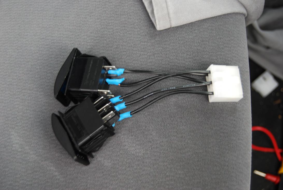

          4. Get all of the switch wiring ready.
ID:	639886Click image for larger version

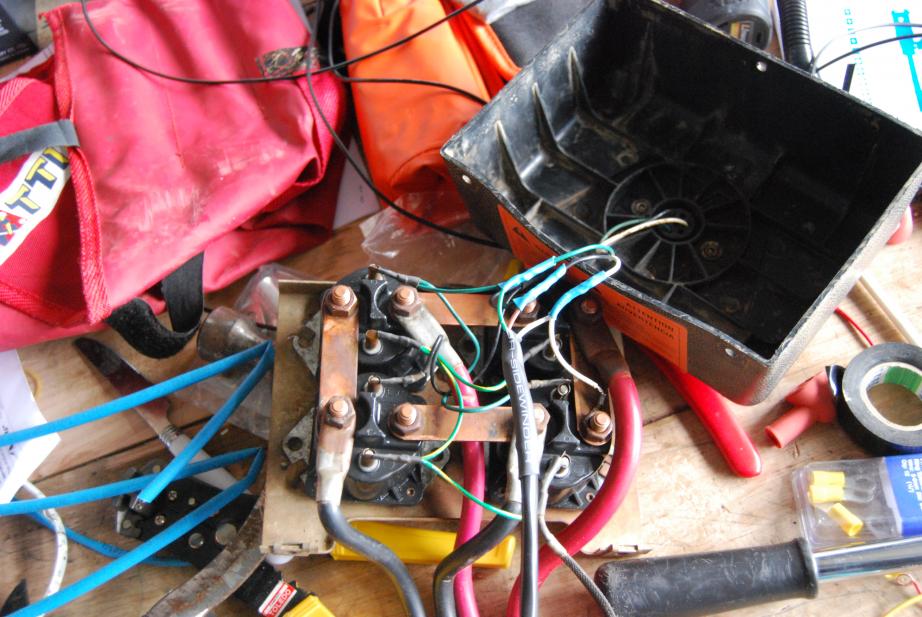

          5. Splice in Winch Controls
          6. All Done.
ID:	639887Click image for larger version

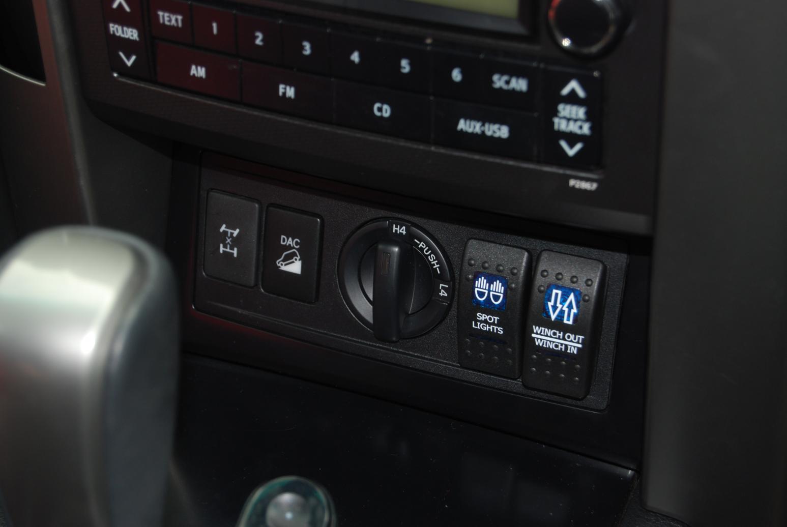

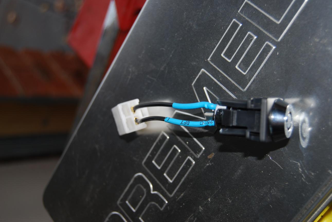

          Locking Switch in Dash

            Interesting idea with the solenoid, I've been thinking about this myself. The Warn will pull 400-600A under load, I'll be interested to see how long the solenoid lasts. I've been looking at using one of the BlueSea battery switches.
              Hmmm, thats a (big) concern.... thanks D4D.
              I will do some research and see what I can come up with...... Last thing I want to be doing is fishing around under the car trying to bypassing the solenoid when I'm stuck!.
              ....Sh$t.
              Bernie.
                No problem, looks like your winch is an XD9000, here are the current draw specs per layer
                http://www.warn.com/truck/winches/src/XD9000.shtml
                D4D
                Addicted PP Member
                  Ok, had a quick look at the spec's for the WARN XD9000, mine is an old 9000 so I am assuming it is the same.
                  From the stat's below I think I would need ~180amps to pull 2 Ton, so I am thinking if I double up the 100AMP solenoids in parallel it should be good to cover most of my situations...... . Not sure what impact the "Layer" stat's have on this....
                  Will think some more...... big over-site, was focused on form a bit more than function
                  Warn 9000 Winch.
                  12V DC PERFORMANCE SPECS
                  Line Pull
                  Lbs.(Kgs.) FT./min(M/min.) Motor Current Pull by layer
                  layer/Lbs(Kgs.)
                  0 38(11.6) 70 amps 1/9000(4082)
                  2000(910) 14.4(4.39) 180 amps 2/8190(3715)
                  4000(1810) 11(3.35) 255 amps 3/7500(3402)
                  6000(2720) 8.67(2.64) 330 amps 4/7010(3180)
                  8000(3630) 6.88(2.10) 415 amps
                  9000(4080) 6.38(1.94) 460 amps
                  berniebgf
                    The 'layer' stats mean what layer of rope you have out. As you can see the more rope out the more the winch can pull however this also means higher current drawer.
                    You need at least a 500A capable device if you want to switch the positive and have some headroom.
                    You can switch the low current negative. This will disable the winch but not the high current positive.
                      So, if I switch the negative, how many amps would I need to cover?
                      Also, what's your opinion of how much weight is on the winch when winching up the side of a steep hill?
                      I would not think it would be the whole weight of the car (2 ton), however if stuck in a mud hole with suction different story.
                      (Every situation is different that's the issue.....)
                      Thanks for the info.
                      Bernie.
                        The motor ground in the pic is what you want to switch. In my previous winch fitting I just used a standard 12V 10A switch.
                        The winch can only pull as hard it is designed to pull otherwise it stalls. Therefore don't think about how much weight you have to winch, think about how hard the winch needs to work. If you're just hung up on a ledge then a short winch should suffice however if you're in mud the a long winch will be better as the winch can work harder. In this case you could also look at a double line pull with a snatch block.
                          Nice looking Rig Bernie, it's great to see guys that do it themselves and offer this information with photos to the rest of us out here. Great build up and some great threads on the installs you have done yourself.
                            Thanks D4D.
                            I'll take your advice and just re-use the Solenoid for the Motor Ground and re-run new power cable straight to the winch (K.I.S.S)
                            I can see from the solenoid pack in the winch that the "Motor Ground" is the WARN Solenoid "trigger" ground (that's what I'll call it), so this will in essence perform the same as what I am doing with the separate Side Winder Solenoid anyway.
                            So clear in hindsight, bugger.. Oh well thanks again D4D!! Back under the bonnet for me!! :lol:
                            At least I get to re-use my 8 Ton Crimper again!!! :lol:
                            Thanks again D4D, I owe you one.
                            Bernie
