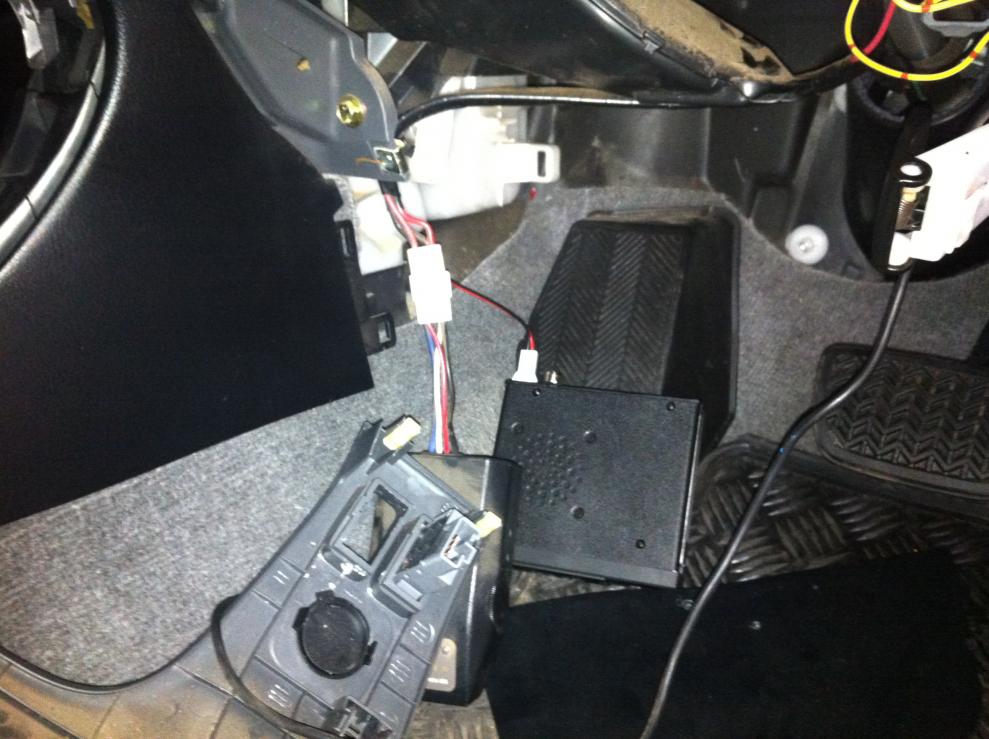

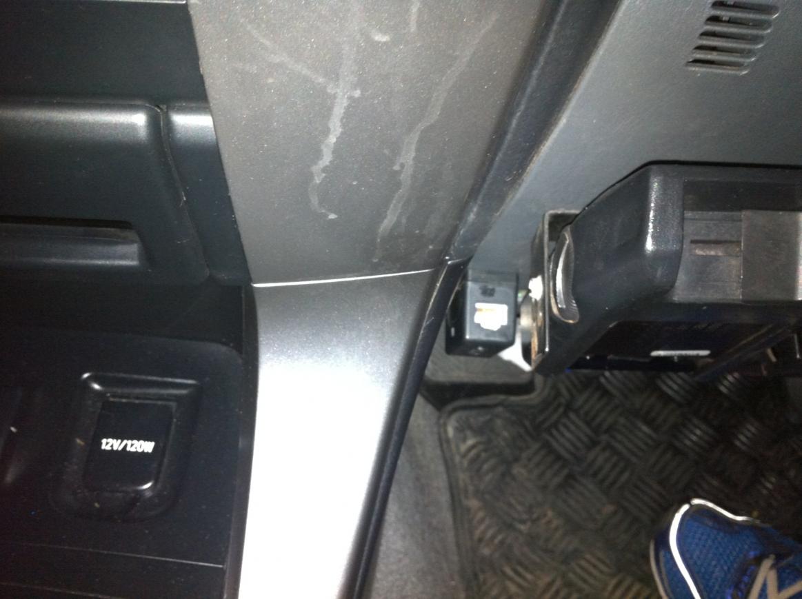

              Another one to cross off the list: UHF radio. I didn't get too many photos as I was too engrossed in what I was doing.
              The plan was to knock it over in an hour or two, but my 11 year old daughter wanted to help so it turned into nearly four hours. A long day, but how many times do you get when the kids just want to hang out and do something like this???

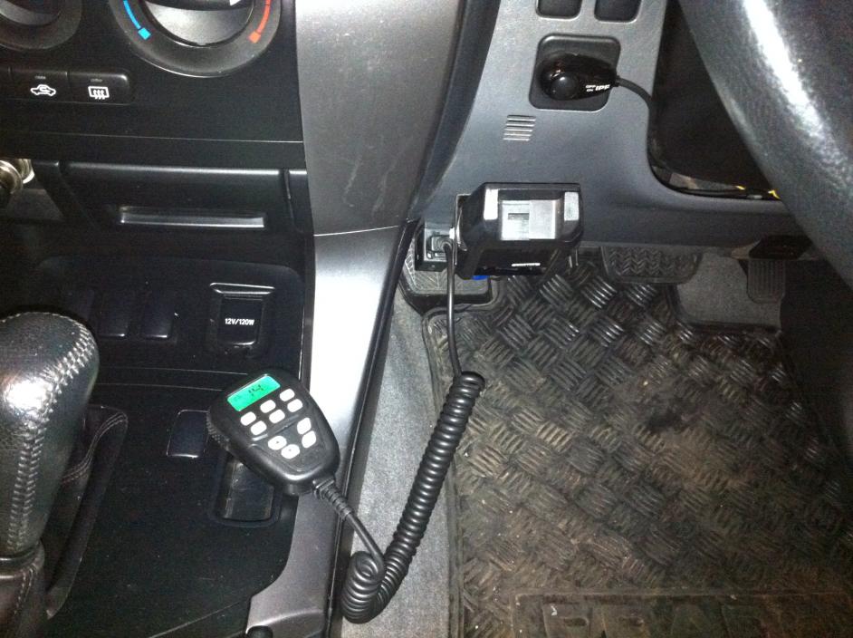

                Ok, some photos of last weekends install of my GME TX3540 UHF.
                The unit is hidden in footwell on the drivers side.
                I installed the handpiece plug down next to the electric brake unit out of the way.
                The handpiece I haven't found a permanent place for. At the moment I hang it on the sunglasses holder when I'm using it. When not in use it is disconnected and stored in the glovebox.

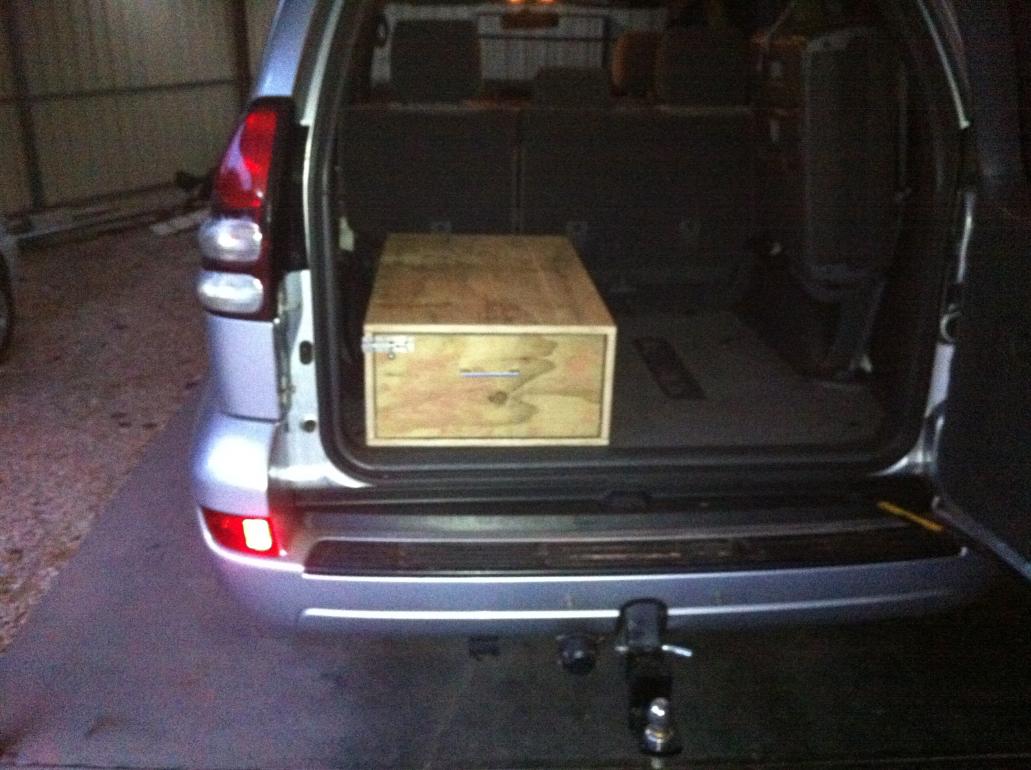

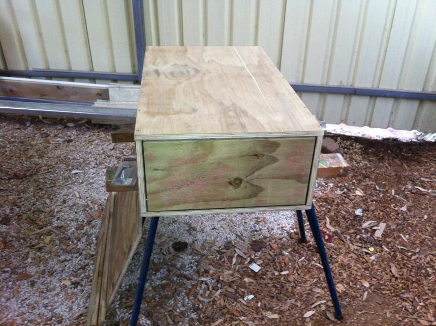

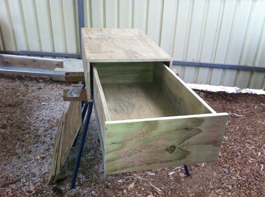

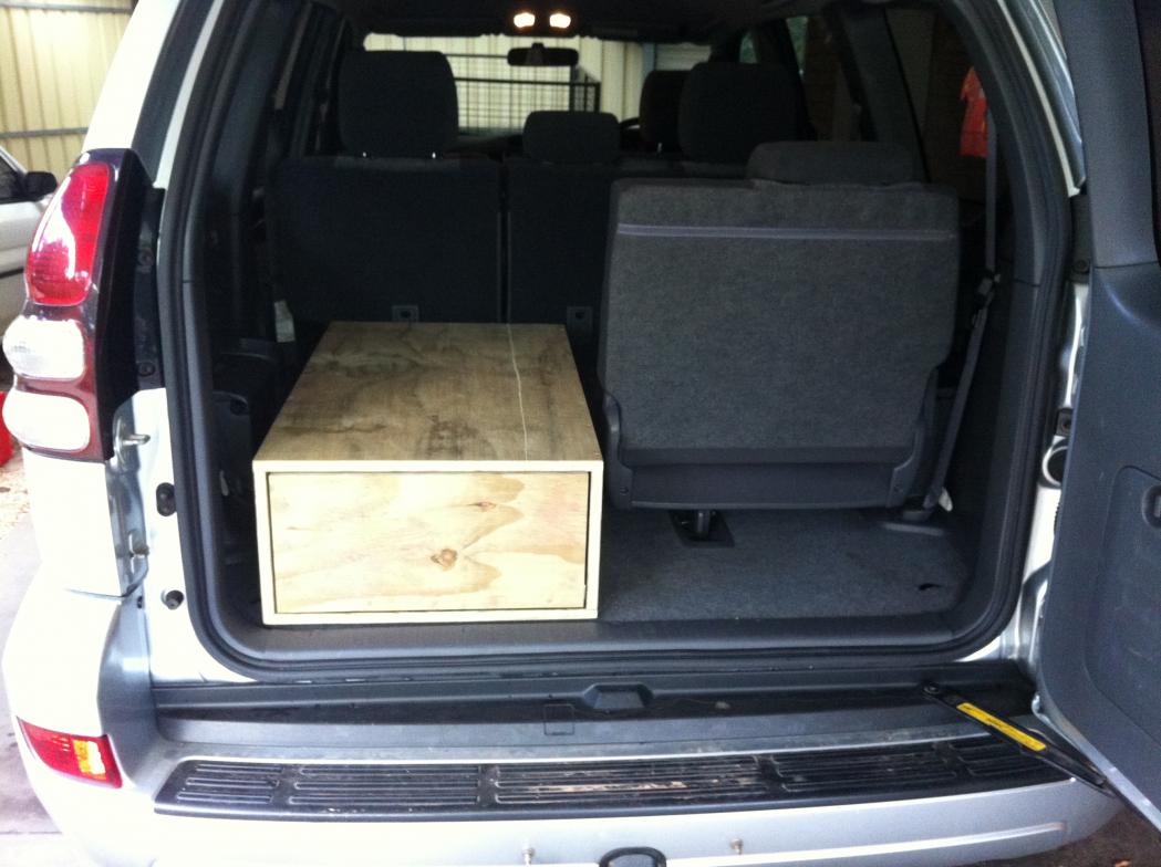

                  And with some spare time during the week I managed to knock up a single drawer.
                  I had some 17mm moisture proofed ply in the shed that had been hanging around for a while. The dimensions of the outer box are: 875mm long x 510mm wide x 265mm high. It's possible to fit a unit that is 1m long in the back, but since I have a cargo barrier that will go in when we travel, I made the drawer to fit with the barrier installed. The hardest part was to get the slides to run freely. The rear of both slides had to have a thin bit of laminate wedged between it and the side wall.
                  I toyed with the idea of re-using a T handle from a previous drawer, but I thought of using it for another project around the house. The only things left to do, is whip up a mounting bracket and carpet the unit. My last effort of carpeting didn't go too well, so I'm trying to rope in the missus to do it for me. Don't like my chances, but you never know your luck.
