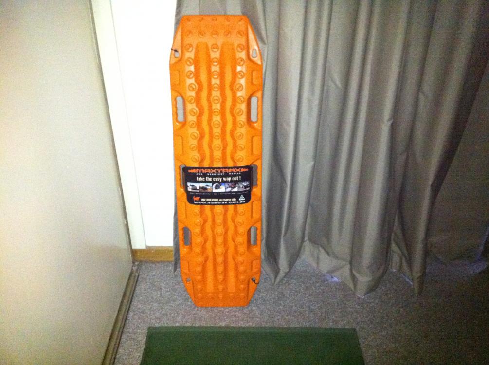

            • #51
              I was another that took advantage of Supercheap Auto's 20% Saturday. Another addition that will come in handy at the GTG.
              • #52
                Nice work mate, got myself an additional set in the same sale... Awesome price!

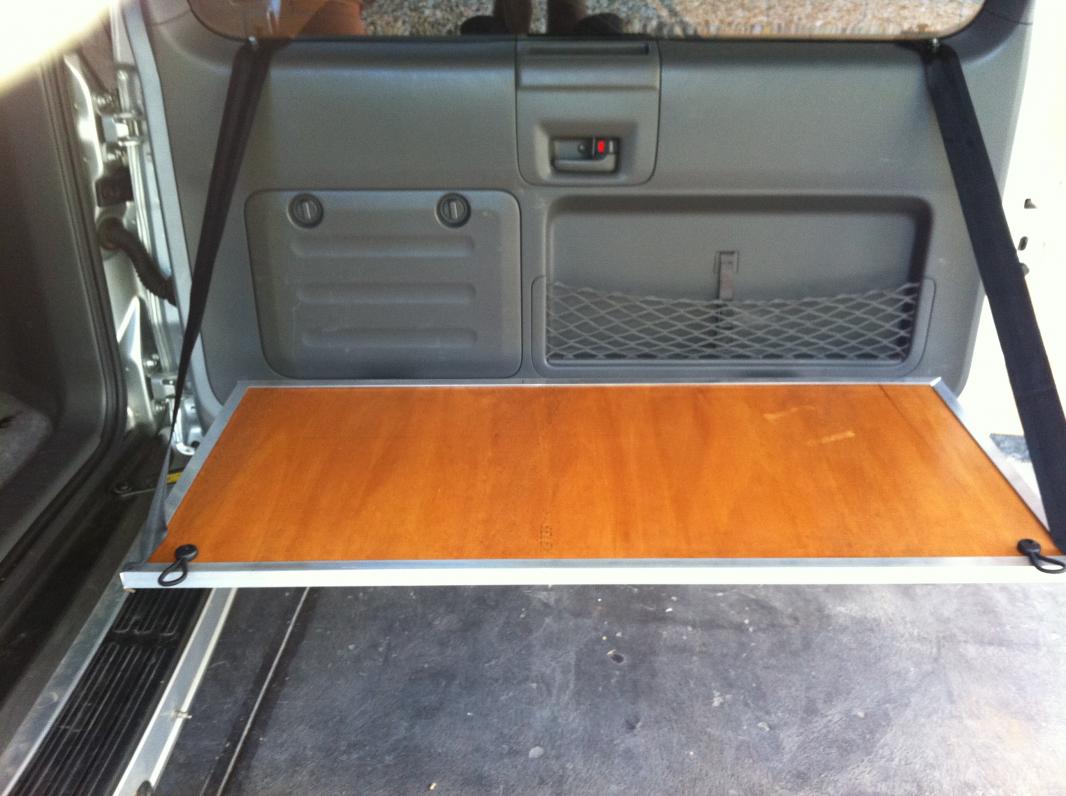

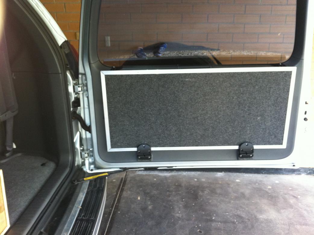

                              • #60
                                Righto, spent this morning finishing my fold down table.
                                Mostly it's the same as other PP'ers except I only carpeted one side. This was to allow for any spills whilst in use. Now I can just wipe them up and no waiting for carpet to dry. I had some Merbou stain is the shed which was applied to the plywood for a little colour. Then it was a coat of marine gloss to finish it off. It will get another couple of coats in the coming weeks for added protection.
                                I'm pretty happy with the aluminium framing, could do with a little adjusting but it will do for now. The hinges are Evacool plastic ones that clip in and out.
                                Not a bad effort if I do say so myself.
