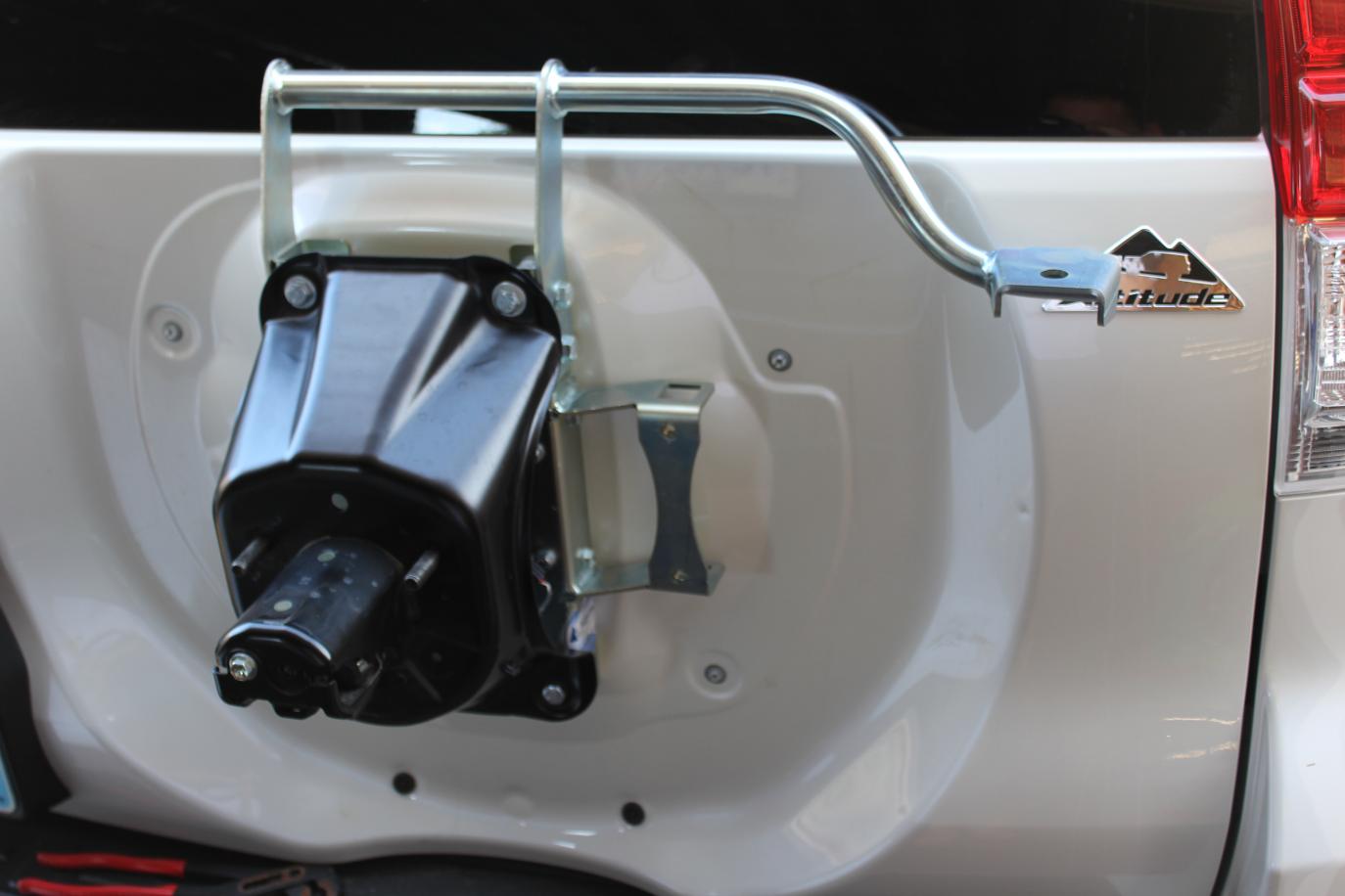

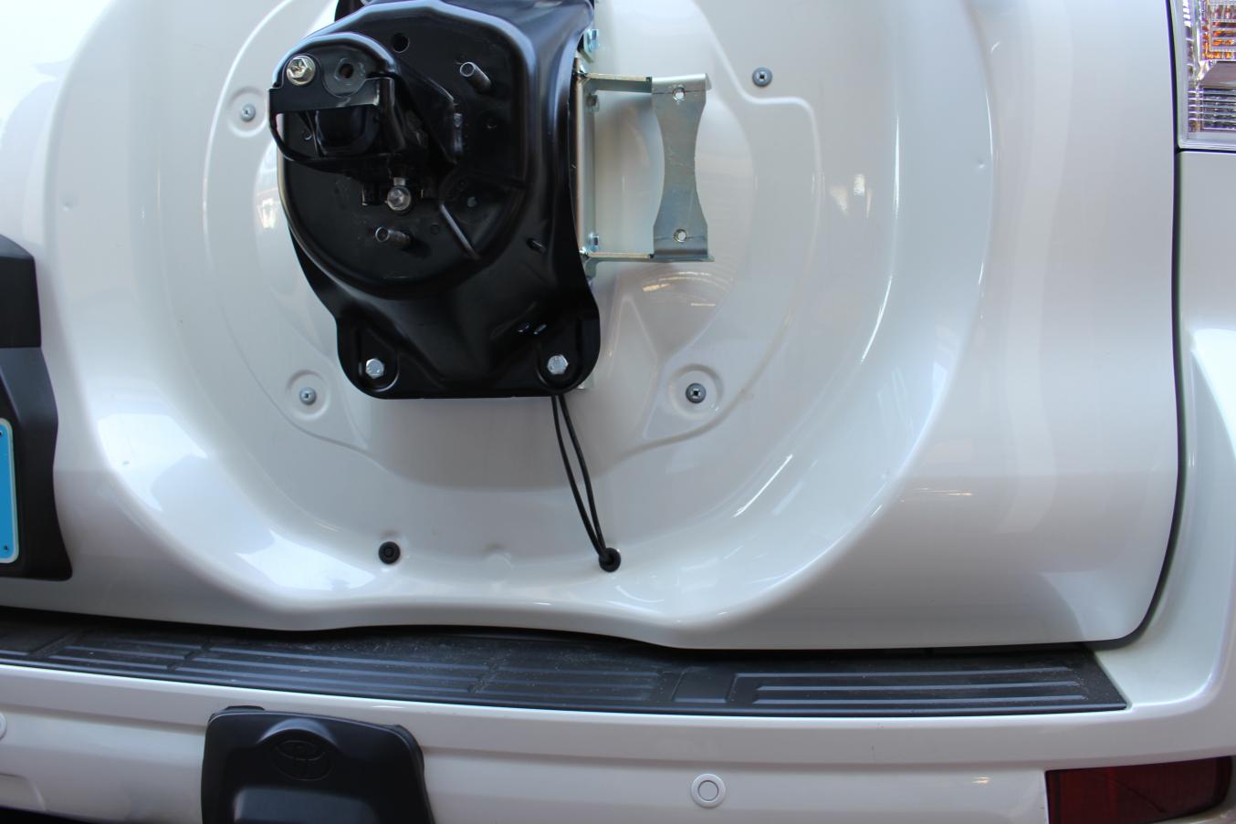

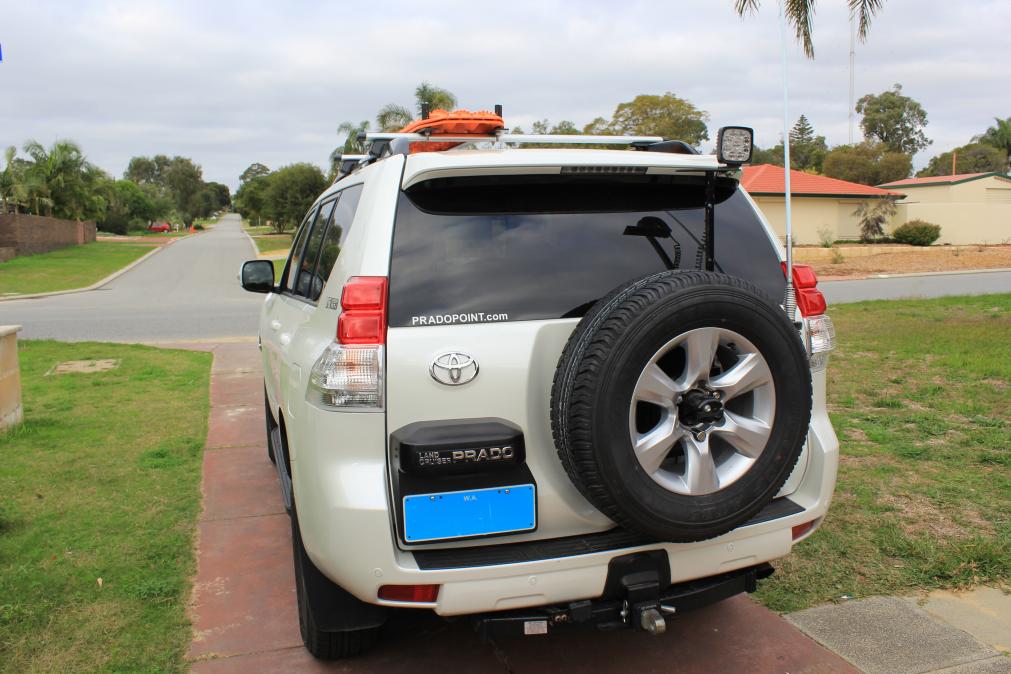

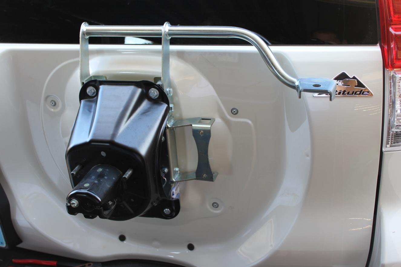

          I Haven't done much lately, 1 thing i did get around to doing is to fit a Kaymar rear wheel spacer with Aerial mount.
          I used this as i didn't want to fit my aerial to the Bull bar, when it goes on.
          At the rear, its out of the way, not in eye sight when driving, and a little higher.
          I only screw the aerial on when going away, so around town i leave it in the back of the car, so it doesn't clash with overhead signs and undercover car parks.
          Removed the spare wheel cover, wheel, and back tyre cover.
          unbolted the wheel mount, bolted on the Kaymar bracket. there are a lot of bolts to fit, when you add on the aerial mount as well.
          Made sure everything was done up tight. Don't want it rattling loose over corrogations.
          Mounted
Name:	Prado Rear Aerial.jpg
          With Aerial Bracket
Name:	Prado rear aerial 2.jpg

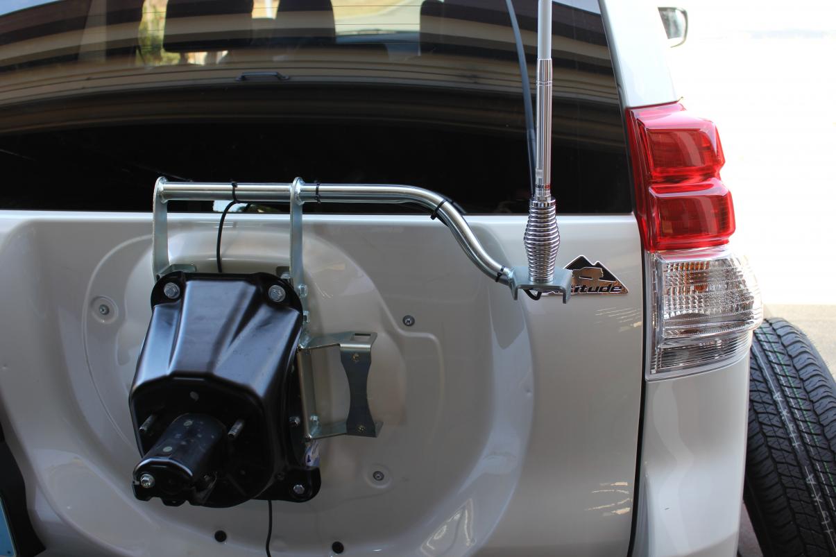

          Used the grommet at the bottom to run the aerial cable and a power cable for future rear light.
Name:	Prado rear aerial wiring.jpg

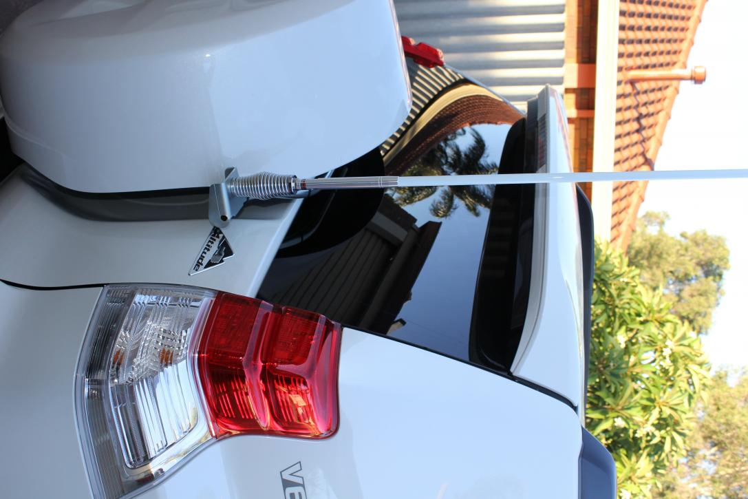

          With the aerial fitted and spare tyre cover back on
Name:	Prado rear aerial complete.jpg

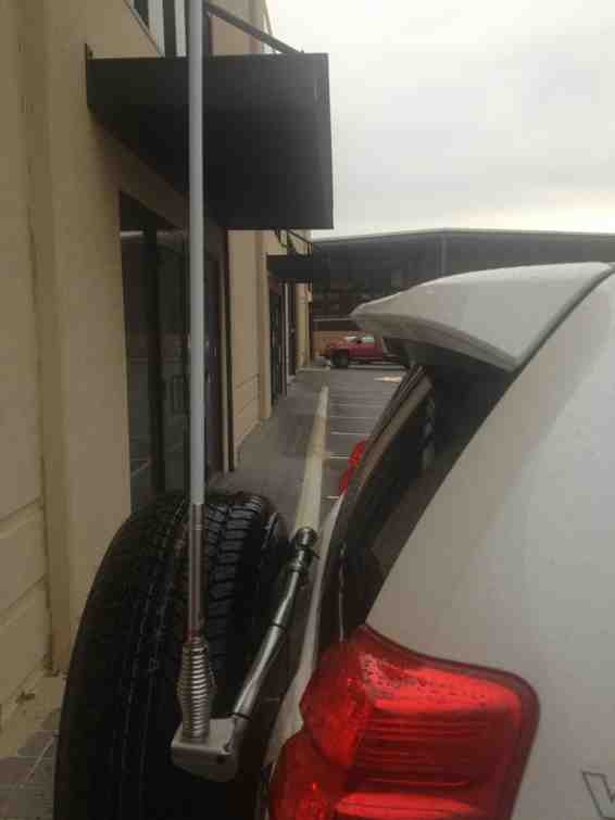

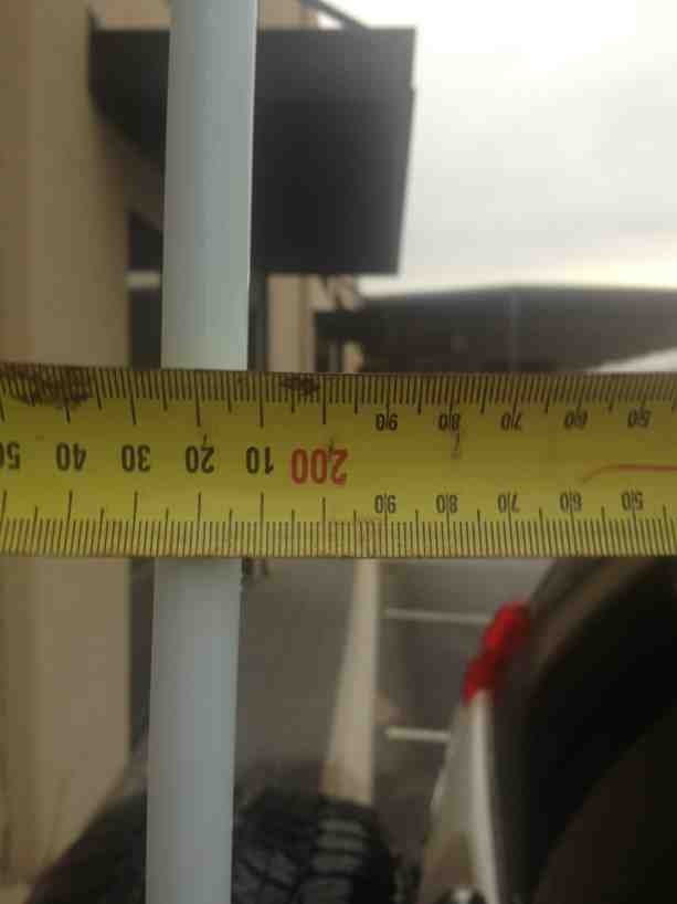

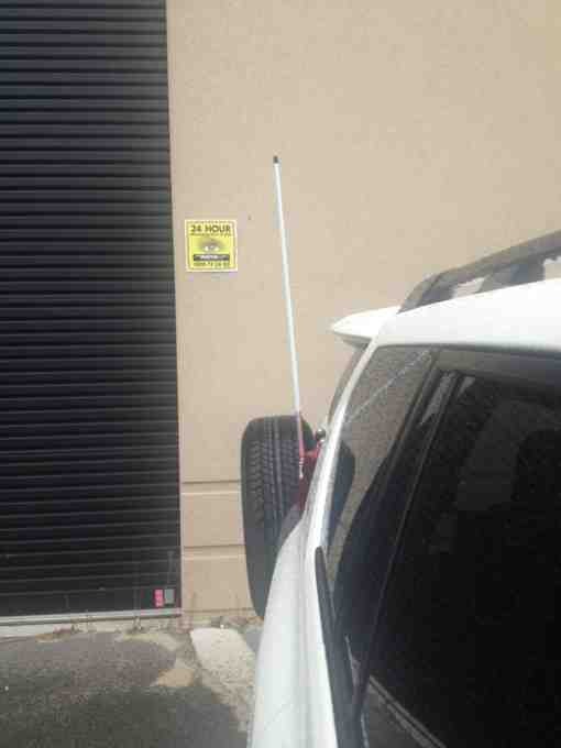

              Hi Geoff,

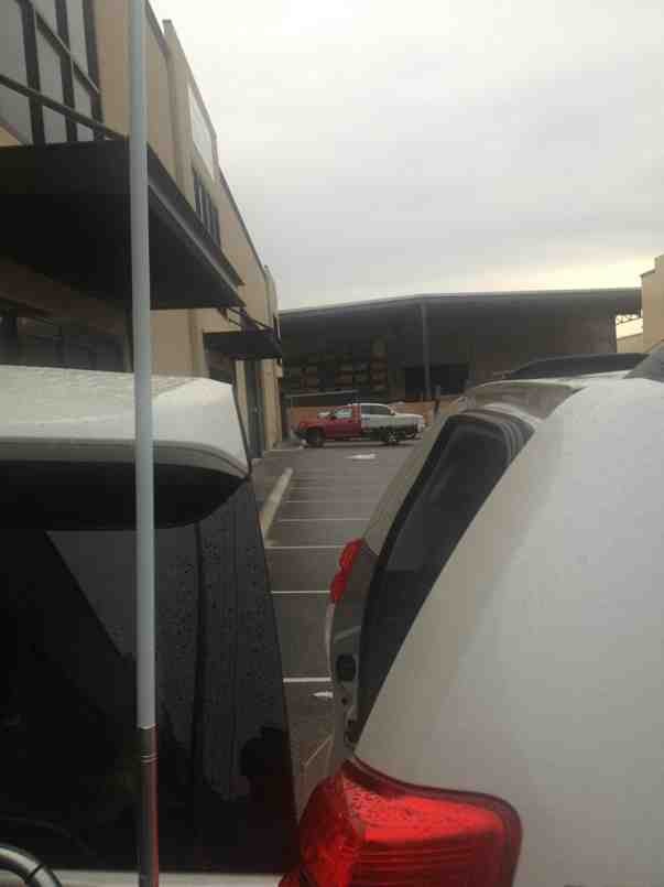

              Have you noticed the antenna hitting the rear "spoiler" or does it sit far enough away from the boot ?
              VZ
              2012 Pearl White VX, 3.0 Litre D4D Auto, Wynnum 2.5T Tow Bar, OME Lift, TJM Airtech snorkle, TJM diff breathers, Redarc EBRH, Projecta DBC100K, Lightforce XGT, EBC Nudge bar, Custom Recovery Points, TG150, ARB compressor, Pioneer Platform, Kaymar #K7123 /CDQ2195, 697 A/T's, Tin's DC trans cooler, MaxTrax on TraxRax, TJM DBS, Piranha Tray...
                Hey VZ
                The aerial sits nice and clear of the spoiler. The 1st pic below has the tape level with the furtherest curve of the spoiler. It's actually a good 50mm more than that measurement at its closest.
                The other pics below show different views.
                I haven't had any issues with it in this position, other than than the occasional soft branch from overhanging trees on the track. Even then it hasn't got caught and sprung back to hit the car.
                As a reference, its a GME 6.6 dbl aerial, and the spring mount came with the aerial.
                Tape measure

                Door closed
                Door open
                Door open side of car

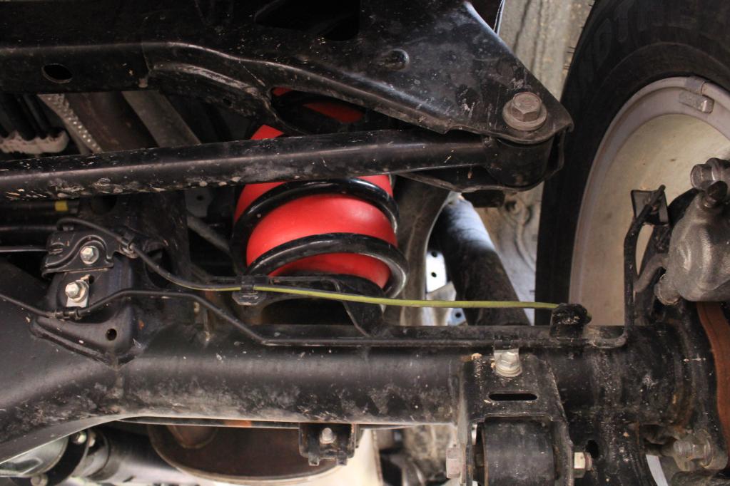

                        I went with Old Man Emu 50mm lift medium springs front and 50mm lift standard springs rear, with polyairs.
                        Before measurements were
                        BEFORE. AFTER.
                        FL. 765mm. 810mm
                        FR. 770mm. 820mm
                        RL. 790mm. 840mm
                        RR. 780mm. 840mm
                        After measurements are taken with polyairs are at 5psi. 3/4 full tank

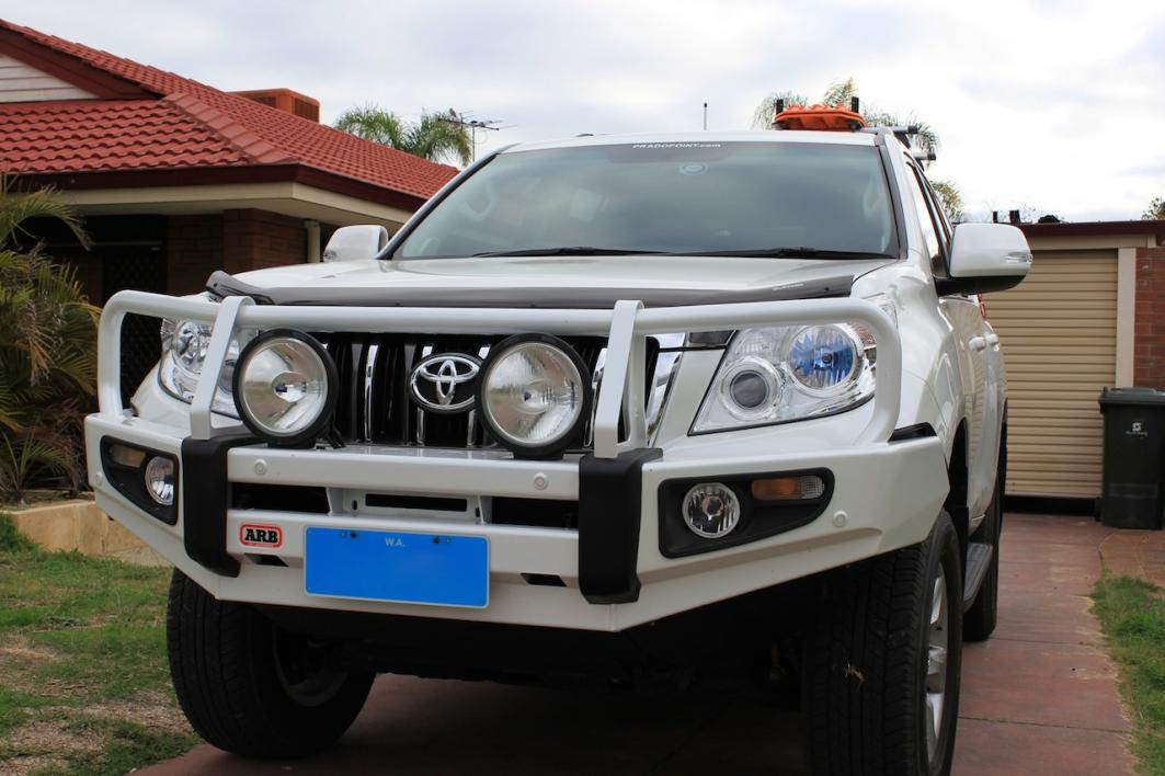

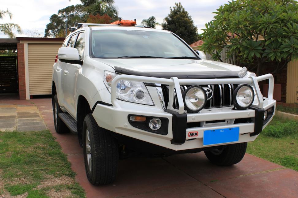

                            I have been so busy the last month or so, getting the car ready to get away, and then on holiday, that i haven't had time to update here.
                            I finally got the correct bullbar fitted, took them 3 goes.
                            I'ts an ARB Deluxe Winch Bar in Pearl White to match the car.
                            The colour matching looks damn good in person, and almost worth the hassle.

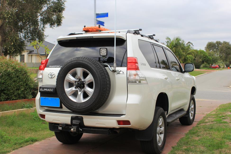

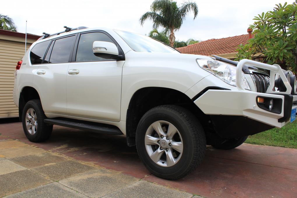

                              The suspension and bulbar has made the car look much better.
                              The ground clearance from the suspension is a vast improvement from stock, and has gotten rid of the boat feel.

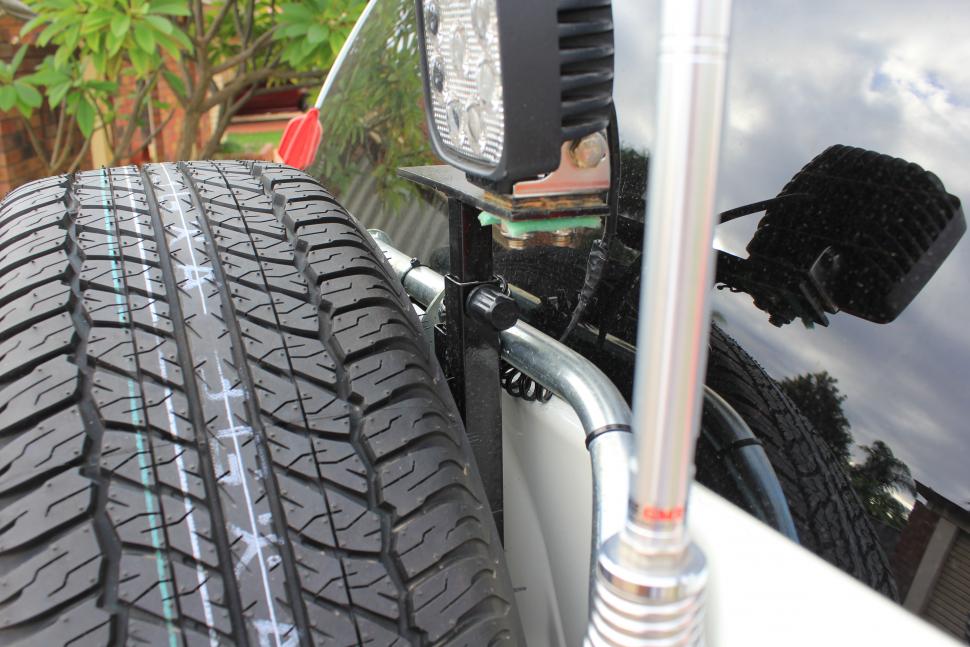

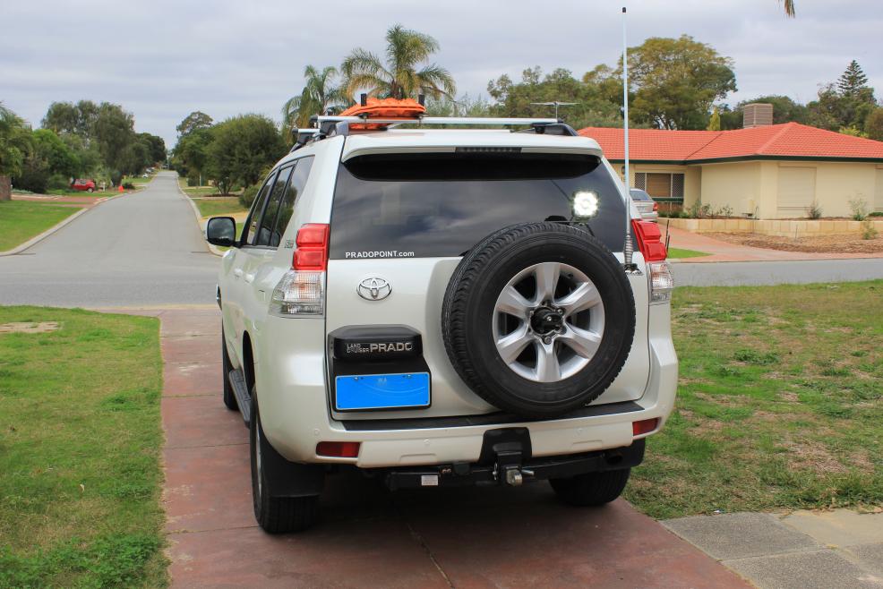

                                A also made up a rear light from some metal lying around at dads place, and he was good enough to weld it together for me,
                                since my ability to weld is more just melting two bits of metal together - badly.
                                Its welded to the light mount bracket that comes with the Kaymar rear wheel bracket.
                                Side View
                                Rear View, it does extend a few hundred MM for when I'm stopped up.
Name:	IMG_Rear RLIGHT.jpg
                                The Light is a 27Watt 9 LED light of EBay. Picked it up for $22. got a curly cable that sits inside a second tube coiled up.
                                The cable I ran thru the rear door earlier when I set up the rear aerial cable.
