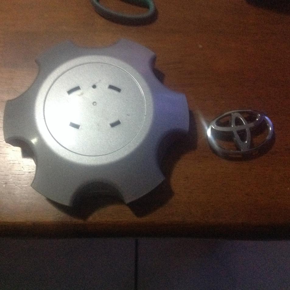

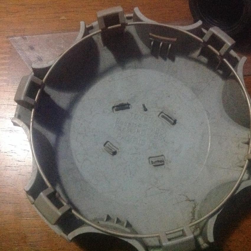

                    • I hope I'm not "he who know everything", and I know I'm not ####, but they do unclip
                      The four little tabs hold the logo on, I used a pair of scissors to depress them, but anything solid will work
                      And off she comes, easy as

                      • Thanks Andy, even easier than I thought. I hadn't actually pulled the caps off to have a proper look.
