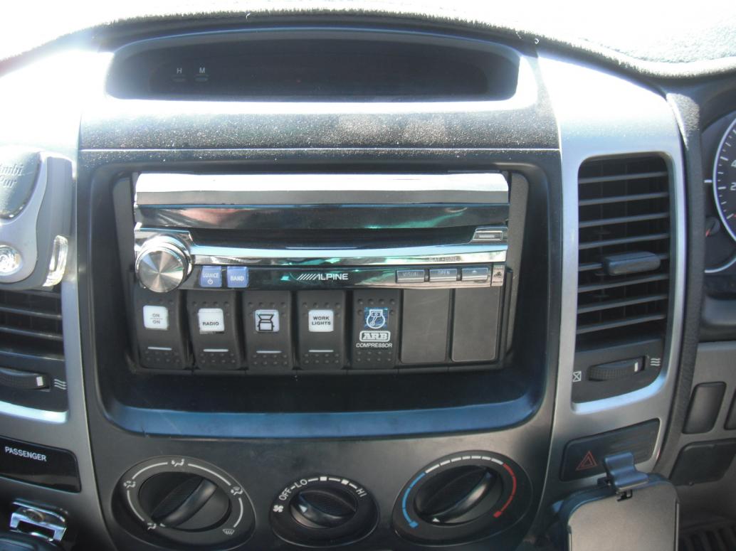

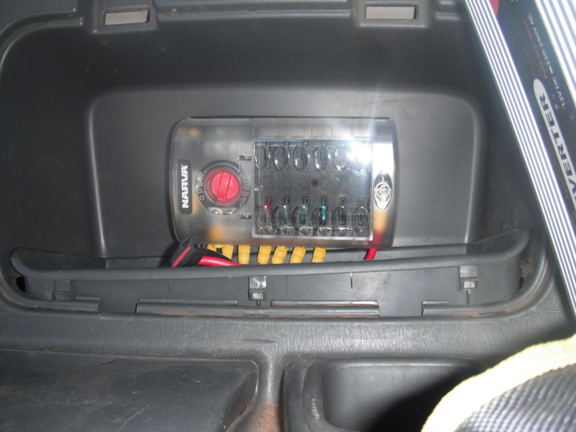

    The time has come for a tidy up of all wiring and switches, instead of having switches all over the place we decided it was time to bank them into one spot. Not using the pocket above the dvd player for anything except to store the not working remote for dvd unit, it was decided to remove the pocket and use the space more efficiently. I moved the dvd player up to the top slot and installed Narva LED ARB type switches. A narva 12 way fuse box was also installed in the cargo area, left hand side pocket to take care of all power needs for accesories and free up the battery terminals somewhat. Although operational, a few modifocations are still required to make all trims sit back in place I just haven't had time to make the last few cuts.

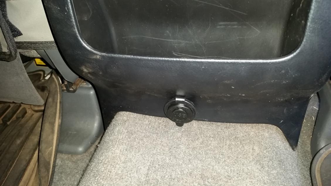

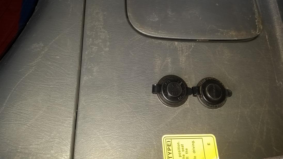

      So over the last few weeks I have been busy removing all trims in the cargo area and back doors, tinting needed to be redone. I opted for 15% on back doors and cargo area to keep it all legal, also provides that bit more sun protection for the little one. Whilst I had it all apart i figured that I may as well add a dual usb charge outlet in the back of the centre console to take care of charging phones and tablets. A cig lighter outlet and engel power outlet was also added into the cargo area to ensure the fridge stays connected and any other device can be charged.
