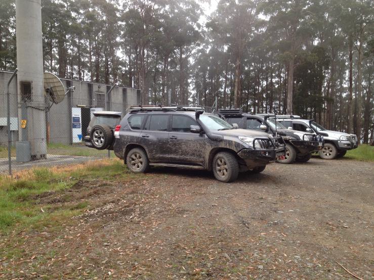

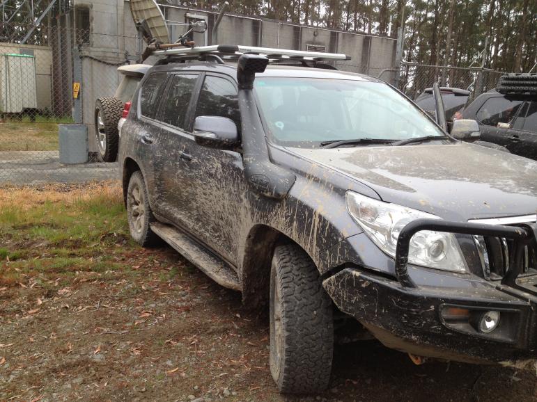

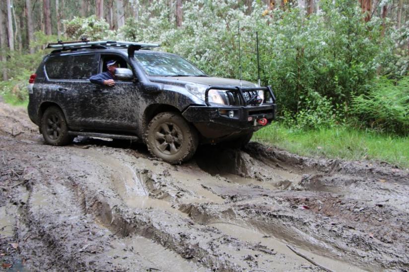

      So the 150 finally had it's Baptism in November and we had a ball and met some great PPers!

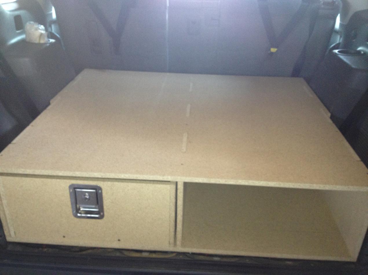

                Well after much surfing, reading and looking I finally made a prototype for a set of drawers today, good use of the RDO if you ask me. I was only going to design them and write a program for the CNC to cut them when the board comes in but I decided to run the program in some chipboard cover sheets to see if I'm happy with them. They went together pretty well, only a couple of little tweaks required. They are based on the Drifta style but didn't worry about the pull out bench. Since it gets used for work a bit I think it'll be more durable with a rubber top instead of carpet, much easier to get liquid nails or no more gaps off rubber. Any way I'll have to put some photos up later.

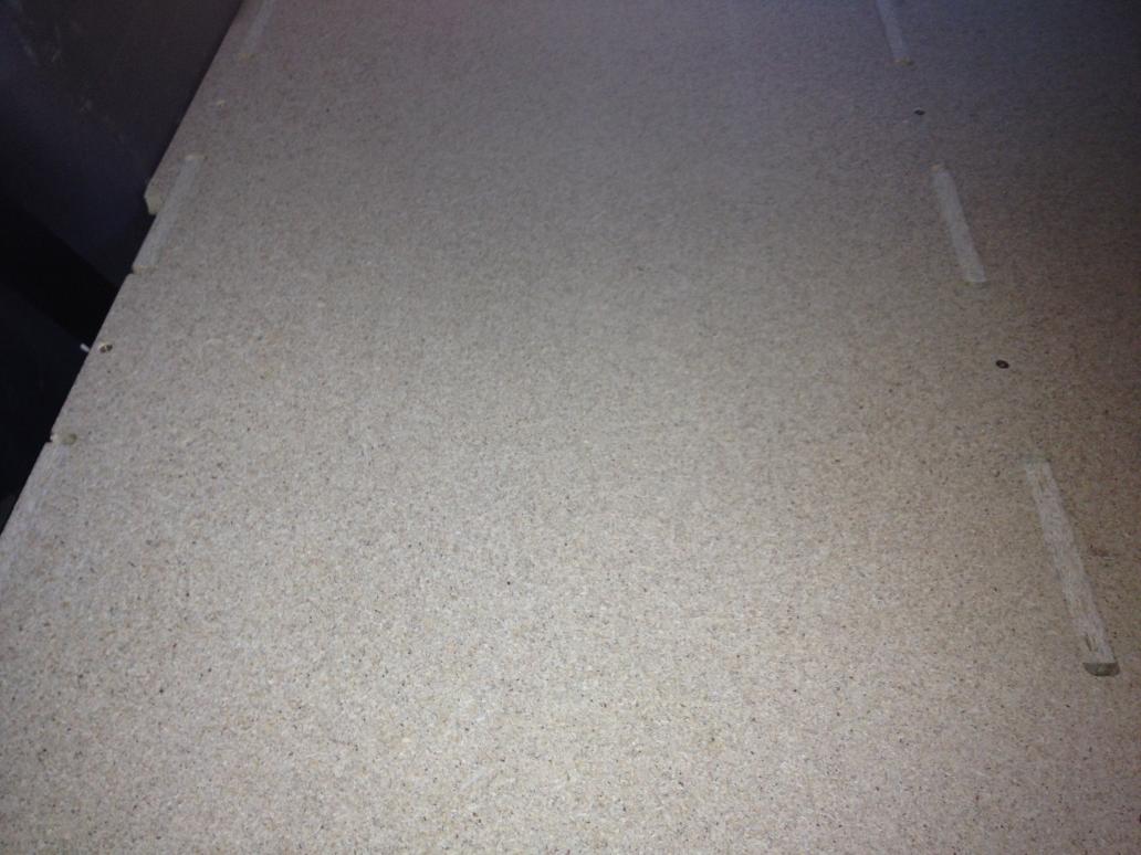

                  A couple of quick pics from the iPhone not the best but hey. Hopefully you can see in the second shot the mortice and tenon joins that are giving the unit more strength. There will be another drawer for the open side as well.

                    [QUOTE=JPH;396212Hopefully you can see in the second shot the mortice and tenon joins that are giving the unit more strength.[/QUOTE]
                    Great idea on the m&t joins! They look really profesh. You are fortunate to have access to CNC gear.
                      Thanks Madkore, hoping to come up with an extremely strong, yet light weight product, the CNC is so quick and accurate, I put the main carcase together in under 10 minutes! I've already got about another 5 sets to make for friends and interest from some PPers. So it's worth getting them right!
