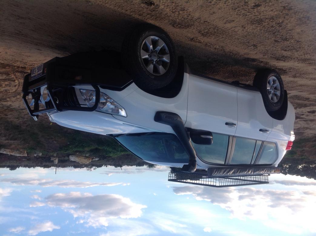

          • #50
            Azza, shiny side up!
            • #51
              Haha, yeah using the I pad. Not sure why it uploads upside down?
