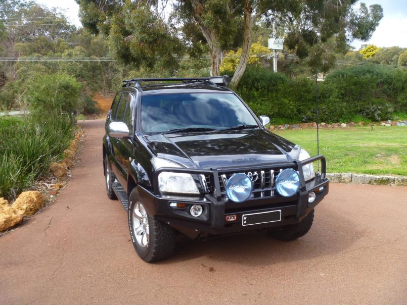

    Nice setup, I like how you have your Oztent and awning working together.

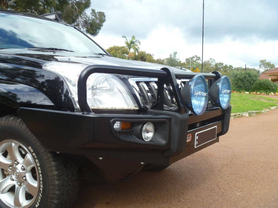

      and the most recent addition is the ARB Deluxe Bar

        The ARB bar looks so good. Nice package

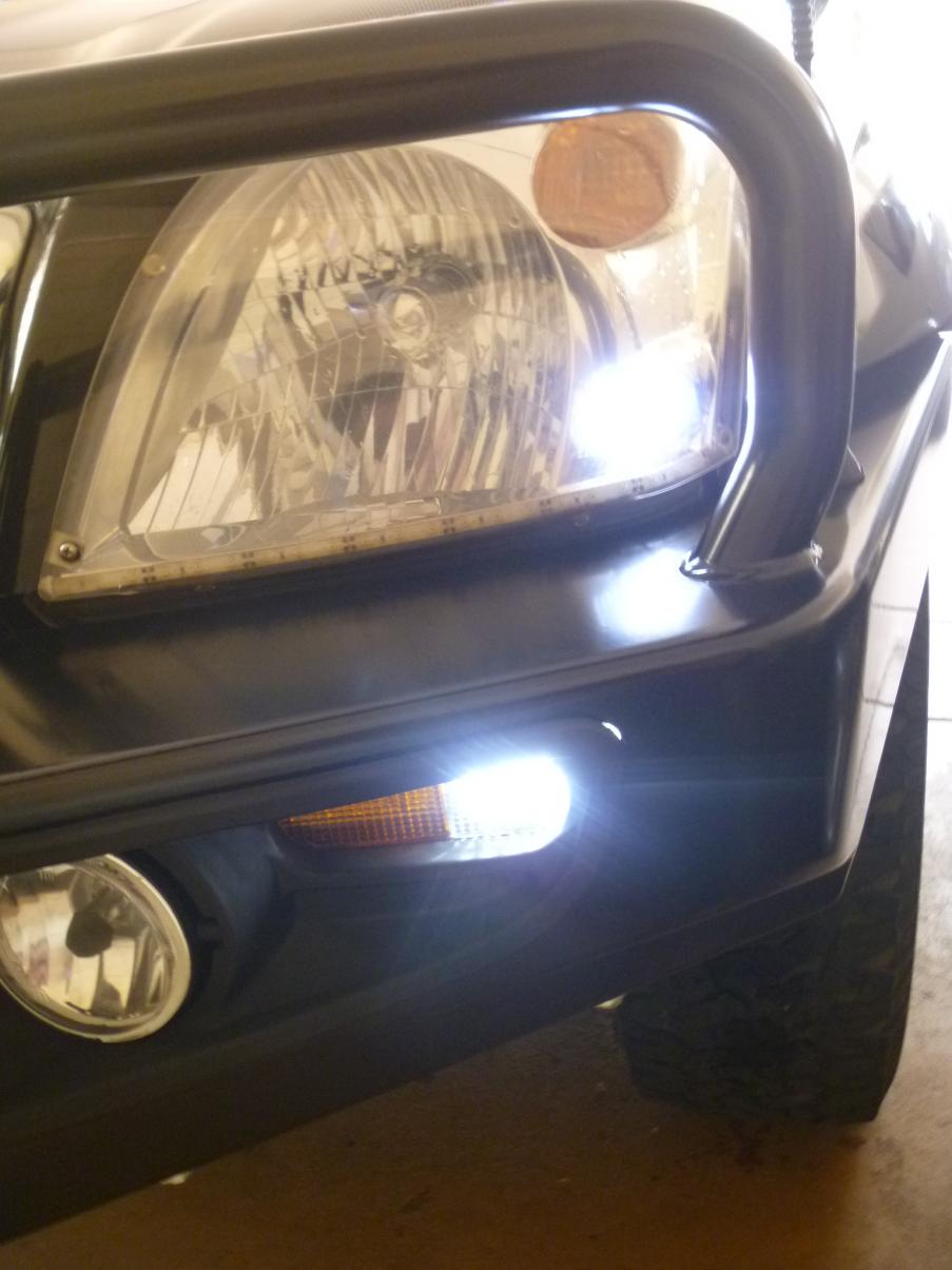

          Gota love the LED's

            Are they Factory LED indicators and park lights in the ARB bar?
                Thanks D4D - It just happened to work together like that so was quite impressed - I've also purchased a side awning the attaches to the Oztent awning which will go over the tailgate of the car and cover the work area!

                  Thanks! gives it a tougher look

                    No I actually got them of ebay - set for $44 but they were a bit longer then the original one so had to modify it slightly to be able to mount and fit it in the right position

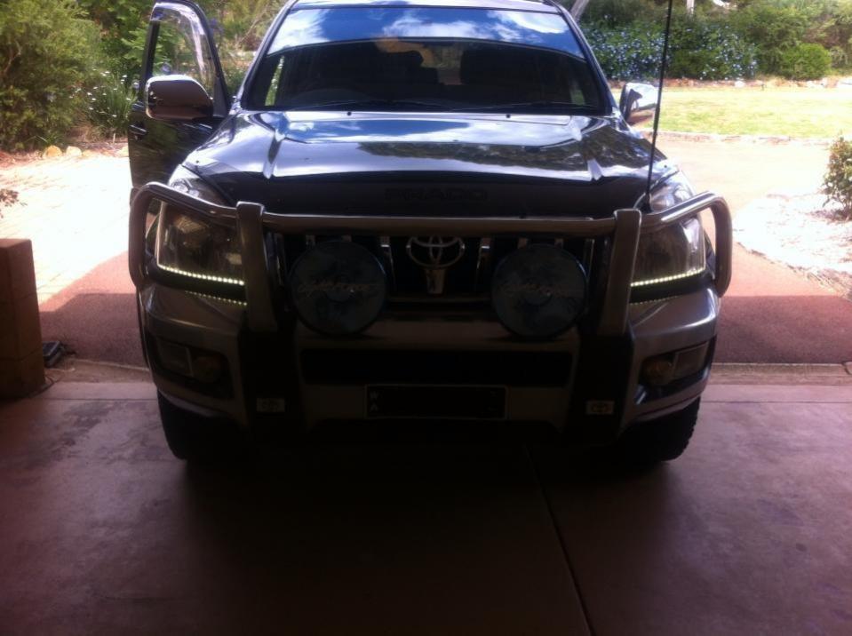

                      How did you do this? Any chance of some more pics?

                        It's fairly straight forward, just bought 2 x 30cm LED Strips from ebay and a switch to fit on the console. Wired the switch to the power wire for the electric mirrors as they only operate when the car is on. Wired the LED's to the switch and hey presto! Just need to be careful of the DRL rules in each state as they are intended to only be operated during daylight and are mean't to be conected to a module which turns them off when headlights are switched on
                        Here is another pic of both
