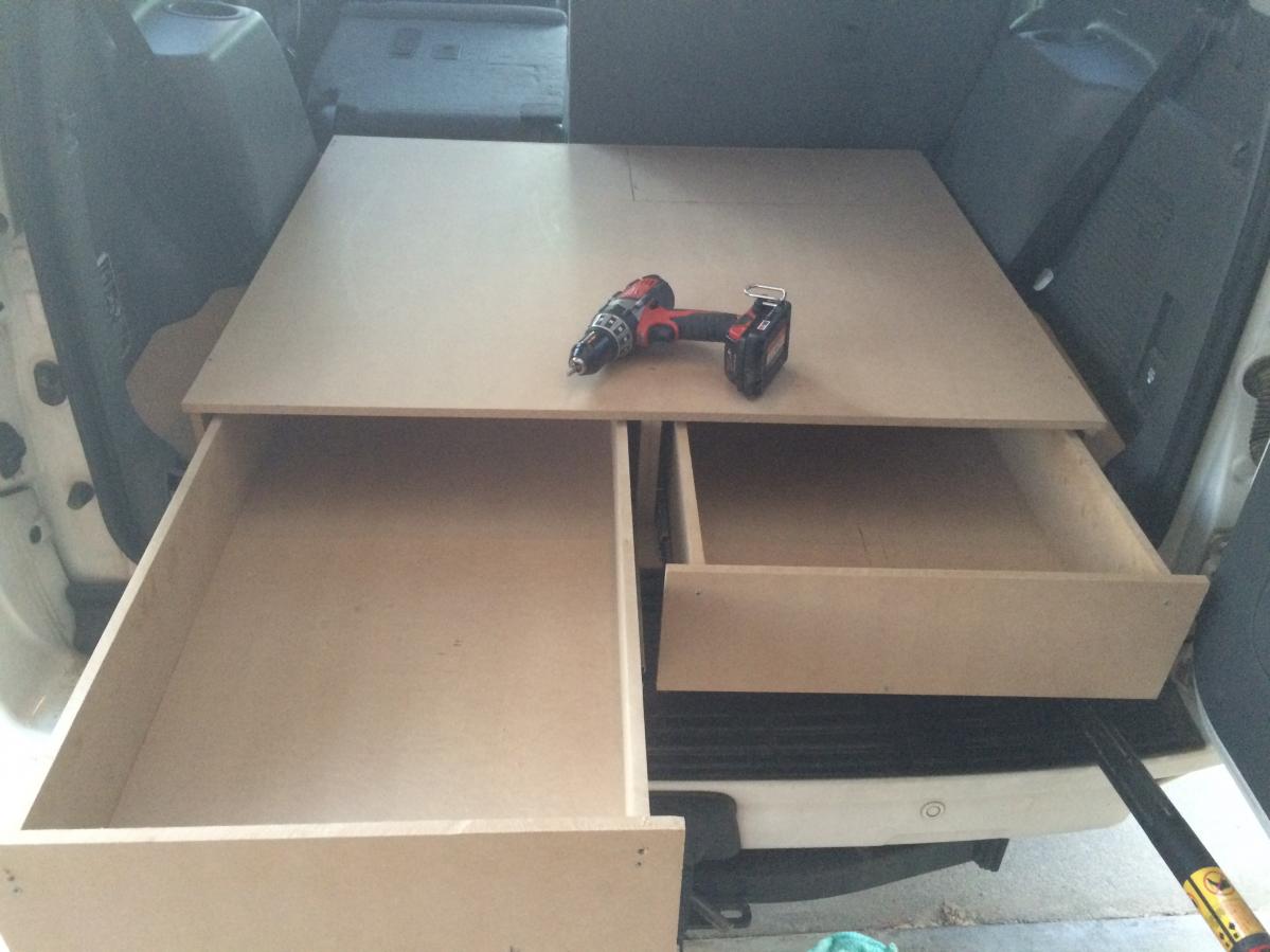

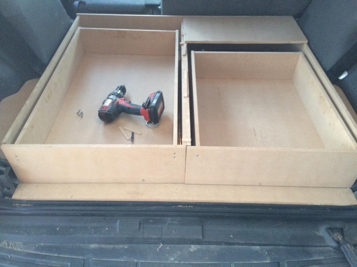

    • Of course, me not being a cabinet maker and all, the drawer bodies are 1-2mm wider than they should be...
      Looks like I'll spend part of today just making them fit!
      Spilsy

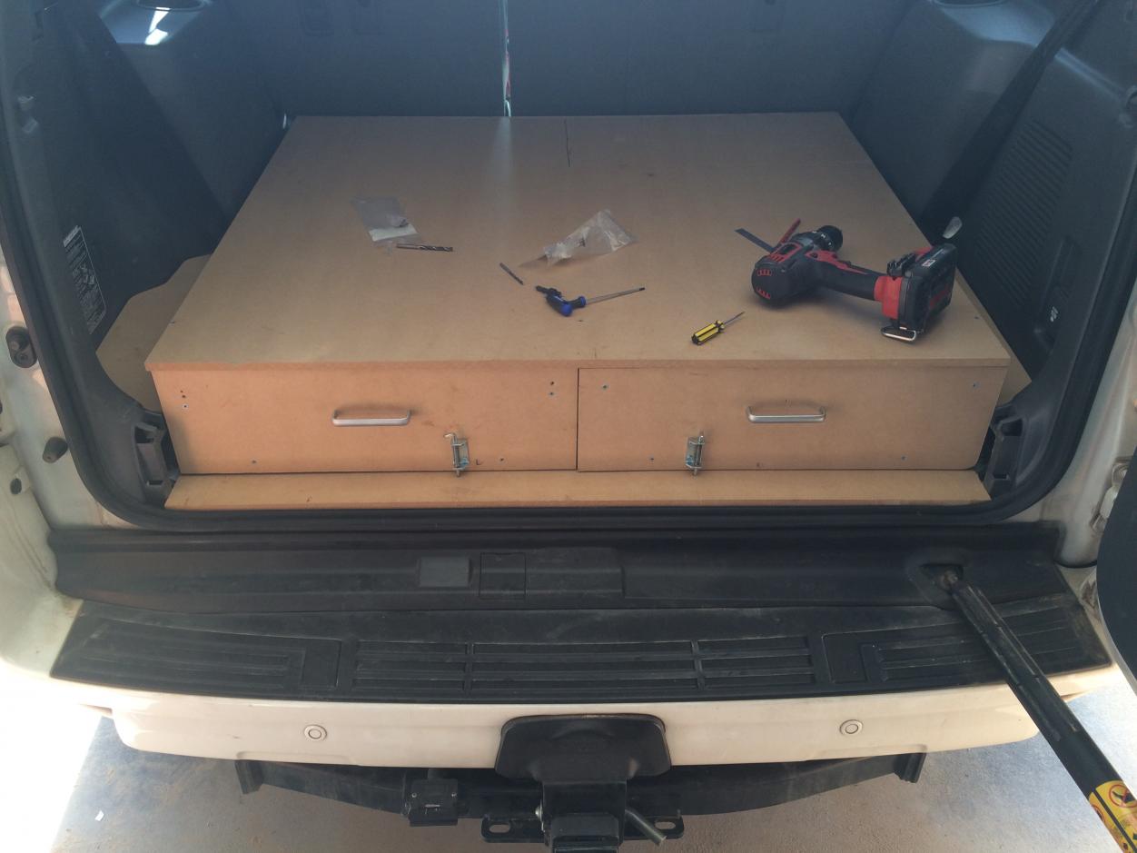

      • Nearly there.
        The left drawer doesn't slide as nicely as the right. I'll try and fix that tomorrow.

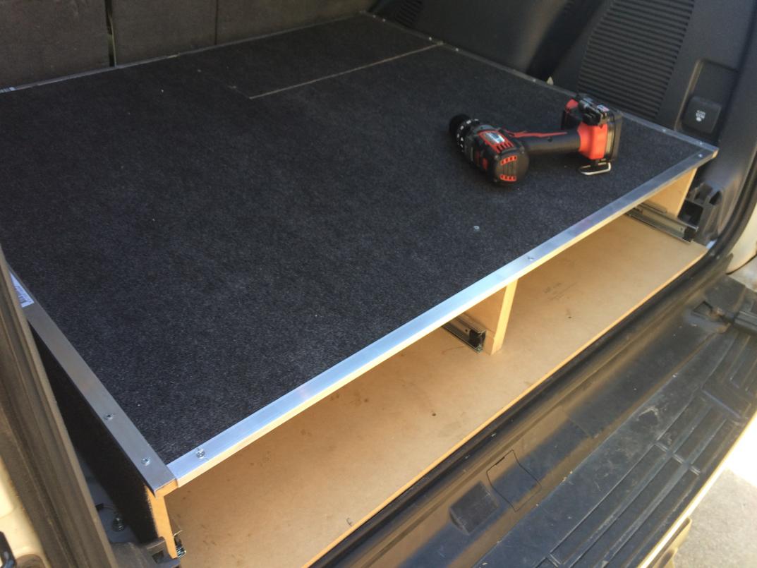

                • Just needs some carpeting now.

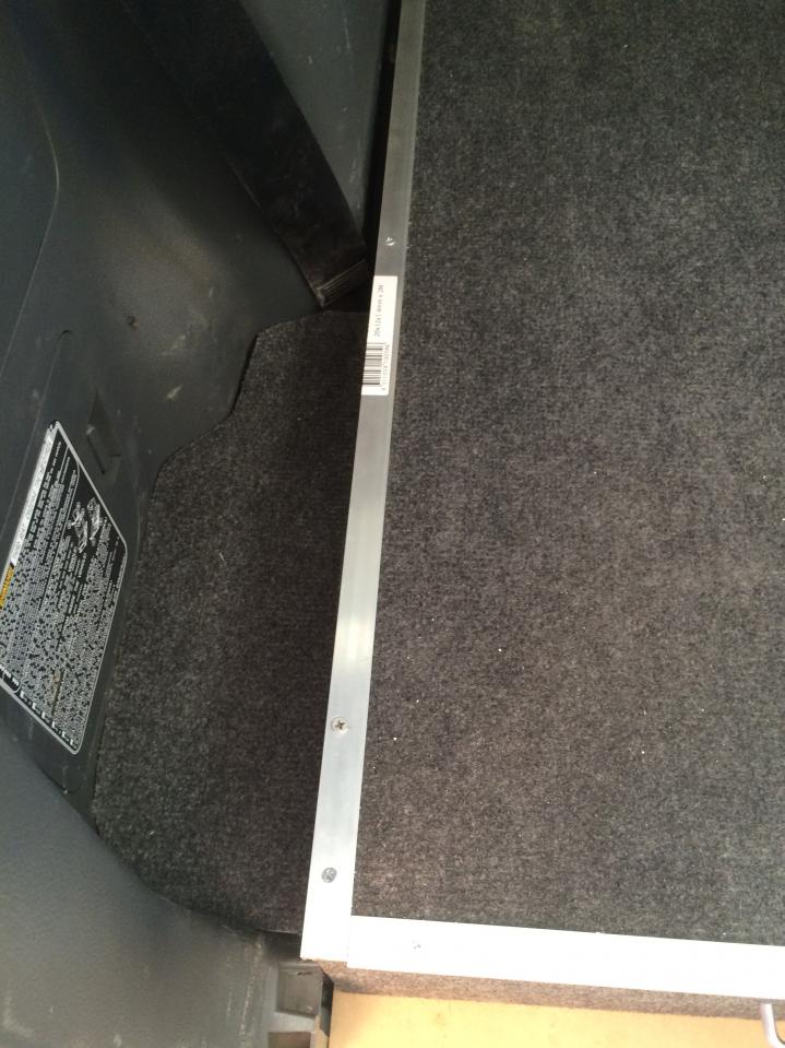

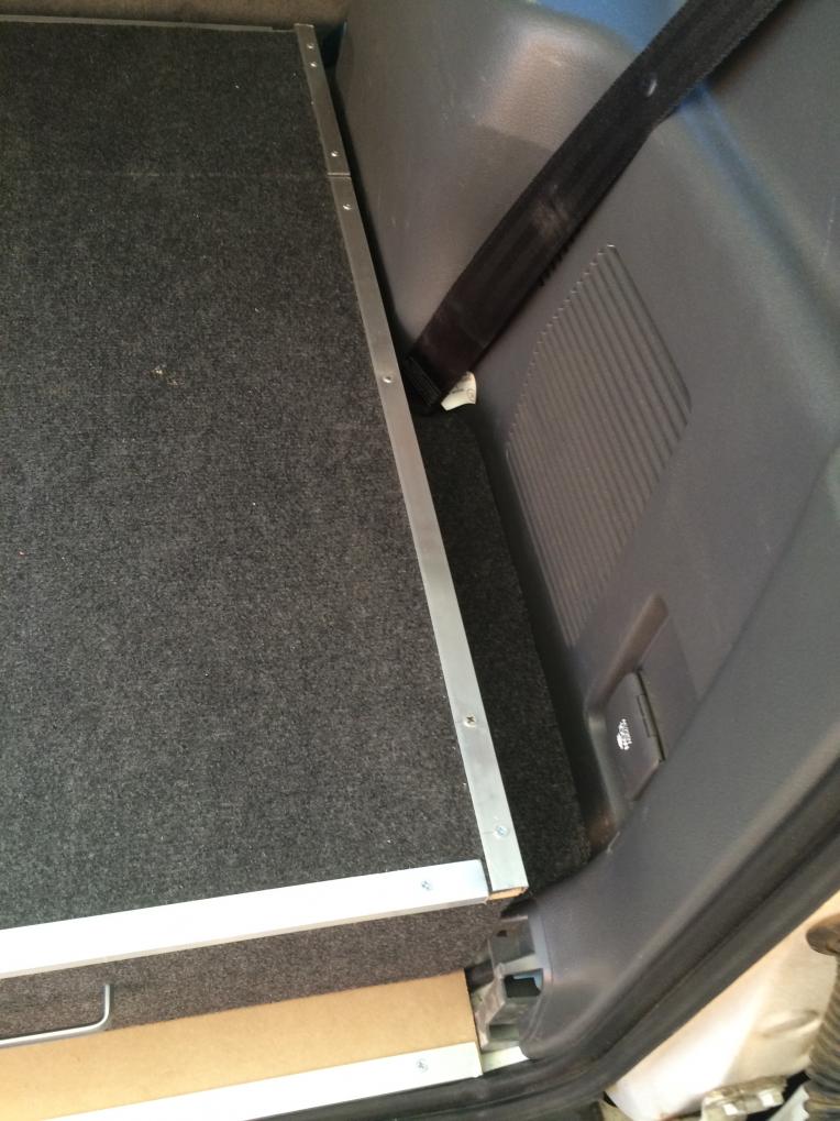

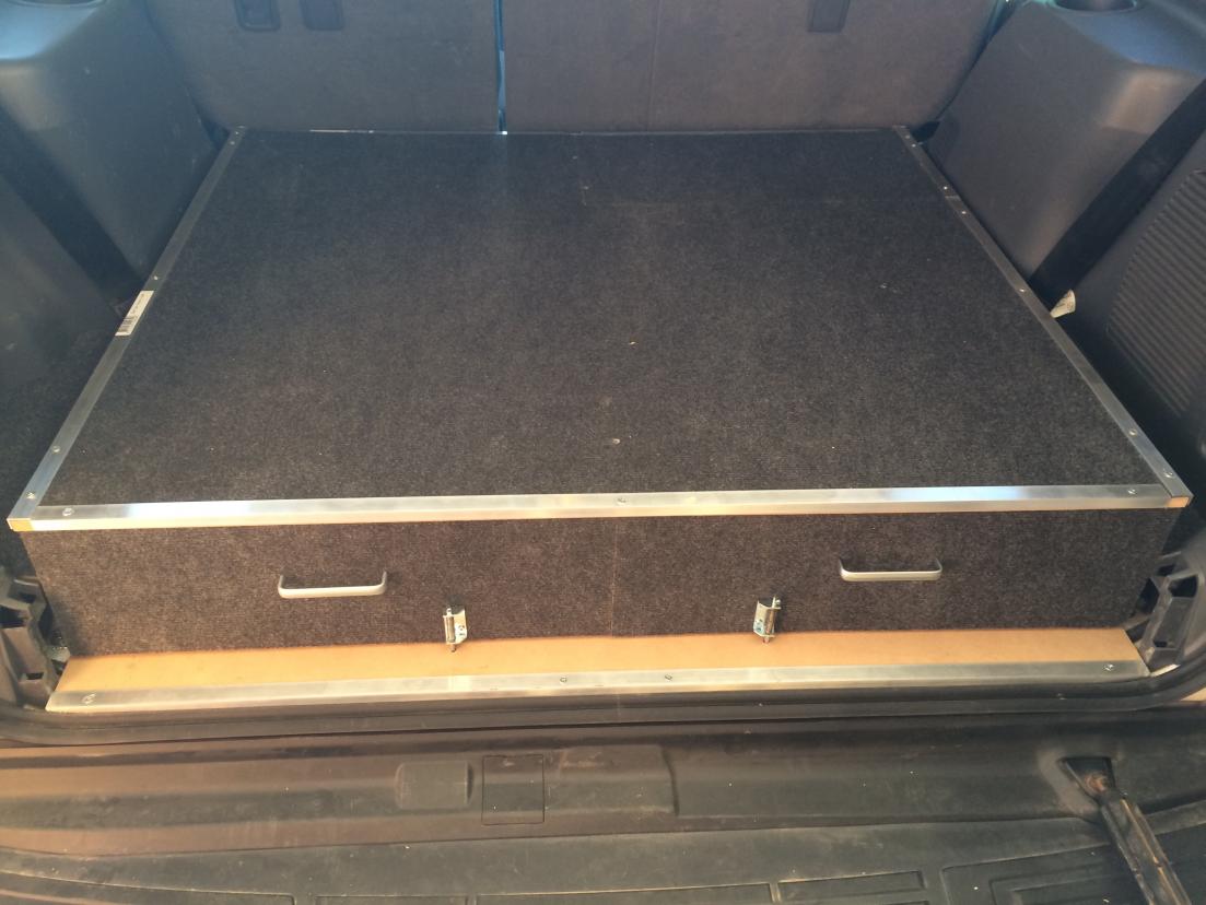

                  • I think they're done...
                    All carpeted and trimmed with 12x20x1.4 aluminium angle. Unfortunately I broke a drill bit and my countersink didn't perform at its peak so there may need to be some finishing of the aluminium yet.
                    I'll upload some more photos when I have access to my Laptop. (It's currently connected to the TV allowing us to watch stuff on Netflix)
                    Spilsy

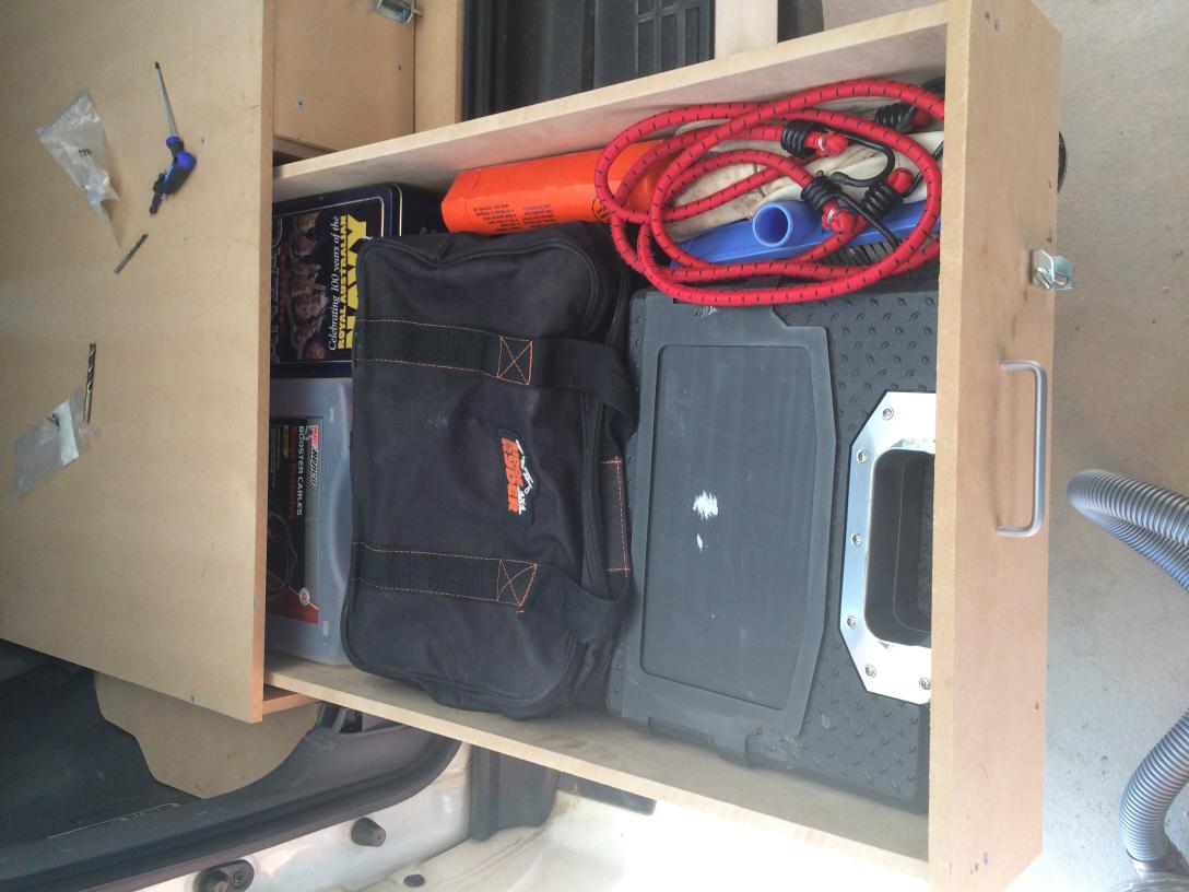

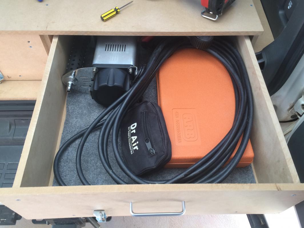

                    • Some More Photos:

                          • Cheers. I like the aluminium. Reminds me of mecano or Lego or something similar.
                            My 50L fridge sits nicely atop the new drawers. I made them low enough so the fridge could be in and open.

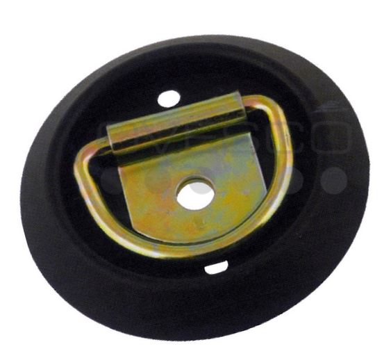

                            • Does anyone have any suggestions on tie down anchors for the fridge.
                              I don't really want to have to recess them into the top, but i want something that cargo can slide over when the fridge isn't in place.
                              Something like this, but not so big??? (these are 100mm in diameter, and I cant seem to find anything smaller):
Name:	100mm Tie Down.JPG
                              Spilsy

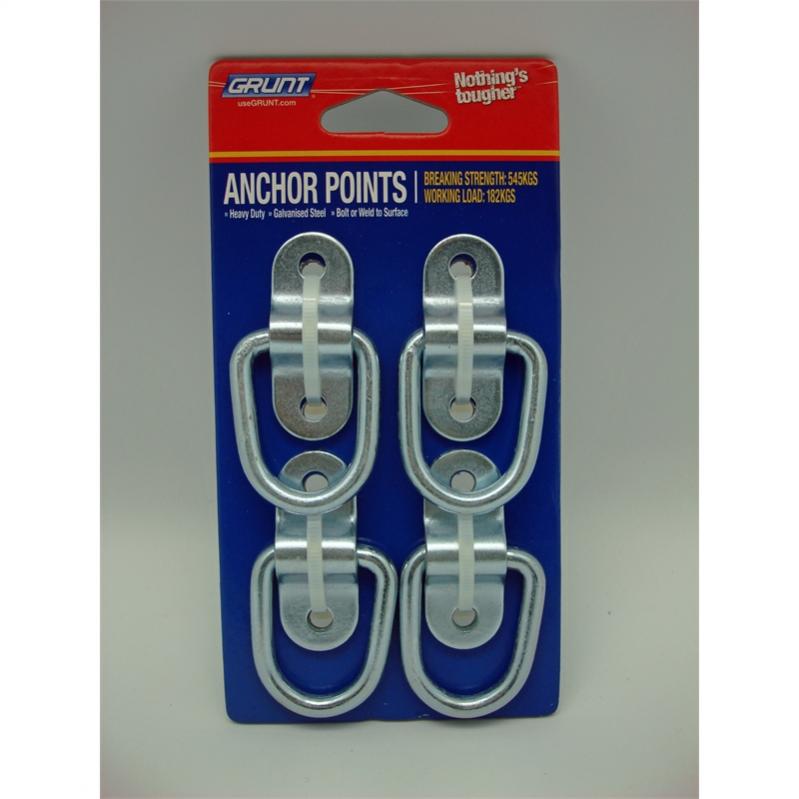

                              • Mate, we just grabbed some of these for my Brothers big fridge:
                                http://www.bunnings.com.au/grunt-182...pack-_p4310462
                                Micheal.
