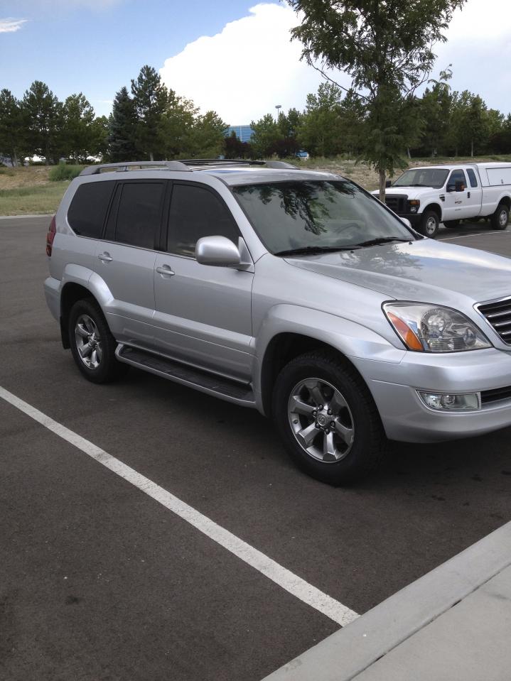

                          They are just the stock T4R limited wheels from a 2008. When I bought my GX, the wheels had a bunch of chips in them and it needed new tires so I scored the wheels on craigslist real cheap and put some more aggressive tires on it. Click image for larger version
                            Yeah, I like the stock GX wheels, too. The Sport package like mine (KDSS + dark wood trim inside and a few other small cosmetic items) and I believe 08-09 GXs have a darker finish that is nice.
                            And those 4Runner wheels look great. Are they 18s?
                            2005 Lexus GX 470 with KDSS (120 Series U.S. Spec)
                              Yea, they're 18's
