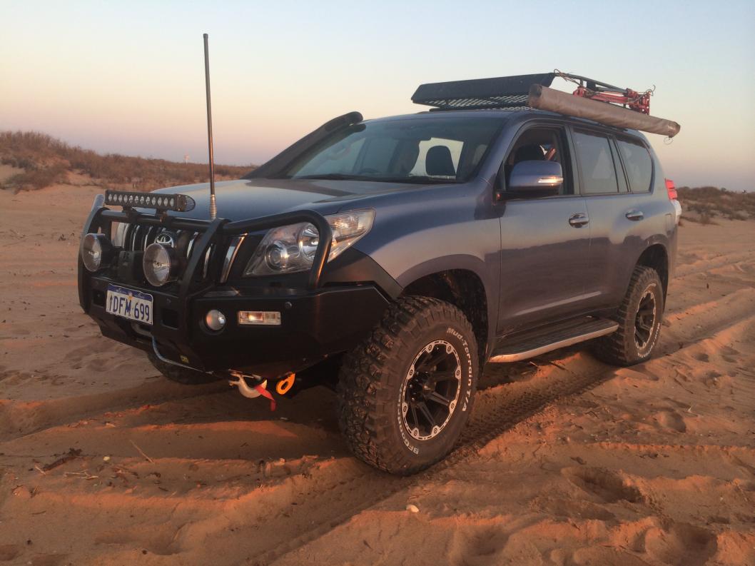

    Hi All,
    My 150 VX Prado, 152kw & 501nm torque
    Competed Mods
    Airtec snorkel
    2" lift, Bilstein shocks & King Springs
    DP Chip
    3" SS manta exhaust
    Dual battery with redarc management system
    Tyre Pressure monitoring system
    TJM T13 bull bar
    Tigers 11 12000pound winch
    Light force HID spot lights
    75w HID highbeam upgrade
    22" LED light bar
    OZ Trail awning
    Scan Gauge 2
    Road Safe Front end recovery tow points
    Diesel Care secondary fuel/ water separator
    B&M auto transmission oil cooler
    B&M high flow air filter
    Built and fitted cargo draw and fridge slide with a Evakool 47L travel mate fridge
    Diff, auto trans, transfer case, Fuel breather extentions
    DC Torque Rims 17x9 +6 ET
    BFG KM2 MUD 285/70/17
    Uniden UH8060NB radio
    Lazer Jammer
    Provent 200 catch can
    In the rear constant power to 2x Anderson plugs, 2x 12v sockets
    LED interior light upgrade
    Still on the wish list
    Front & rear lockers
    3" lift

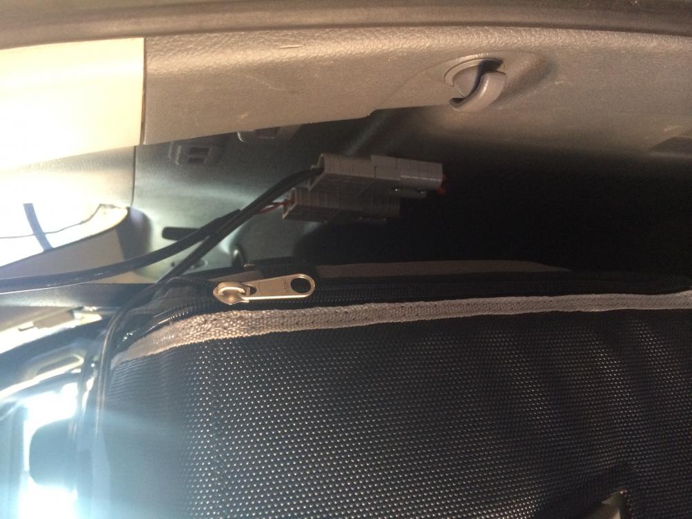

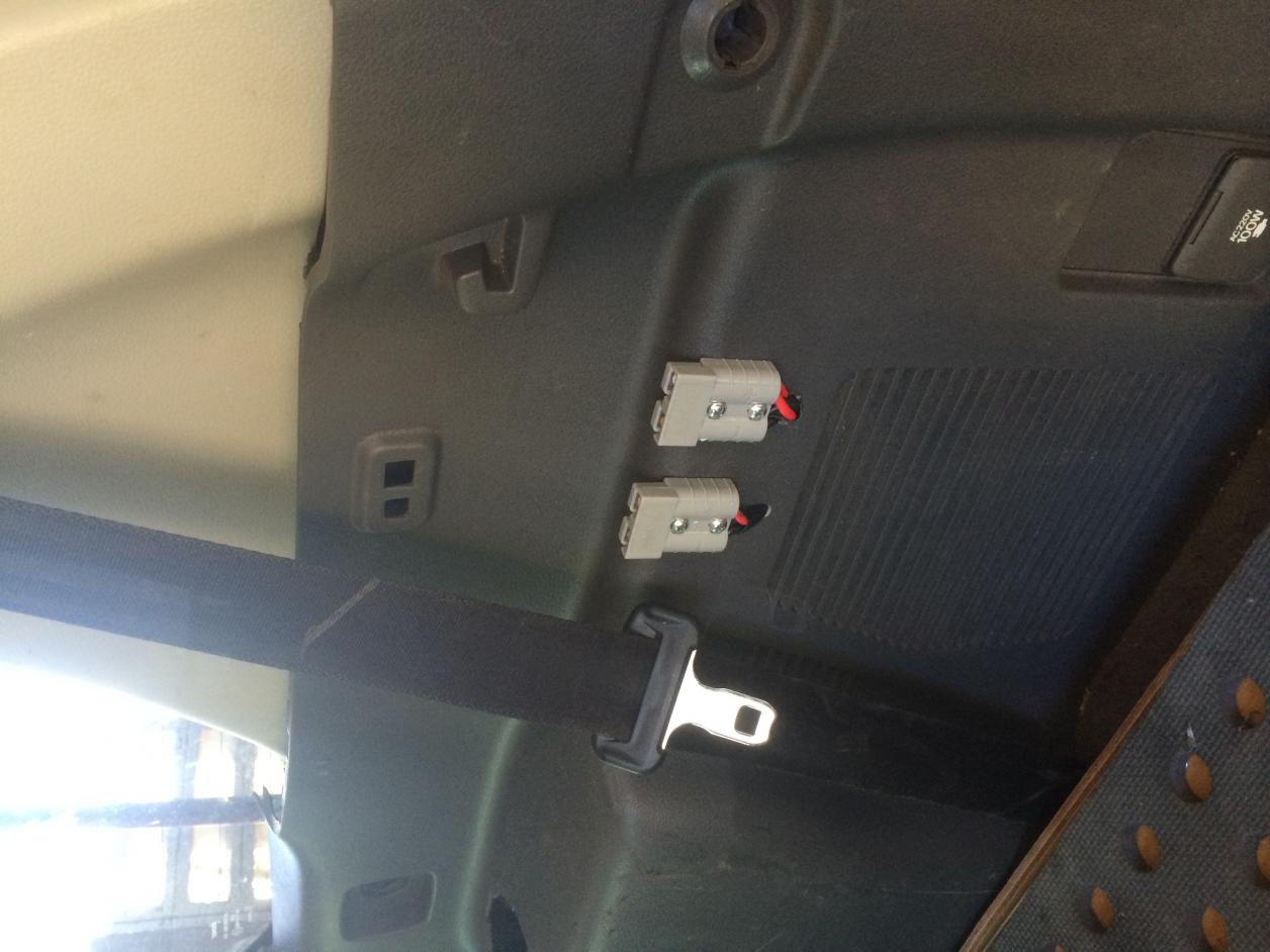

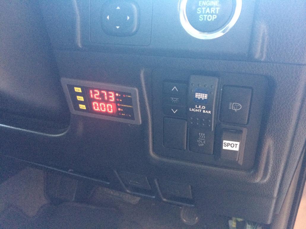

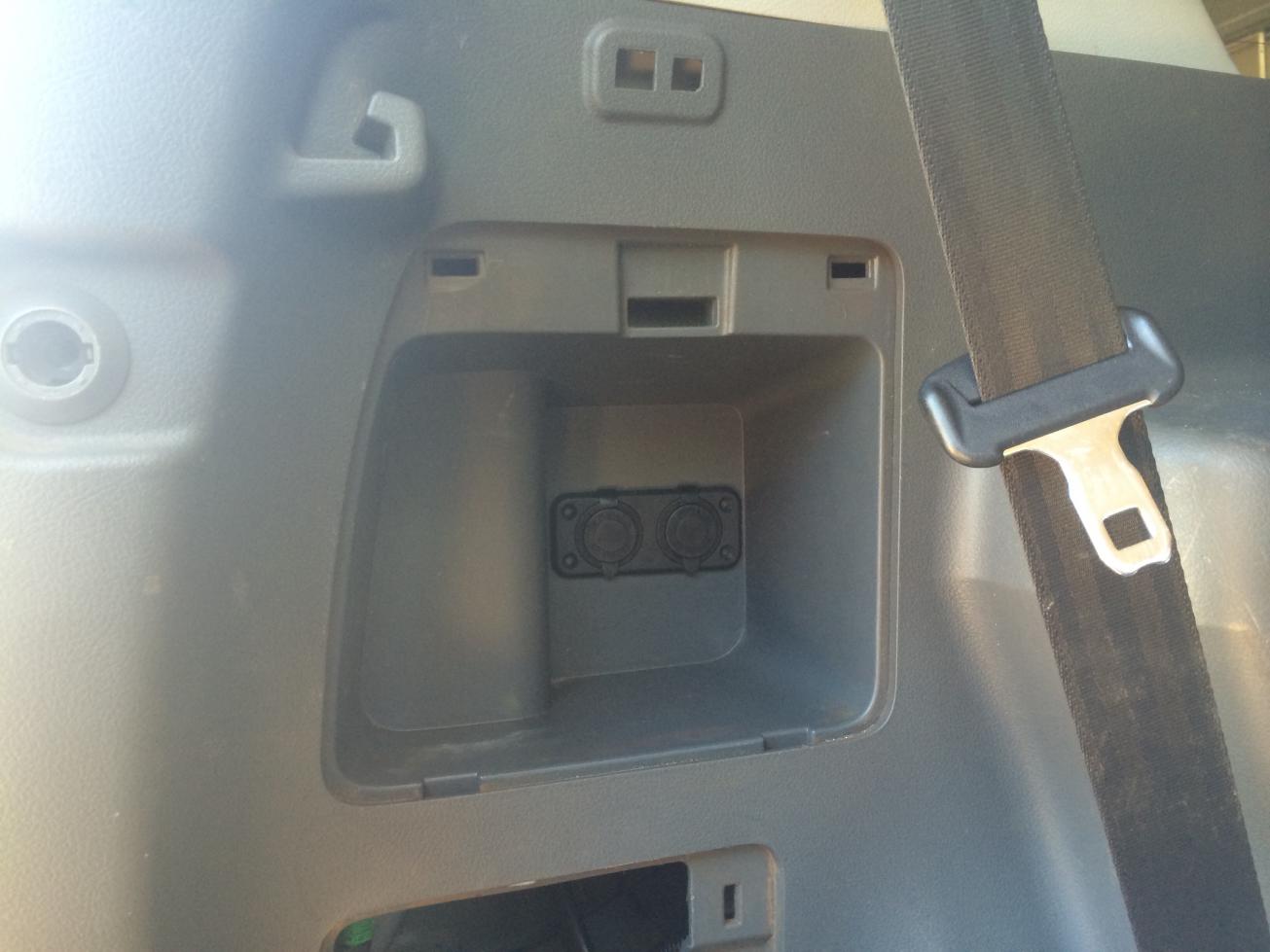

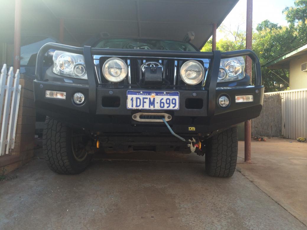

ID:	648530Today fitted a rear outlet off the auxiliary battery with an Anderson plug and volt/amp meter as well as a second Anderson plug/charge point for the solar panel

      Front recovery point fittedClick image for larger version

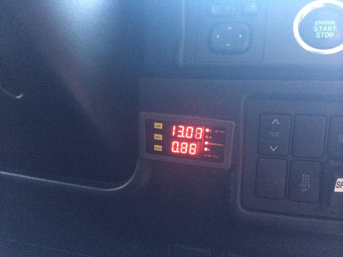

            Very nice Matt, great build. Look forward to seeing the progress! What make is the voltage meter? Did you notice a good difference after the chip and exhaust?
              Thanks mate, the meter is Elite DCM 1230c

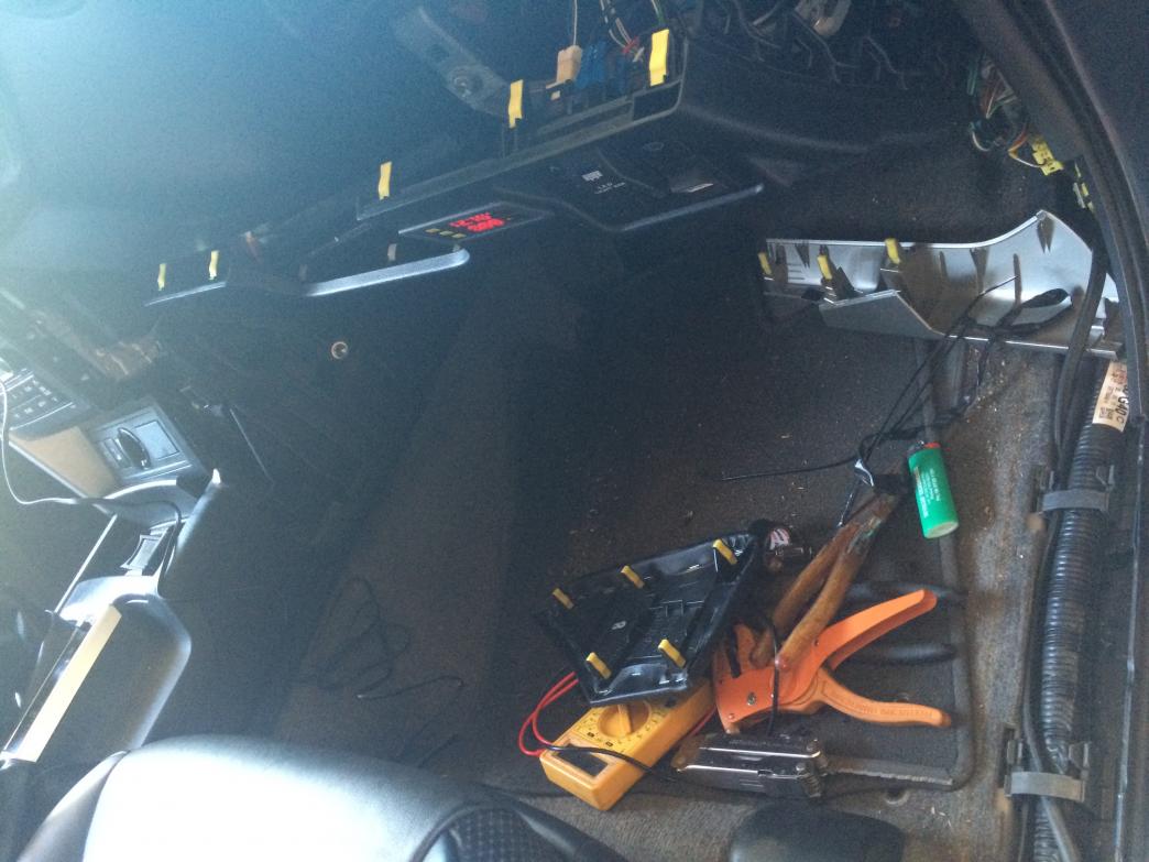

                          Today's additions
                          24" light bar fitted

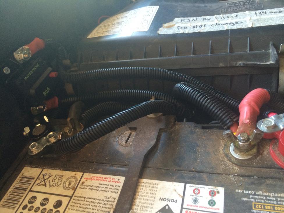

                          Hopefully get time tomorrow to fit my extra 12v plugs in the rear through 6B&S (13mm) wire which will be the new power supply for the air compressor as well as new inverter Click image for larger version

                            Today fitted a few extra plugs in the back 2x 40amp sockets and 80amp fuse able to run my compressor and inverter.

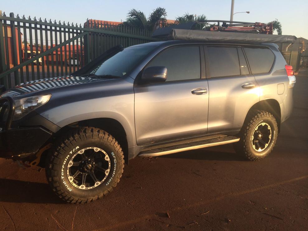

                              Latest mods are
                              DC torque rims and BFG mud terrain 285/70/17 Click image for larger version
ID:	649188Click image for larger version

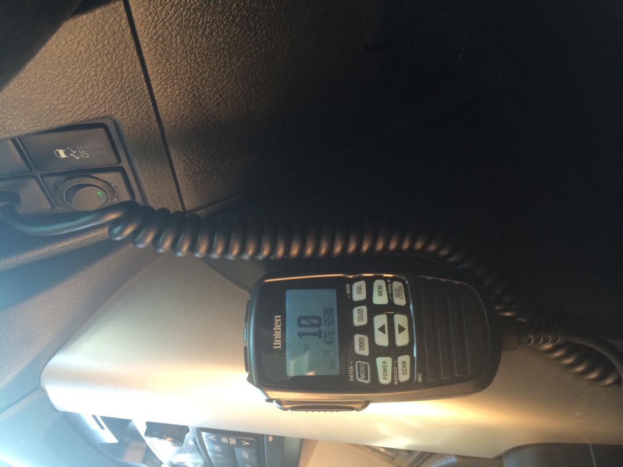

                              Fitted Uniden UHF radio Click image for larger version
