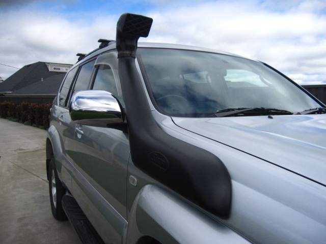

          Safari Snorkel
          Everyone has seen one before but who doesn't like pics.
Name:	Safari Snorkel.jpg
          Anyway decided to get ARB to install because after buying holesaw etc it wasn't worth me stuffing it up. $600 supplied and fitted.
          Been fitted for nearly 2 years. Less dust in filter but catches more bugs. Great quality product and wouldn't hesitate in recommending one to anyone else.

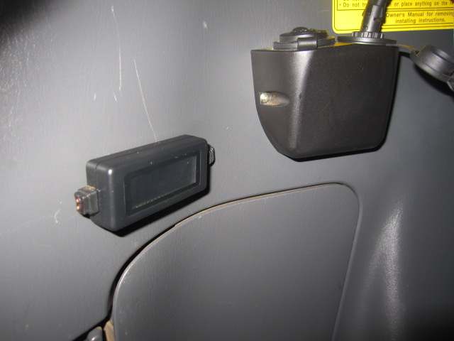

              Ran one line of 6 B&S to the rear to a fused distribution block in jack compartment. Running off that is Dual socket (one engel and one cig) for fridge duties, next to that is just a basic digital voltage display, LED light on rear door, and a dual socket behind the centre console for DVD players etc.
              Ran another line of 6 B&S in some corrugated conduit through chassis rail to rear Anderson plug for camper battery charging duties.
              Here are some pics:

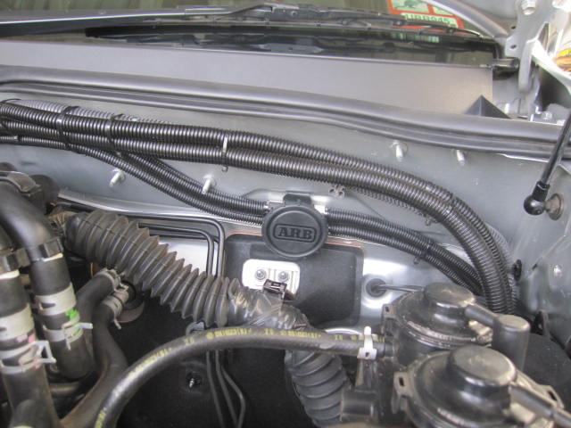

                      Decided to go with the ARB kit:
Name:	Prado Diff Breather 1.JPG
                      About $75. Also purchased the extra fittings kit (about $40 extra from memory). Didn't end up using the hose in the second kit but used all the push on fittings out of it though.
Name:	Prado Diff Breather 2.JPG

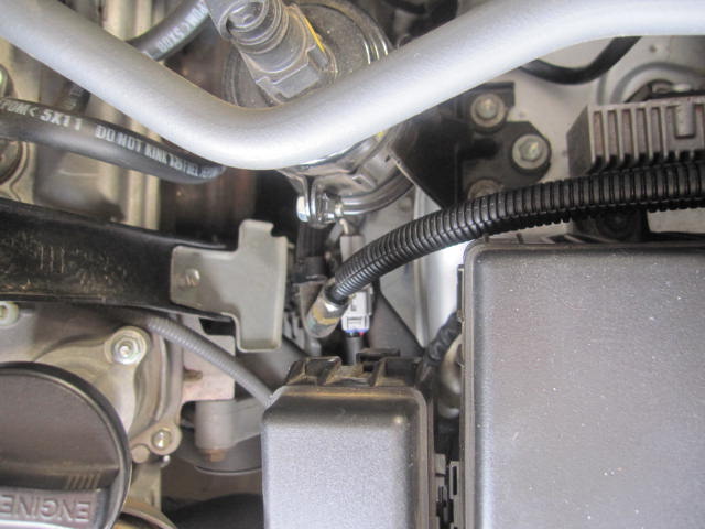

                      Rear diff was pretty easy to undo and and the new push on fitting from the ARB kit screwed straight in no problems.
                      The front diff breather is in a good spot already. This is located next to the fuse box under the bonnet.
                      Ended taking the whole tube that connects to the transmission breather off.
                      The transfer case has a enough slack to be easy accessed from underneath the vehicle.
                      Once I had all the three old breathers off (minus rear) I went to enzed and got the barbs that would accept the ARB push on fittings and fit into the original hose (using the old breathers barbs as a guide for sizing).

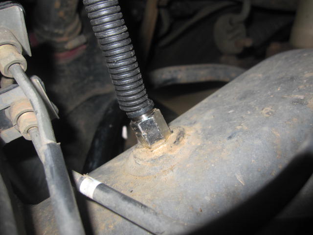

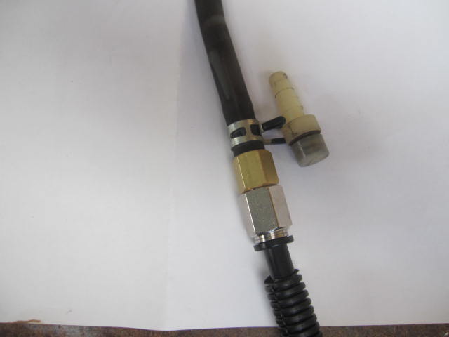

                      For the transfer breather the barb is only a 1/8 inch barb so had to get a connector to match with the ARB push on fitting.
Name:	Prado Diff Breather 5.JPG
                      Once I had those parts organised I then got some split tubing and placed the breather line in that for some extra protection. For the rear diff I ran it through chassis rail and other than that, albeit a bit fiddly the rest was fairly straight forward.
