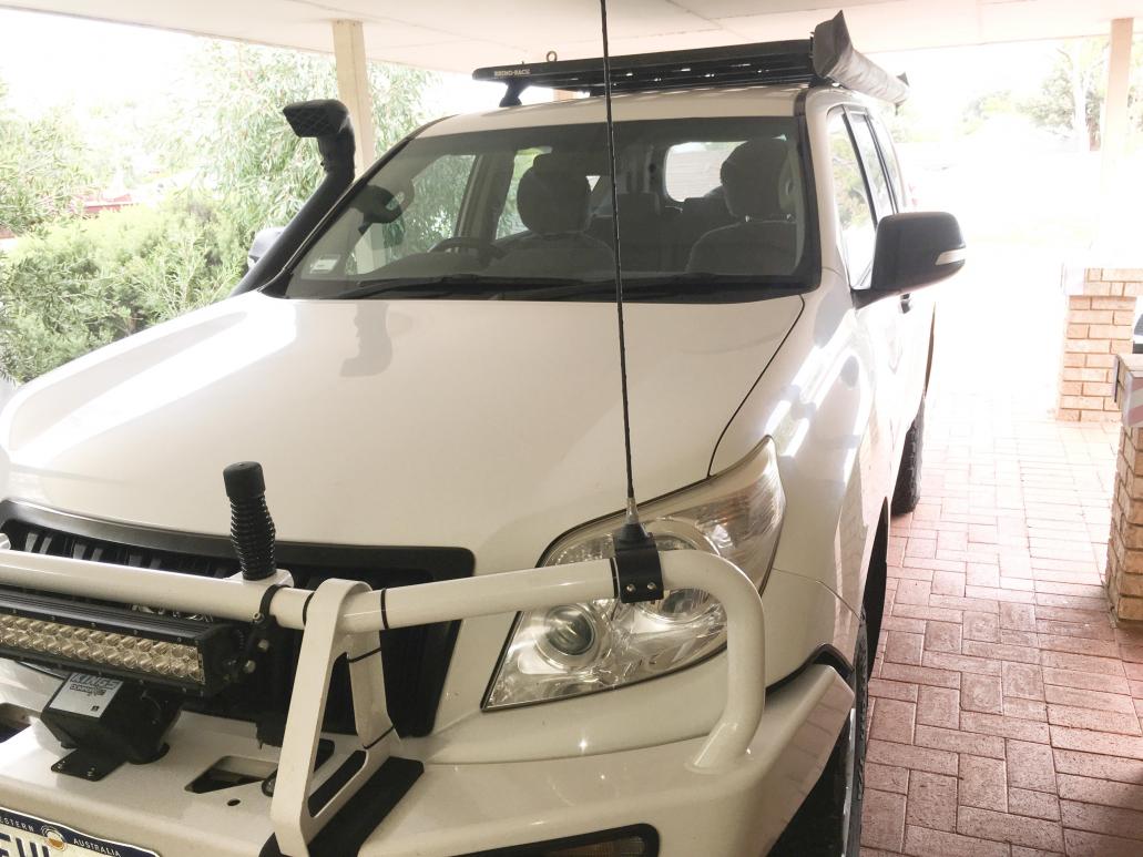

                          So since my last post I've added an AM/FM antenna to the bull bar to improve reception when away from towns and a new UHF antenna, now also on the bar.
                          Click image for larger version  Name:	 Views:	1 Size:	102.8 KB ID:	737184

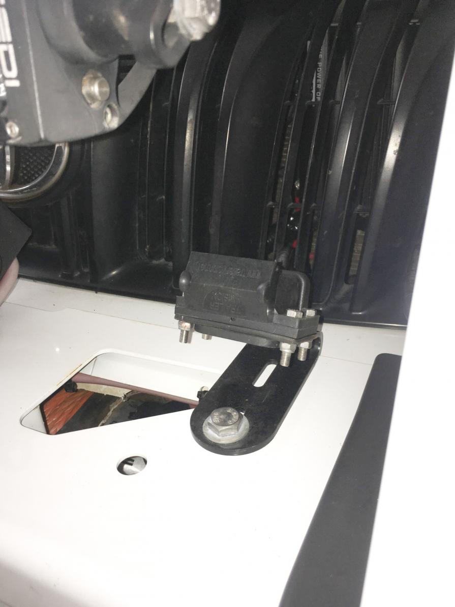

                          An Anderson 50 amp plug in a trailer vision cover, also on the bull bar for plugging in my folding solar panel.
                          Click image for larger version  Name:	 Views:	1 Size:	75.2 KB ID:	737180

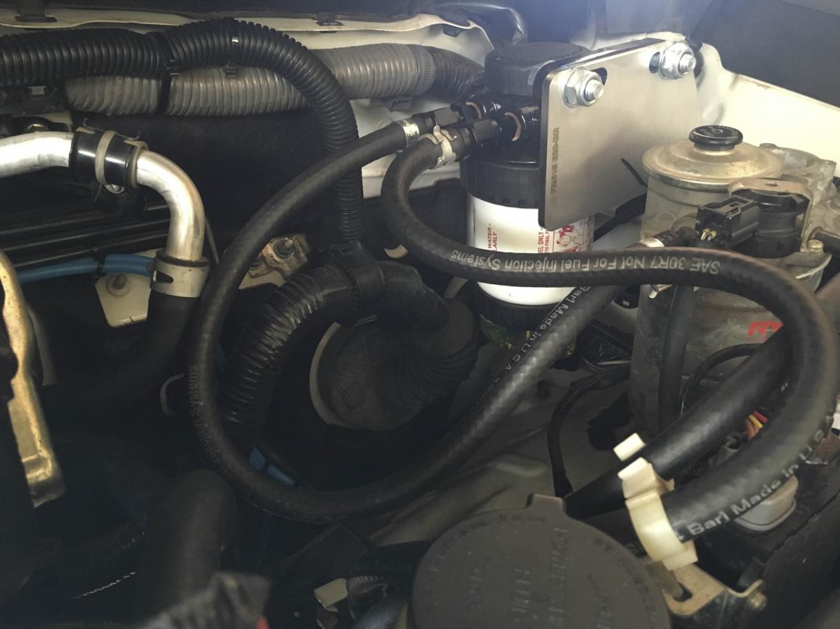

                          A diesel pre-filter with water trap.
                          Click image for larger version  Name:	 Views:	1 Size:	97.4 KB ID:	737183

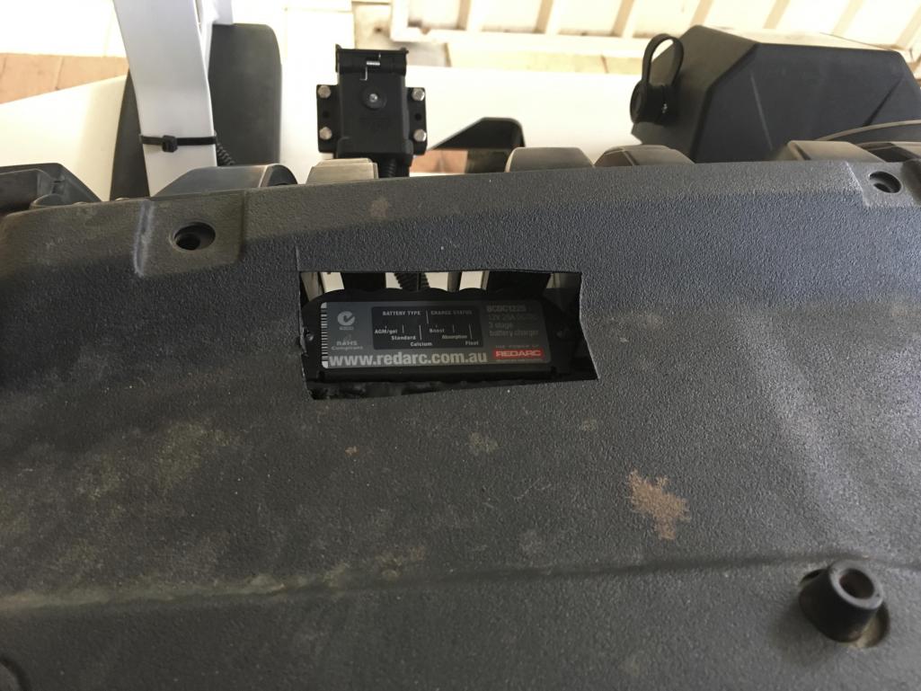

                          Moved the Redarc BCDC charger to just behind the grill so it stays cooler.
                          Click image for larger version  Name:	 Views:	1 Size:	98.9 KB ID:	737181

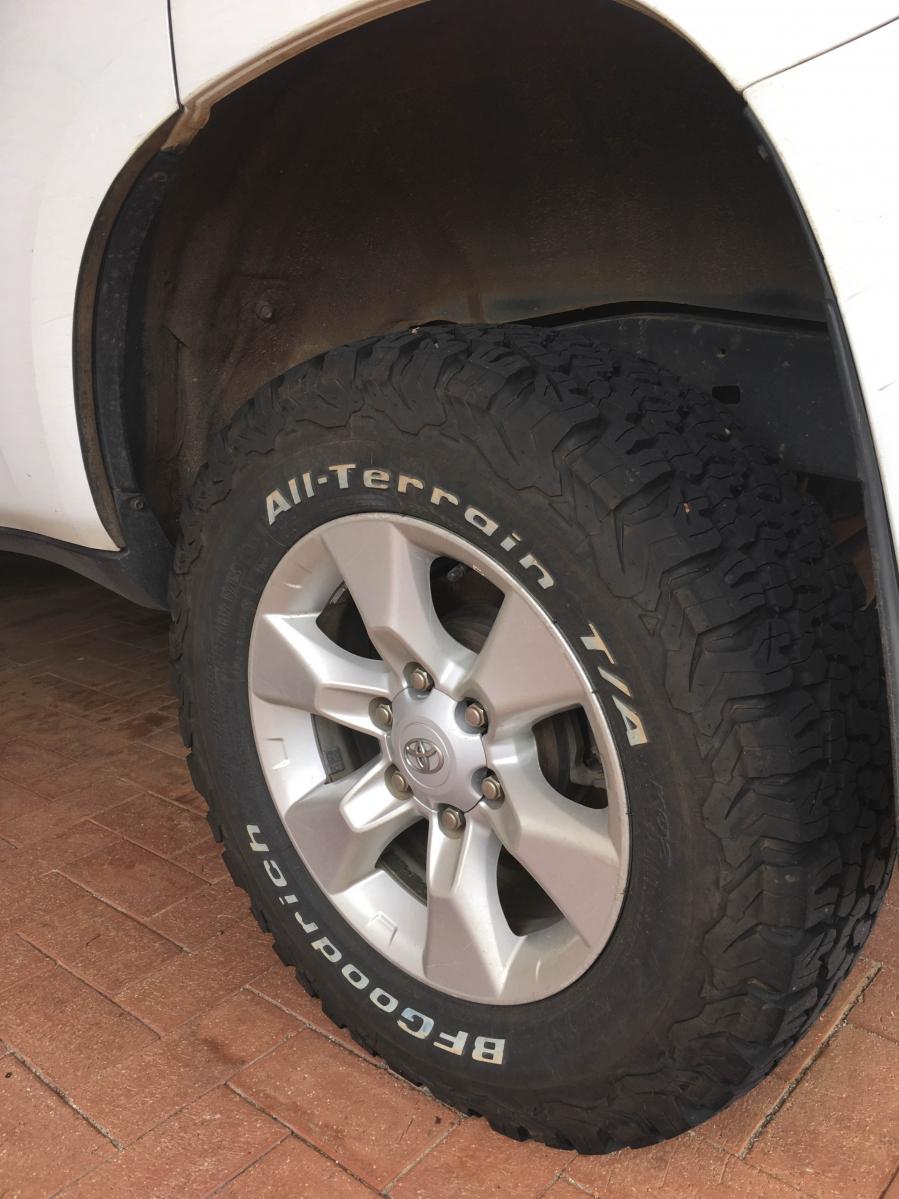

                          Re shod it with BFG KO2's in 245/70/17

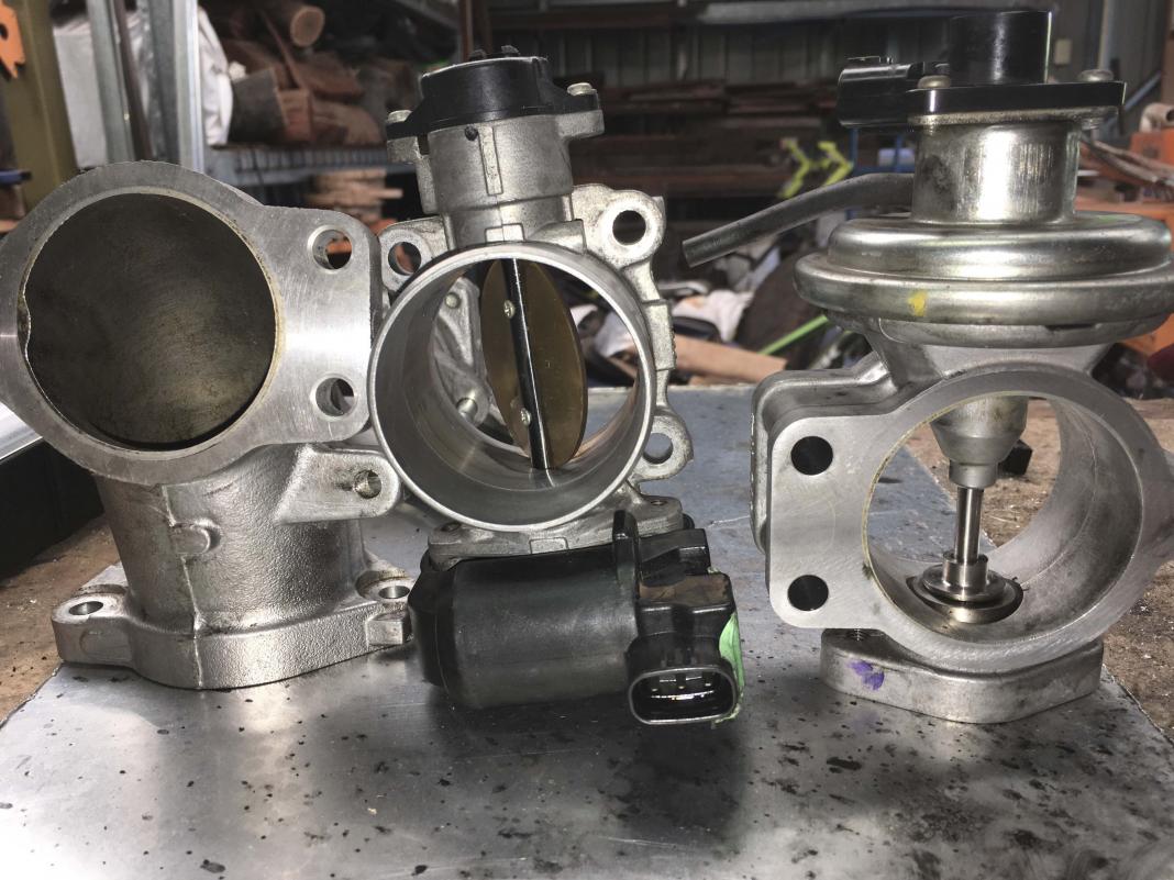

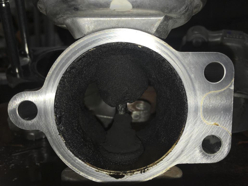

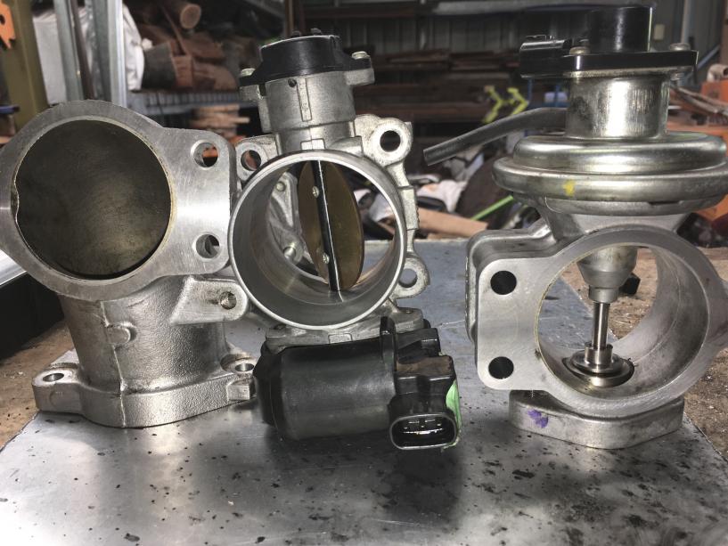

                            Also, yesterday I pulled apart the EGR valve and gave it a clean, not a job I want to have to again in a hurry!. The blanking plate with a 7mm hole arrived today, so will install that next weekend and then I plan on having the ECU remapped
                            Click image for larger version  Name:	IMG_1990-0.jpg Views:	1 Size:	79.4 KB ID:	737189 Click image for larger version
