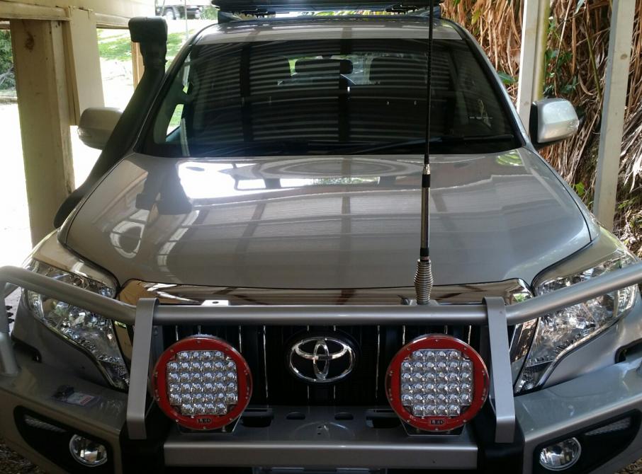

      Spotties
      New spotties done! Not sure what to do next... Save some cash until I think of something else I guess.

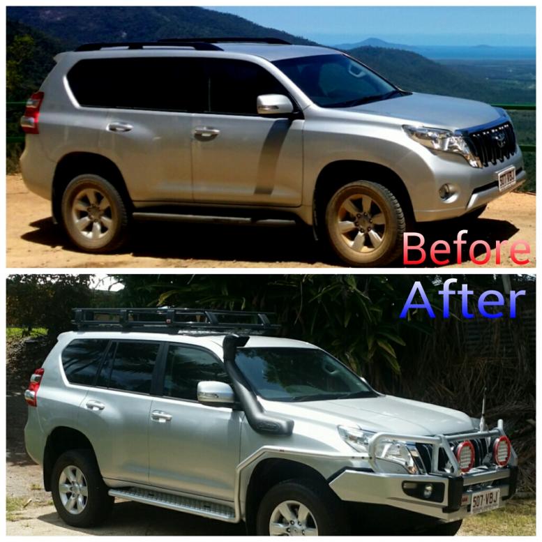

        Before and after photo.
        Thought I might add a before and after shot of the ride so far.... From buying new I have added ARB deluxe bar, rails and steps, ARB aluminium roofrack, Safari snorkel, GME radio, Redarc Dual battery, OME 2inch suspension lift and LED spotlights. **FYI this is a brag post but I can't help it because I'm stoked to finally have my Prado!!

          How are the spotties? If they are any good, where did you get them from?

            Yeah spotties are fantastic! Just looked up LED spotlights on EBAY and found this set. They did Cost $495 though. ..

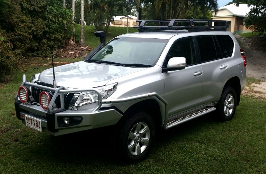

              Wash and polish
              Just gave the Prado a wash and a quick lick of polish! Nice and shiny now!!
              • #37
                Very shiny, nice

                  Looks awesome Ben. Will definitely get the same spotties on mine.

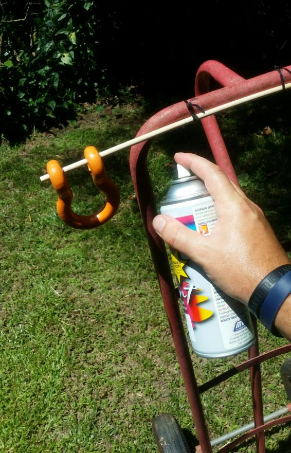

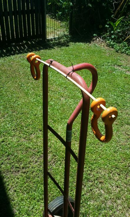

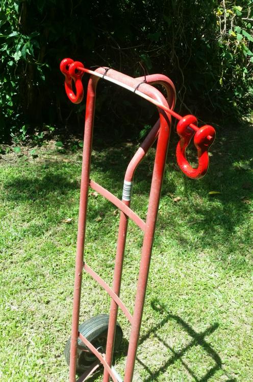

                    New recovery shackles
                    Bought some new recovery shackles today but I didn't like the colour. So I quickly knocked up a paint stand and painted them. I will add another photo when they dry!

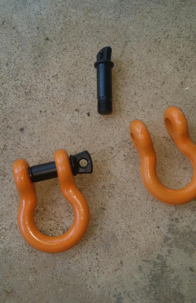

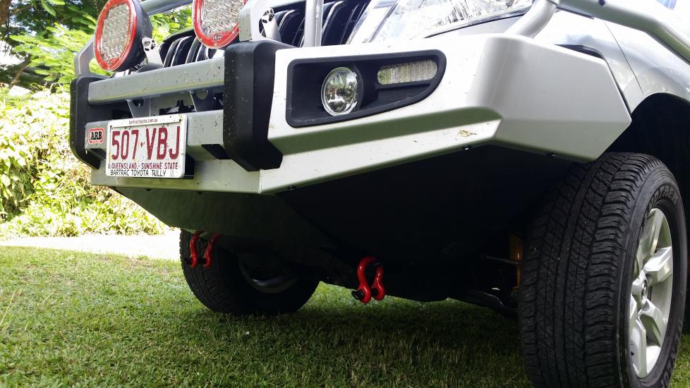

                      Mounted
                      So this is the mounting point for my shackles.
                      • #41
                        Don't know if I'm telling you something you already know but you will want to spin them around when you use them so the pin is resting on your recovery loops and the snatch or equaliser strap can choose its own angle on the bow side of shackle. I would also recommend only wearing them when needed for recovery. I put mine on to try and save time if I needed them running the gauntlet to the barge at Fraser and did them up finger tight. I forgot to take them off till about 5 km down the corrugated inland road and only had 1 left. I should have done them tighter . However when using for recovery do them up finger tight then back them off 1/2 a turn to mark sure they don't bind up or you might not get them undone. But hey you have a prado , you may only need them to recover Nissans.

                          Mate they are identical to the ARB Intensity lights and ARB sting you $1800 - $2000 fitted.

                            Yeah Matt I only put them on for the photo. But your right, they will probably only be used to recover Nissans...
                            Nanbar, the ARB intensity ones are ridiculously overpriced. As you can see they are identical minus the ARB logo. They work fantasticly well too!!

                                Hi,
                                Are they identical as in same manufacturer, materials, mounting brackets, LED's and the "only" difference is the ARB badge or do they just look the same?
