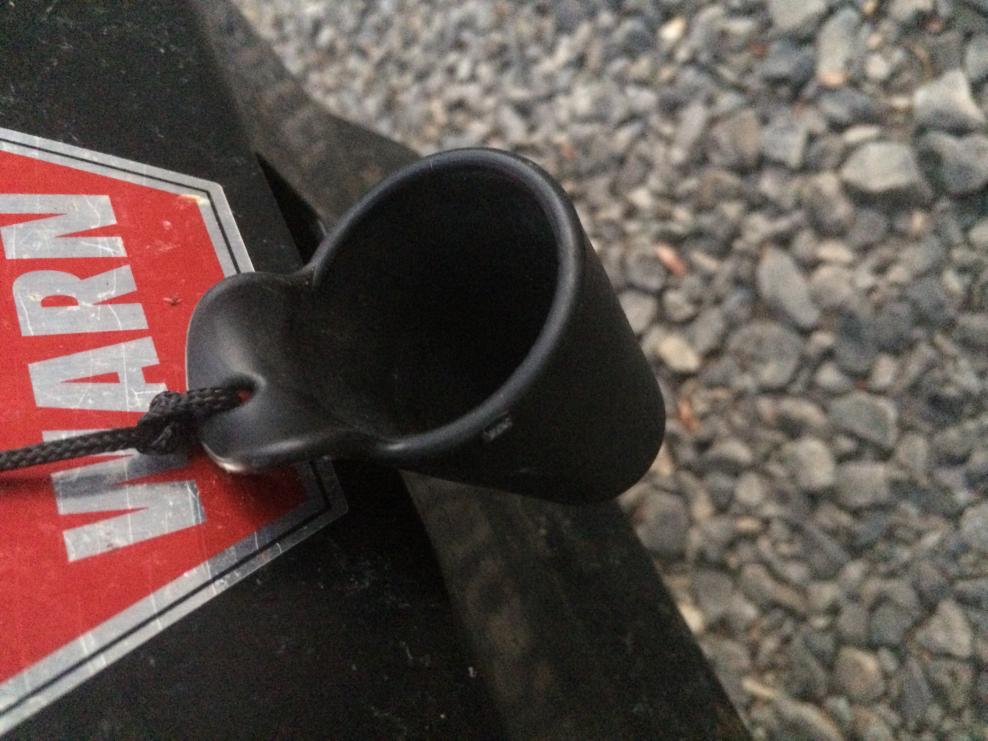

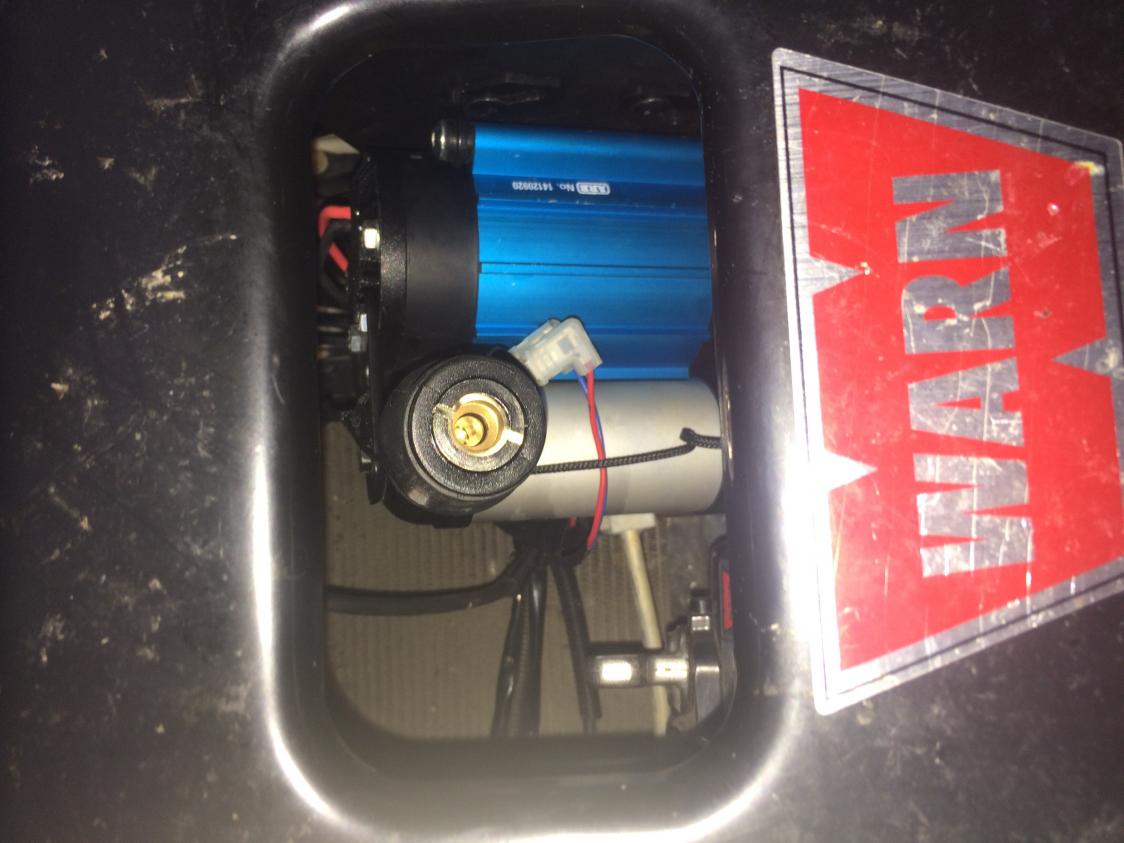

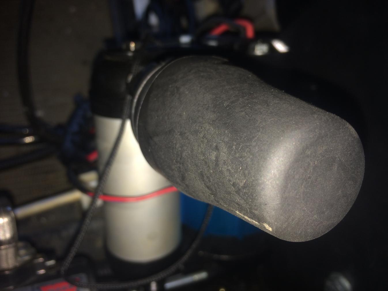

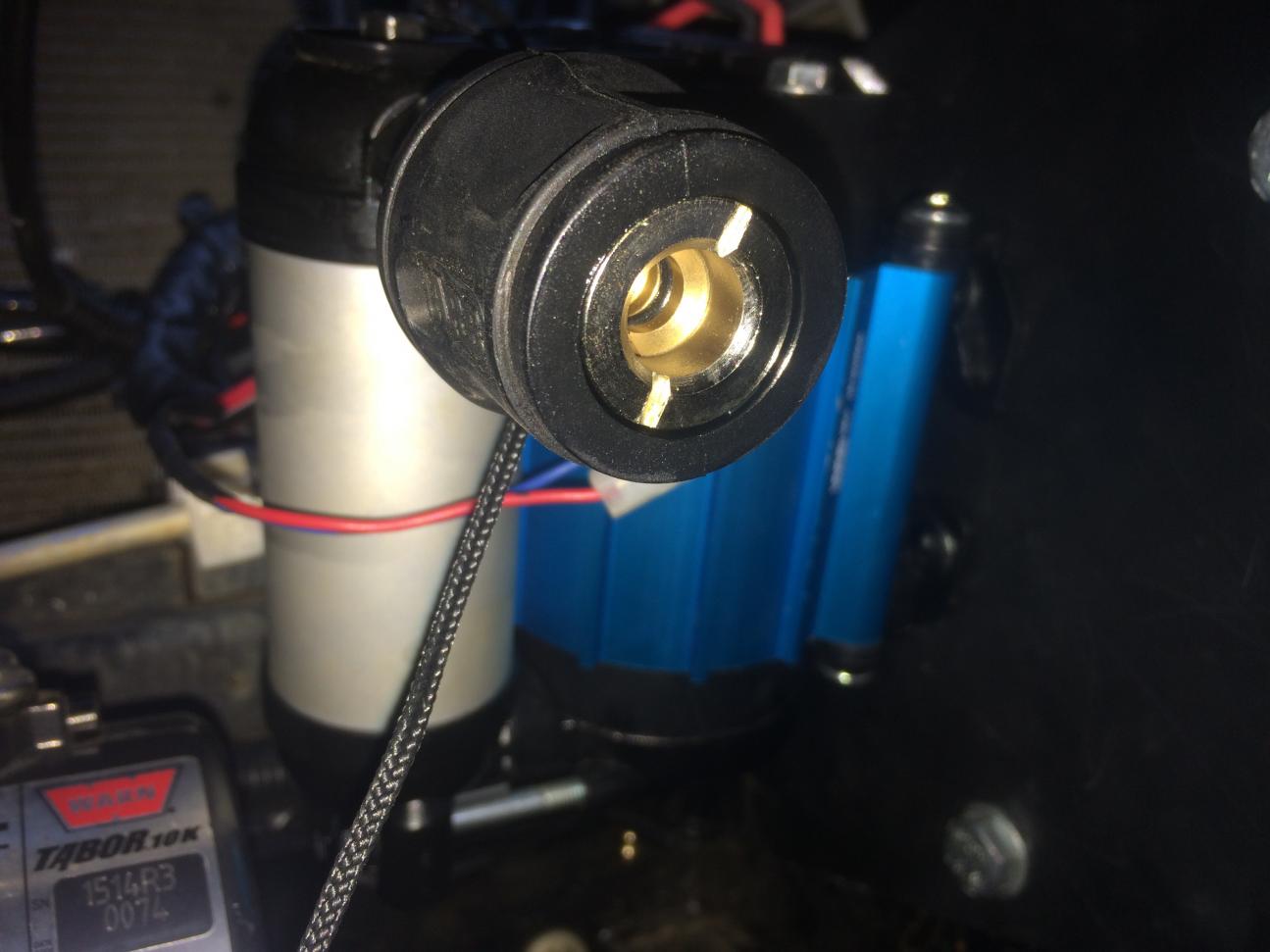

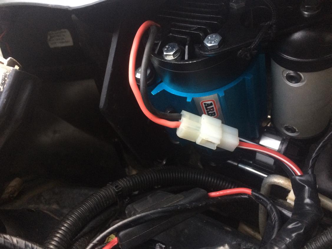

      Well I installed my ARB on board air compressor today, was going to mount it under bonnet but wanted to keep that spot free incase I need an extra battery. So I made up a plate out of 6mm steel and drilled three holes in it to line up with three existing bolts that held the winch cradle to the bullbar and four smaller holes which I copied off the mounting plate that is supplied with the air compressor for the bolts for the air compressor and installed it in my bullbar beside my winch. Come up a treat just need to extend the air intake up into the engine bay (I will do that when I do my diff breathers) Been stumped on finding a dust cover to fit the air outlet as its 35mm and tapers out to 45mm but ended up finding a scupper plug off my old Hobie Kayak which fitted perfect. It's easy to access and I don't have to pop the bonnet to plug the air hose into it as it can be done via the access hole to the winch.

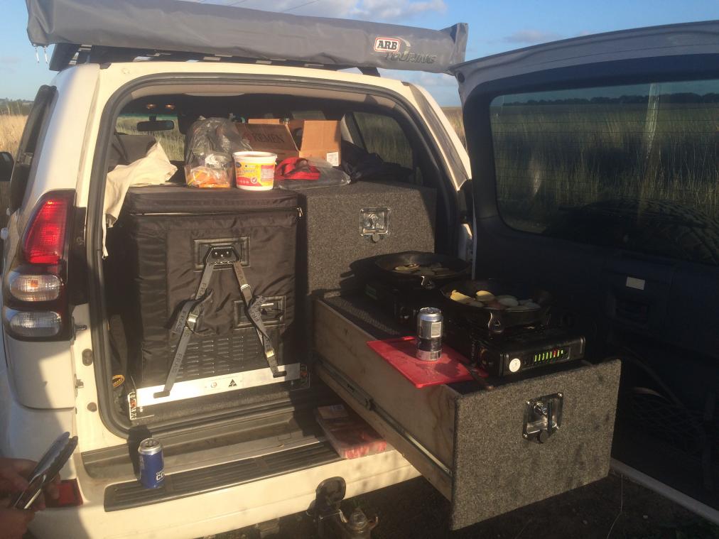

        Well been busy over the last couple of weeks fitted the snorkel, installed one of my recovery points will do the other soon put the fridge slide and fridge in and fitted up the rear awning. Also made my rear drawers as well was going to make a rear door table but ended up carpeting a bit of ply that sits in the top of the bottom drawer works a treat and all ready for this week end.
