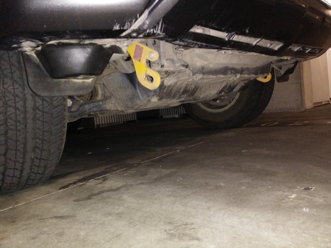

    So I started with the basics. I've installed the recovery points and have had a 3t tow bar installed.
    Recovery Points:

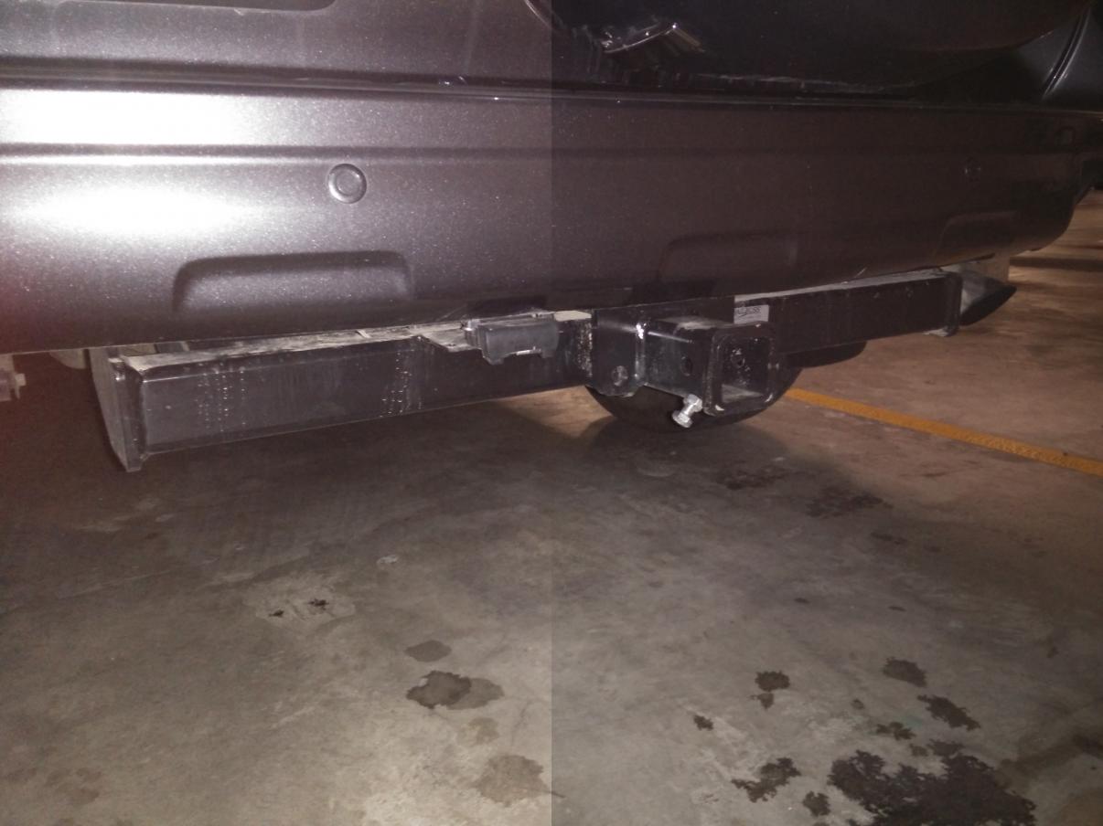

    Tow Bar:
    The Tow bar that was installed was TrailBoss brand - comes out of the same factory in victoria as the hayman reece bars, has the same inserts and the only difference that I can tell being that the electric plug female unit is made of plastic. I only plan to have the bar for recovery purposes, I haven't towed anything in the 14 years I've been driving but the option is there now.

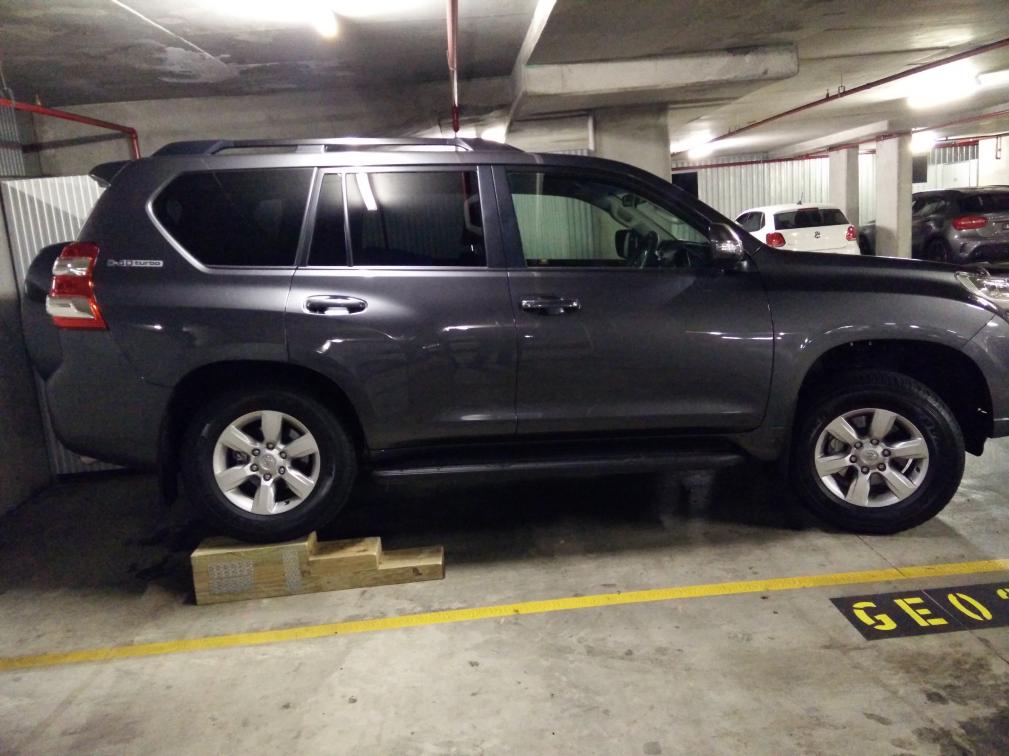

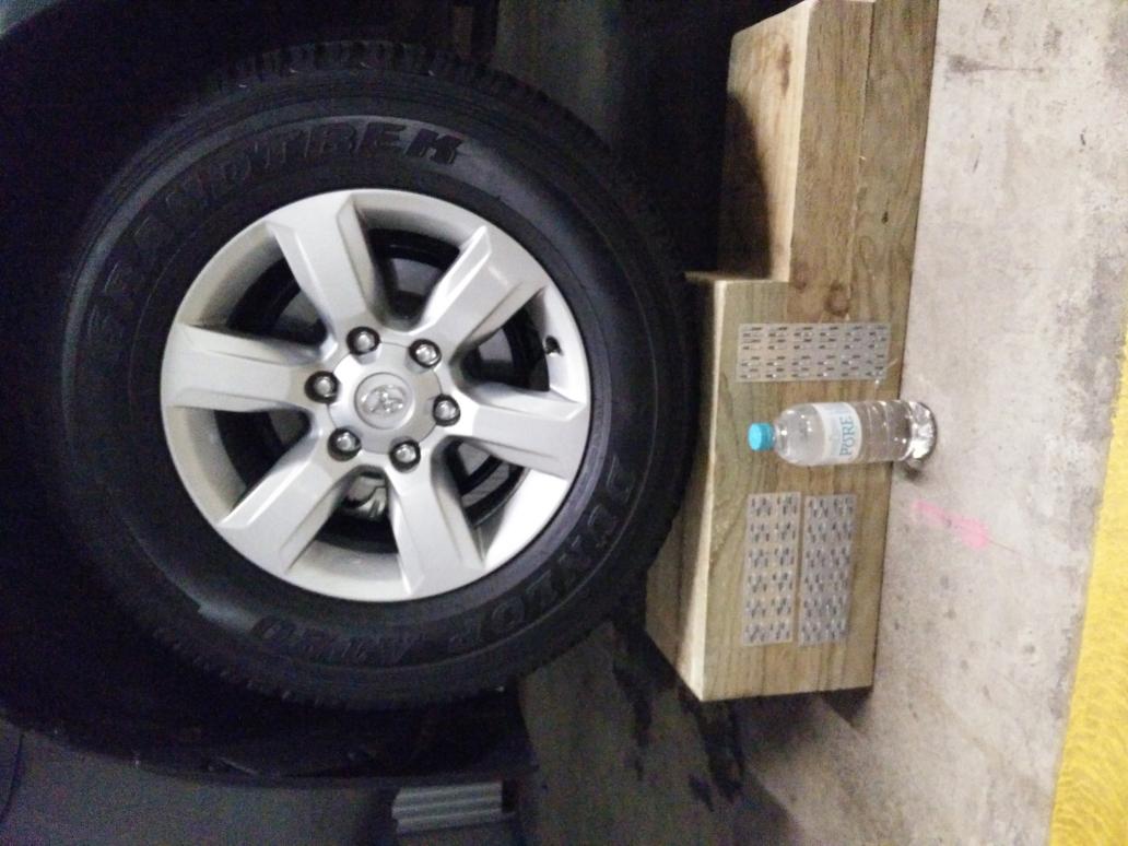

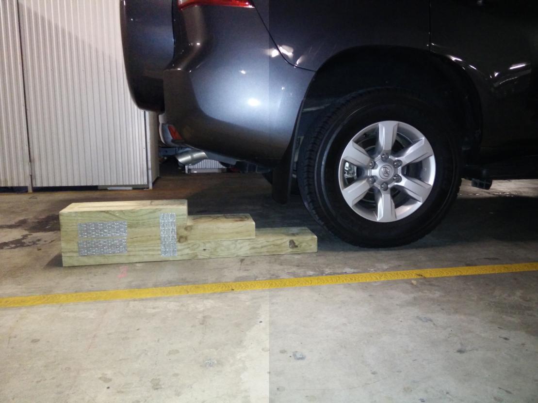

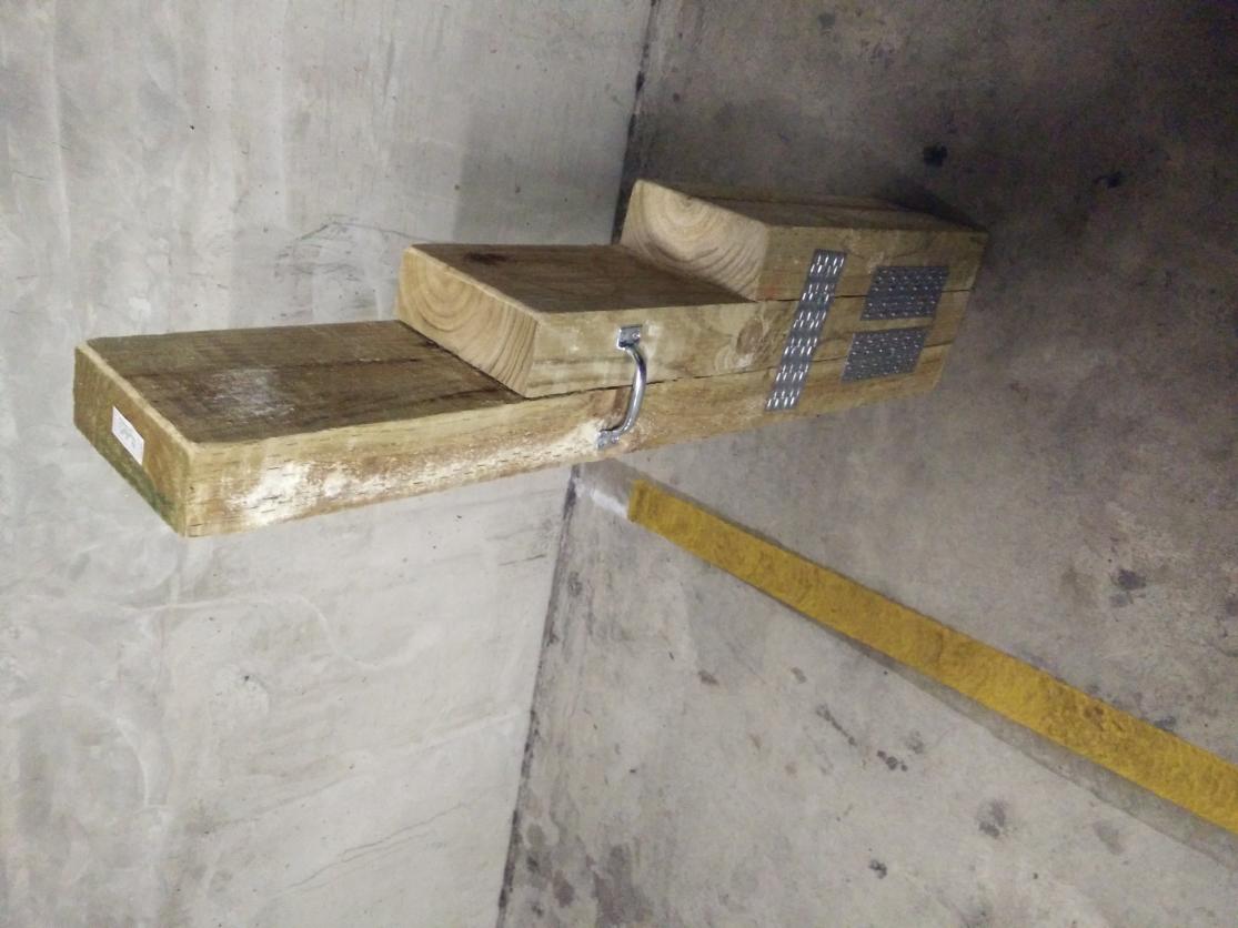

      Ramps on the cheap:
      Next I needed to create some ramps. I did a ring around and found that there really was nowhere that did ramps that could take more than 1.1t each. Ramps are usually steel welded frames or plastic moulded ramps, they're rated between 800kg and 1100kg. I don't particularly want to buy ramps for only 1.1tonnes per corner (a good mate at work's dad died about a year back when his project car fell on him, no it wasn't on ramps but being crushed by a car is something I don't want to deal with), so I decided to build some solid ones of my own, off to bunnings I went.
      Materials:
      2x 2400x200x75 sleepers cut into 1100x800x500mm lengths by bunnings (@50c / cut) roughly $35 for two ramps
      12x nailplates (6 per ramp) $12
      2x steel handle (1 per ramp) $10
      PVA glue $5
      Tools:
      1x Hammer
      2x quick action clamps $20
      1x rough file - to take the edge off the corners
      1x Phillips head screwdriver (for handle)
      I don't have a workshop or garage at my disposal unless I travel to the parent's place 250km away... 4x clamps would have been quicker though I figured it'd be cheaper to just do one at a time considering the clamps would probably only be used once. I'd also prefer to have made 45 degree cuts on the corners.
      Directions:
      PVA glue the 3 differing lengths of cut sleeper largest to smallest, and clamp them together. Leave overnight. Come back, hammer the nail plates in. The idea is to have them so they don't move when you're driving on top.
      End result:
      As it's a prado, I don't have any issues getting up the ramp - and it's actually quite good having steps to indicate when you're up on the third level. The length of 1100mm fits in the back of the car. The ramps weigh a fair amount, probably in the vicinity of 40kg each. Don't drop them on your fingers it hurts to type this.

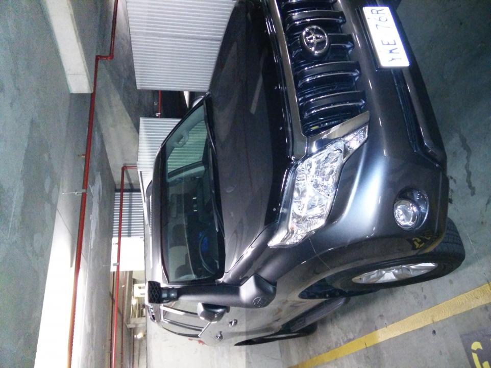

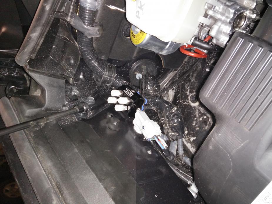

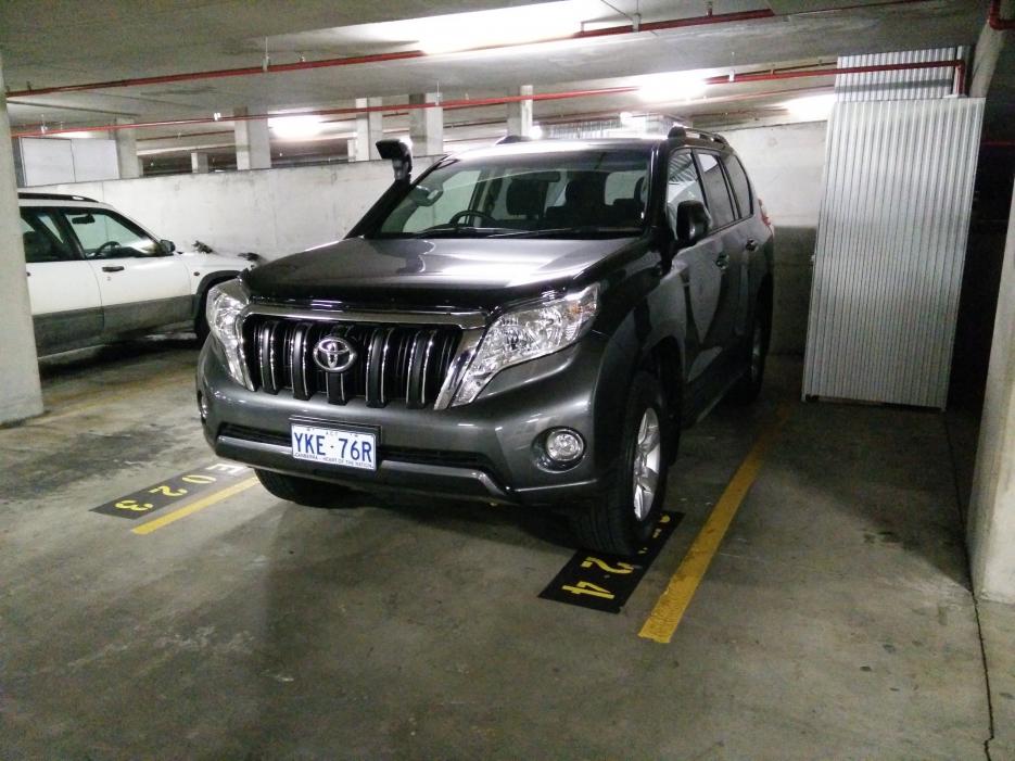

          Today I had the Safari Snorkel installed and I figured I'd get the guy to also install the diff breathers. He stopped half way because one of the connectors didn't fit as a breather replacement - my rear diff breather and transmission breathers are hooked up, not my front diff or the transfer box. Pretty happy with the opposite lock Canberra/Queanbeyan shop. The advice I've received was been pretty fair and honest, and I like how they just said "look, we could have gone sourcing a part for you but you can do that yourself, for free". They knew I threw the breathers in as an afterthought. I'll look to finish it off this weekend if I can get around to it.
          Here's the snorkel.
          And the diff breather kit mounted
          (with only two breathers/filters attached)

              Why is it that these "3T" tow bars are always missing the 4 bolt main in the centre that the factory one uses in conjunction with the six bolt sides? How can that be better or stronger?
              [/CENTER]
                Id imagine that its probably got more to do with the strength of the steel? I'd think that any bolts you'd use are strong enough for the job regardless of the amount used.
