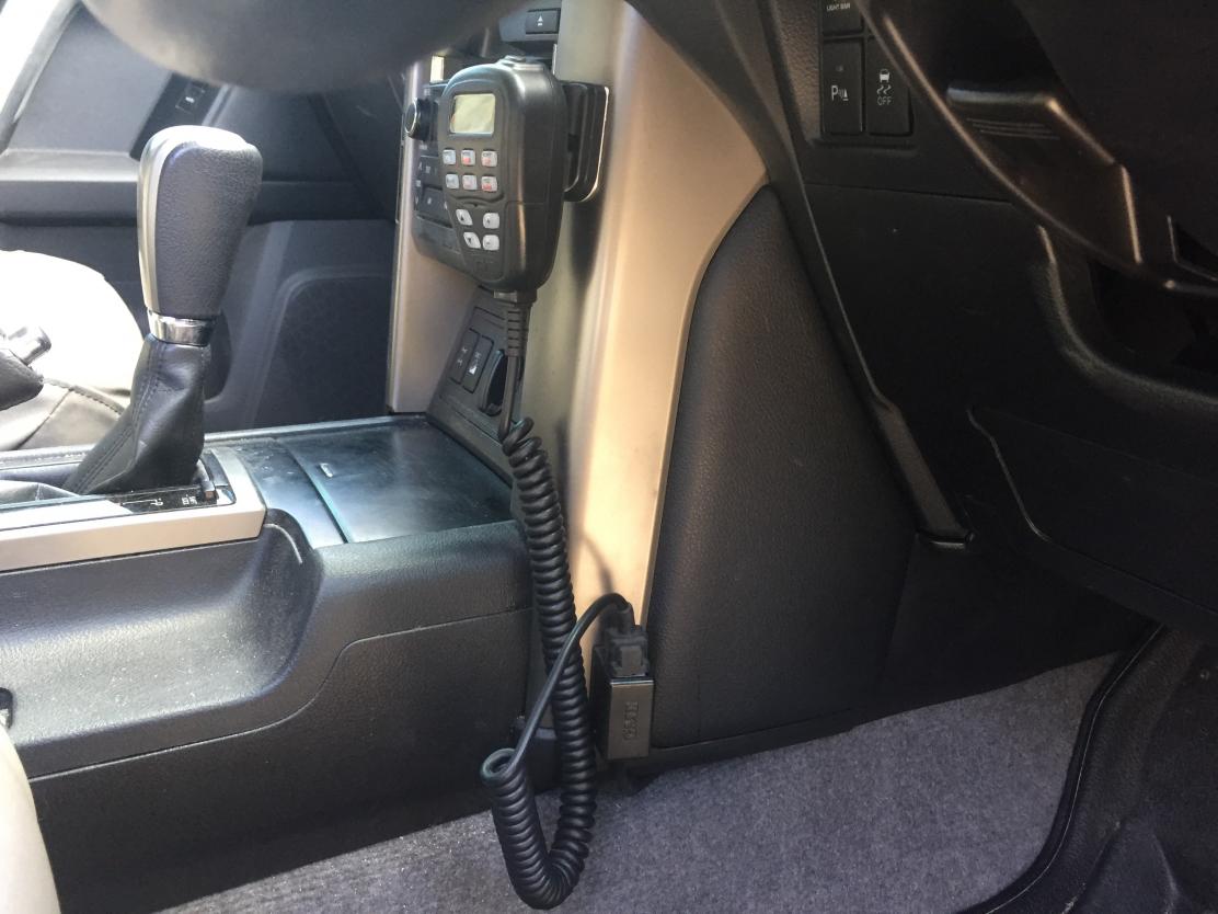

      Didn't take long before the car was home, in the garage and in pieces having the radio in stalled (mounted behind the trim in front of the centre console with the hand piece mounted on the silver trim next to the stereo.

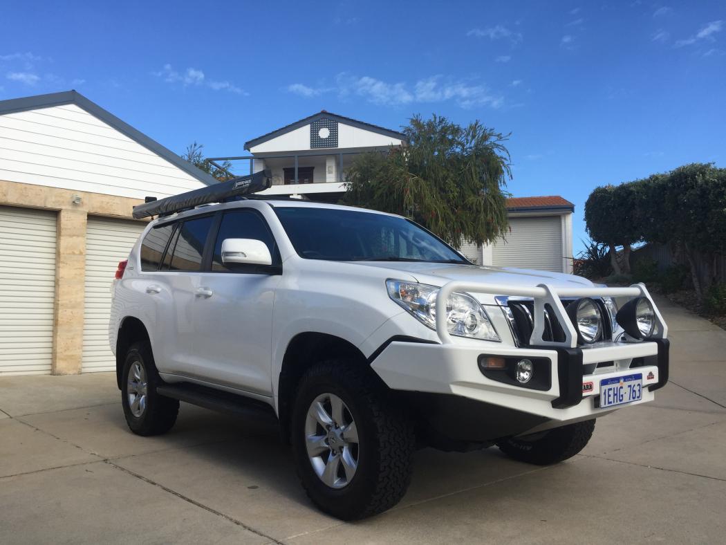

        After that little birthday, it sat like this for a few weeks before decided it was time for some new shoes and an ARB deluxe colour coded bar with a set of Fyrlyt 5000 lumen spotlights. Now it was finally starting to look a little less “soccer mum”
