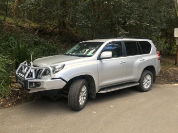

    Hi all, thought I'd post up my 2013 VX. Bought it 3 weeks ago, came with the ARB bar and a UHF, just need to get everything else done.
    List of things to do;
    - Fit dual battery setup
    - Fit fusebox and relay box
    - Fit EGR plate
    - Clean EGR valve and elbow
    - Flush auto
    - Fit electric brake controller
    - Fit light bar
    - Fit onboard compressor
    - Fit rear drawers
    - Fit winch
    - Fit lift kit
    Can't wait to get it out on the trails.
