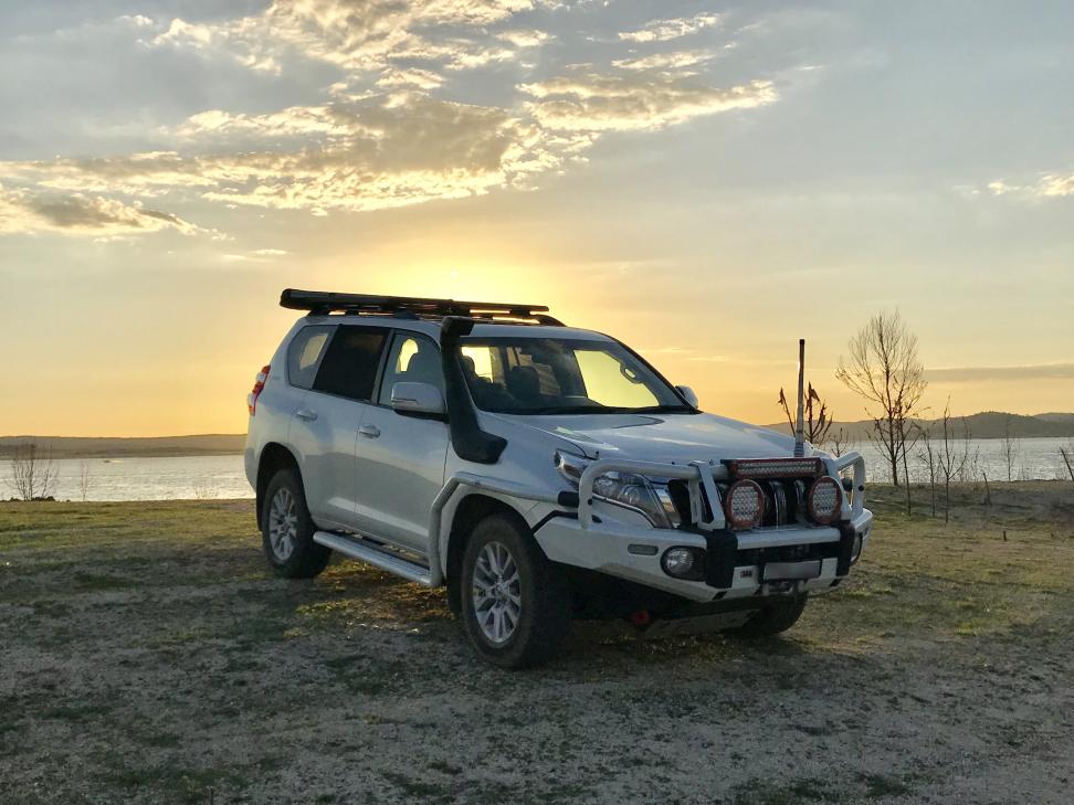

Heath's 2016 150 Kakadu

            Pic with the new gear
              [ATTACH=CONFIG]26426[/ATTACH]
              Looks sweet AF. The ARB summit bar and rails look tough. Poor thing is totally dying for the lift now.

                        Finally got around to taking a picture with the suspension upgrade
                          What are your heights from the bottom of the rim to the bottom lip of the wheel arch mate? Looks great, by the look of it those rims are the 18inch option that you can get with the VX/kaka?
