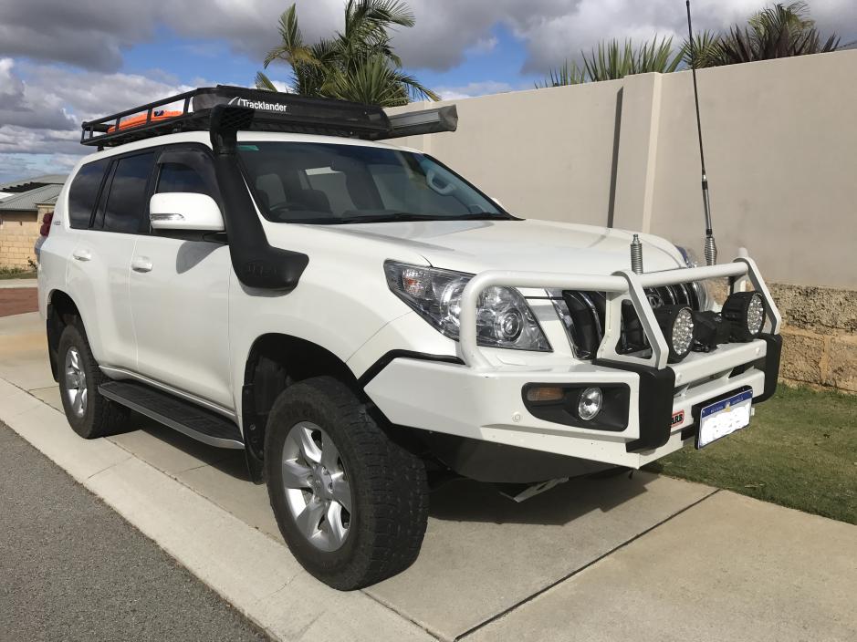

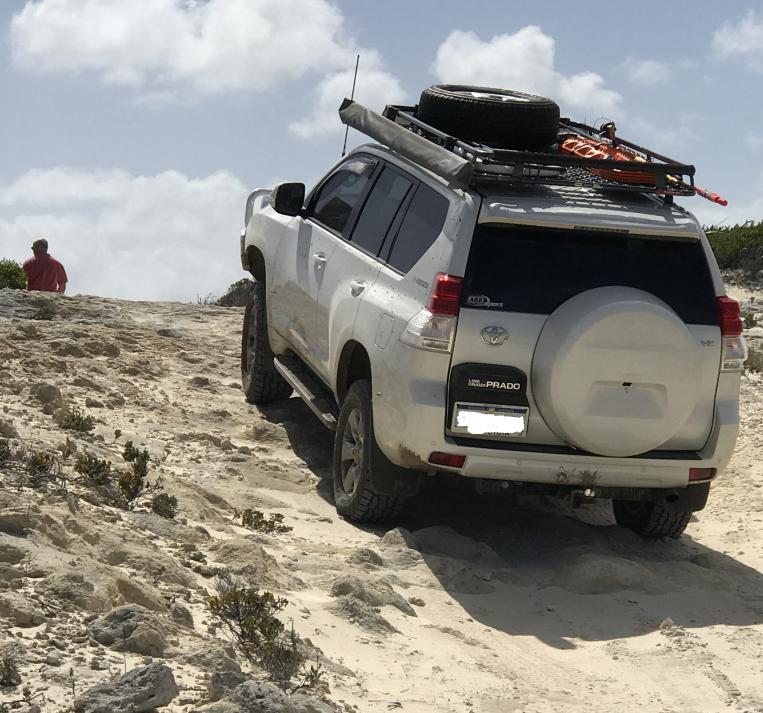

    Hi all,
    The following lists my build journey since I bought my Parado new in May 2013:
    *2" ARB Suspension Lift
    * OME Springs (300kg Front & 400kg Rear)
    *OME Shocks / Struts
    *ARB / Redarc Dual Battery system- Redarc BC/DC Charger
    *Tracklander full size (2.1M) alloy Roof Rack.
    *GME UHF Radio
    *ARB Winch Colour coded Steel Bull Bar
    * Great White LED Spotties
    *Smittybilt 10,000lb Winch (Soft Rope)
    *ARB Onboard Compressor
    *ARB Read Diff Air Locker
    * ARB Diff Breathers
    * ARB 47 L Fridge
    *ARB Rear Drawers & Fridge Slider
    * Safari Snorkel
    *ARB touring Awning
    I'm just about done now and she's a great all rounder that has not missed a beat over various terrain.Click image for larger version

        some pix would be great...love seeing other peoples Prados
          C'mon trev show us some photos!
          Micheal.
            Sorry Gents. Been away, I'll get a pic or two uploaded as soon as i figure out how to do it..
              OK. I think that worked?, should be a couple of pics of the Prado now.
                Yep, looks good!
                  nice one Trev!
