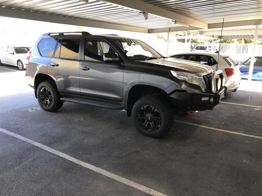

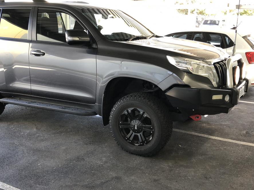

      Looks good. - Very high in the front.
      What is your rim to wheel arch measurement?
      Is the 25mm spacer with stock front struts?
      Micheal.
        Looks good mate, the grey looks beastly i reckon
          Yep, stock struts.
          It’s 190mm from top of tyre to the wheel arch. Same front & rear.
            Originally posted by GXL.15 View Post
            Yep, stock struts.
            I like the black rims. Whats the front measurement from bottom of rim to the wheel arch?
              Pretty sure its 805MM from the bottom of the rim to the wheel arch, id need to re-measure to make sure.
              Wheels & tyres will be for sale soon, getting a 275/70R17 or a 285/70R17 in either a ET0 or ET13 rim.
                What suspension in the front? As the others have said looks very high at the pointy end. The 25mm spacer will give 50mm lift so any extra will kill the cvs without a diff drop. Spacers aren't legal if you are interested in that.
                  OEM Struts in the front with 25MM Strut Spacer (On top of strut)
                  Yep, I know. The spacers were never about a permanent solution. Only went in about 3 months ago. It was always a case of trying to identify a height I was happy with. Glad I did it that way too.
                  Its likely i will put a set of ARB BP51 Shocks/Struts on the from to match the rear. In a few weeks the rear will have an Airbag man 2" Bag lift and ARB BP51 Shocks. Getting rid of the rear coils completely.
