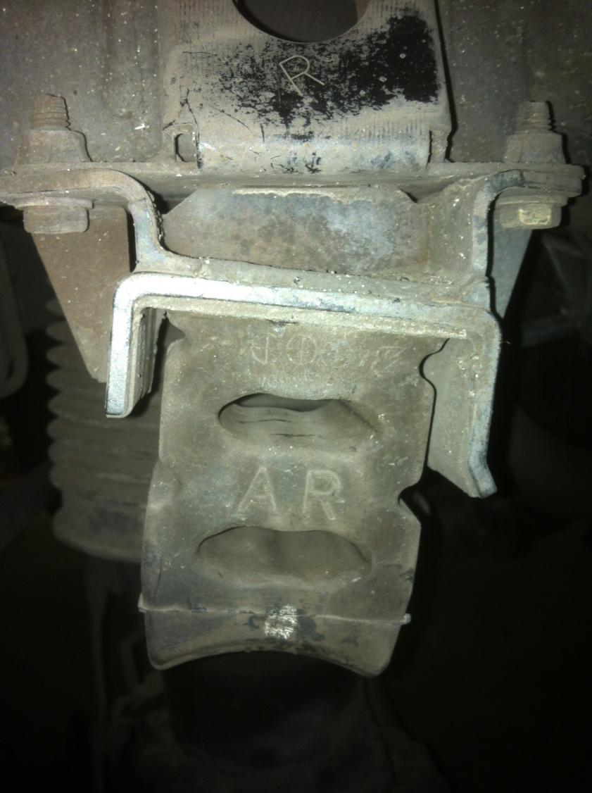

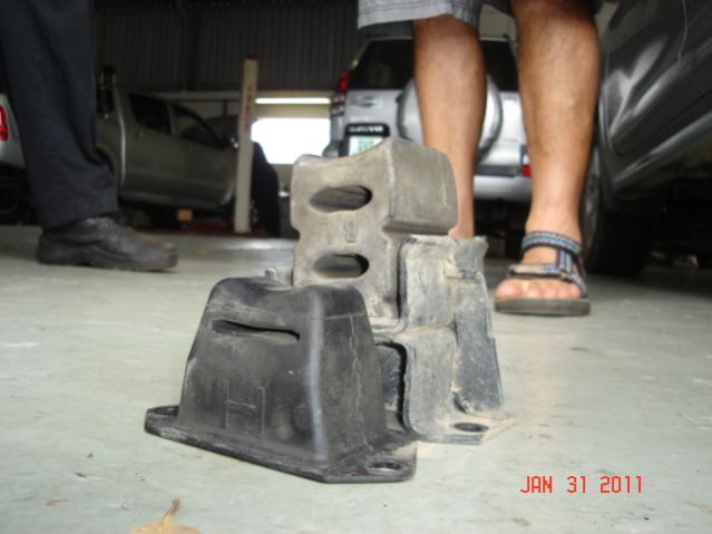

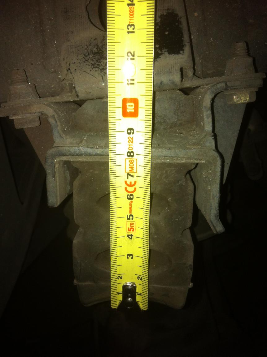

          • What about longer rear bumpstops to give you more clearance for your tyres? With shocks as long as yours, it looks like you may already have bumpstop spacers and/or Hilux bumpstops, but the bumpstops in a Prado Grande are considerably longer again and could give you the clearance you need as well as ensuring your rear shocks don't bottom out:
