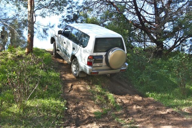

    A trip to Stockton beach has revealed that LPG can be sucked through much quicker under load (250kms for 60 l), while a trip up through the watagan mountains found that the ramp angles of the 90 series are awesome even with the standard height suspension. The previous life of my Prado has seen a set of 17" alloys with Bridgestone Dueller 694s (265/65/17). The dueller 694s keep up extremely well with BFG AT's while the trails consist of dry dirt, gravel, and rock. They have even faired some wet trail work though they seem to show their limit very quickly. The 17" alloys appear to have come off a 120 series with the 30mm offset. The pictures with the 17s show how far inside the guards the current treads are hiding. A set of GU patrol 16", 0 offset steel wheels have been sourced from none other than eb ay. These are currently renting space in the shed waiting fora set of BFG MT KM2s.
