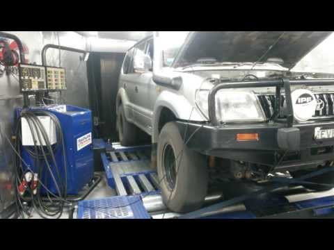

Yep the stock figure of 132 Kw is at engine - not 4 wheels.
Glen's 95 series Prado getting broken in
Assuming a 40% loss through the drive line, your engine is probably putting out around 200KW at the flywheel now. Not a bad increase from 132KW[B]Declan[/B]: [SIZE=1]1997 GXL 4.5 Auto 80 series on [B][COLOR="#FF0000"]LPG[/COLOR][/B], ARB bullbar, 2" OME lift, 32" MTZ, GME UHF, rear ARB locker, Kaymar spare wheel carrier[/SIZE]

Very similar results to mine, with a URD 7 psi pulley my Prado produced 130.9 kw @ 4700 rpm then the belt started to slip.
Some alternator adjustment fixed that issue.
The big improvement I reckon though is the torque, 575 nm @ 2600 rpm is a huge improvement on the 303 nm @ 3600 rpm, 270 nm more at 1000 rpm less.... great for 4 wheeling.
The torque improvment is why I believe fuel consumption doesn't suffer as one would expect because your usually in a higher gear running at a lower rpm.
Congrats on a great install.

Yes the torque change is the most amazing, and would explain why this thing can take off so aggressively. The figure seems too high though - perhaps it's a glitch such such as the TC not being locked up at the beginning of the run. I'll ask them for torque charts and see.glen_ep - engineered, 4" lift, 33" 255/85R16, lockers, 4.88 ratios www.pradopoint.com.au/showthread.php?17237 www.youtube.com/user/glenep www.fb.com/groups/ToyotaPrado90

The most obvious restriction on the dyno day was my new exhaust - it's a 2.5" pipe with cat and single muffler. It's restrictiveness was very obvious to the tuner, and definitely prevented higher Kw figures. My preference for torque, low noise, legalities and passing emissions, means I can't open it too much. I'm certain if it was opened up more the Kw would be over 130.
BTW - the tuner himself used to have his own supercharged 3.4L 90 series, and reached around 170 Kw with a smaller pulley and; I think; gas injection.glen_ep - engineered, 4" lift, 33" 255/85R16, lockers, 4.88 ratios www.pradopoint.com.au/showthread.php?17237 www.youtube.com/user/glenep www.fb.com/groups/ToyotaPrado90
