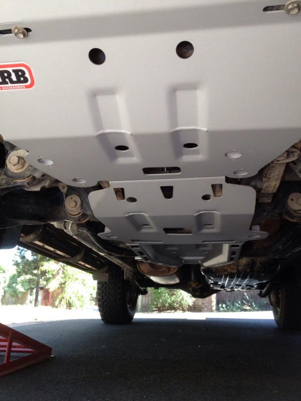

                    It will be interesting to see how they go. I like the BD gaurds as they are smooth and slide over stuff and crap doesn't get trapped in them. Can you get the transfer case guard on its own?
                    • I'm sure they'll get a good workout next weekend during the MySwag huts trip. Not sure about the transfer case by itself. Will find out.

                      • Thanks, one more question. How do you change the oil?
                        • Sump plug is directly above the square hole. Up a fair way though so protected.

                          • Hi Sam,
                            I have a set of the ARB Protection plates on order, thanks for the photo's, they look great.
                            Any chance of a bit more info please?
                            1/ could you post a photo showing where the front plate meets the plastic bumper? About six inches forward of the attached photo would be perfect.
                            2/ any idea how heavy they are?
                            3/ does the transfer case plate cover the actuating module?
                            4/ did you lose any ground clearance?
                            Thanks,
                            Greg
                            • Originally posted by BNEGXL View Post
                              Hi Sam,
                              Thanks,
                              Greg
                              Hi Greg, no loss of clearance at all. The plates sit up nice and high. I'm not sure about the actuating module on the transfer case, I'd have to get back under the car for another look. It does cover the majority of it though. As the kit is made of of 4 different plates, they're not that heavy to fit. I did it quite easily myself in my driveway.
                              I'll take another photo of the front of the front plate for you.
                              Cheers, Sam.
                                Hi Sam,
                                Could you post a photo showing where the front plate meets the plastic bumper? About six inches forward of the attached photo would be perfect.
                                Greg
                                How's this Greg?
