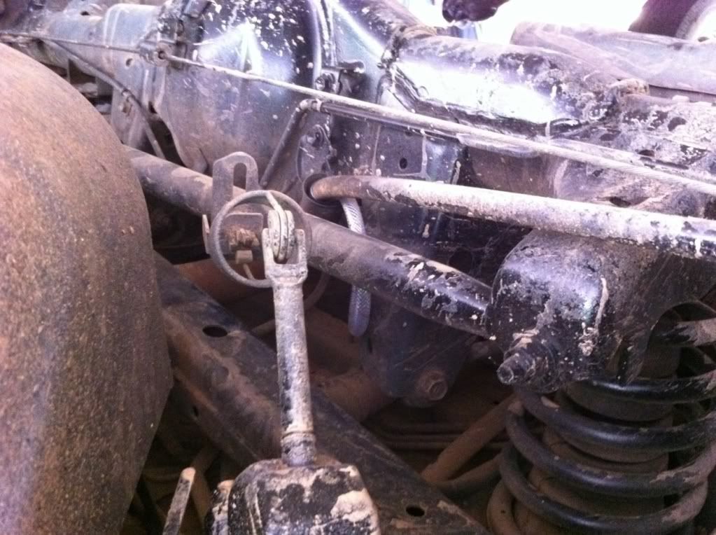

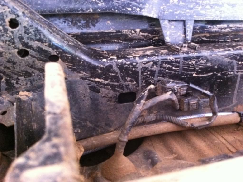

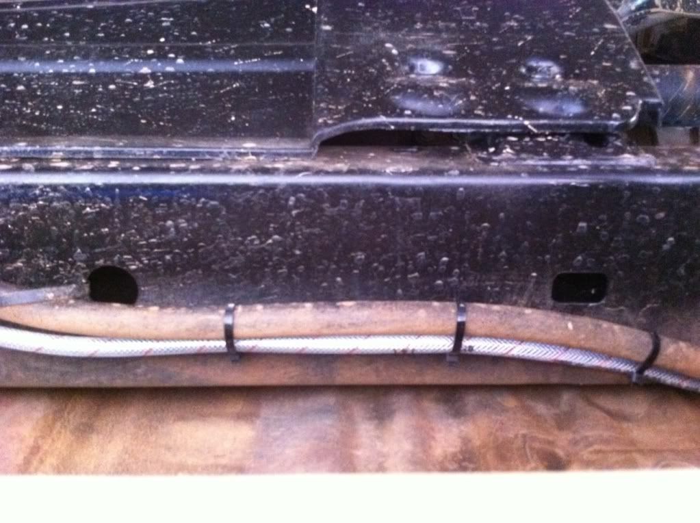

          Been plodding allong fitting some different things, I decided to extend the diff breathers, using Rouges idea (thanks Rouge) well motly anyway, but i decided to route the rear diff breather up into the engine bay,
          I routed the breather hose up on the outside of the chasis rail which was also running another pipe. and then fixed both front and rear filters with zippy ties just behind the charcole canister,
