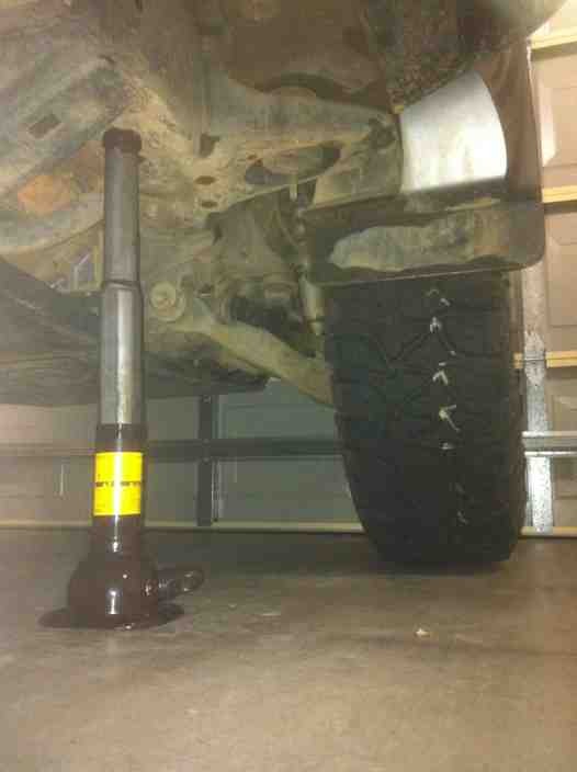

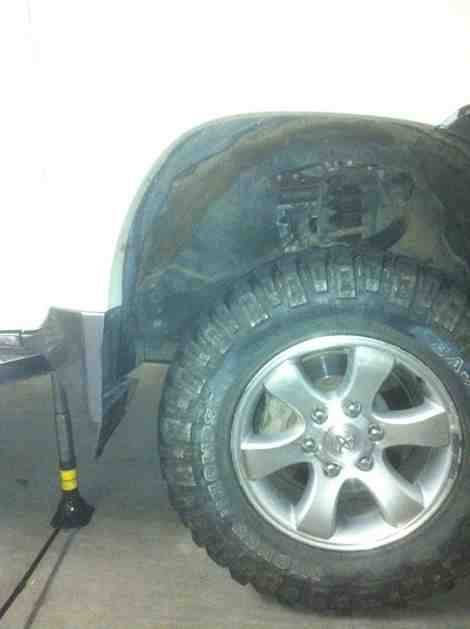

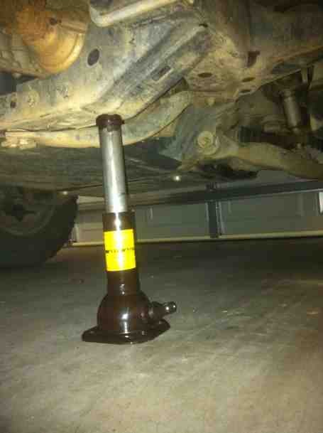

It's not the actual lift that is the issue, it's the droop travel. Mine is 930mm rear and 890mm front at max extension measured from the bottom of the 17" rim through the hub centre to the bottom of the guard
