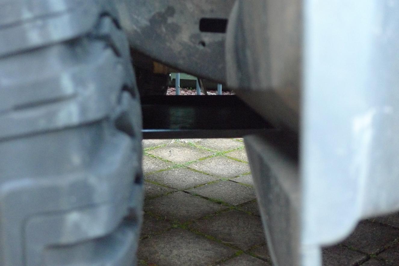

    Here is a photo of the top of the rear plate through the tyre and wheel arch I promised a few posts up.

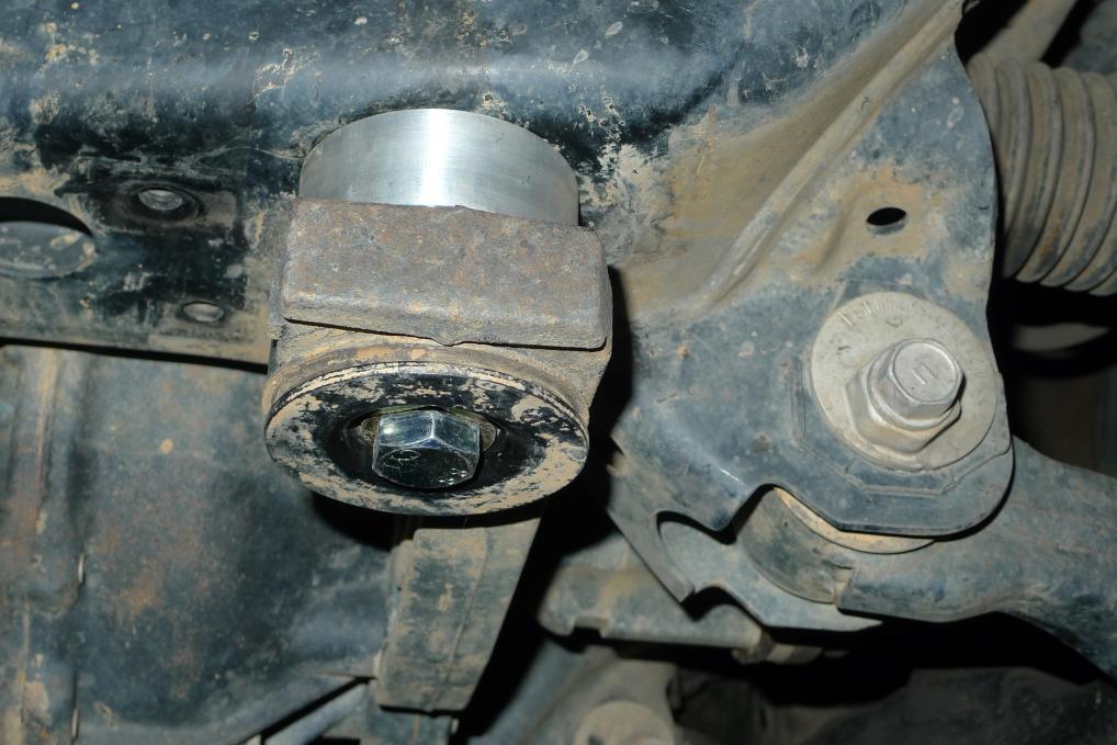

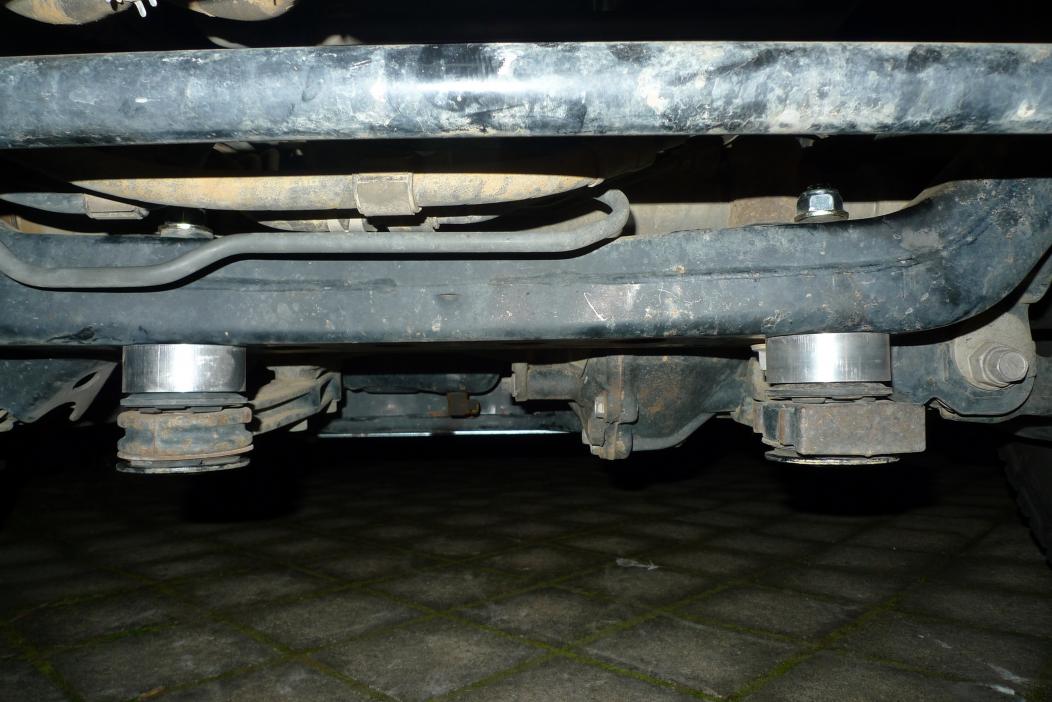

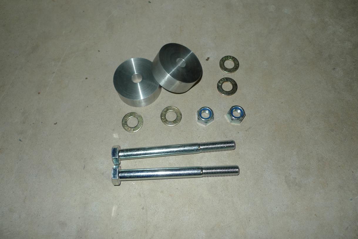

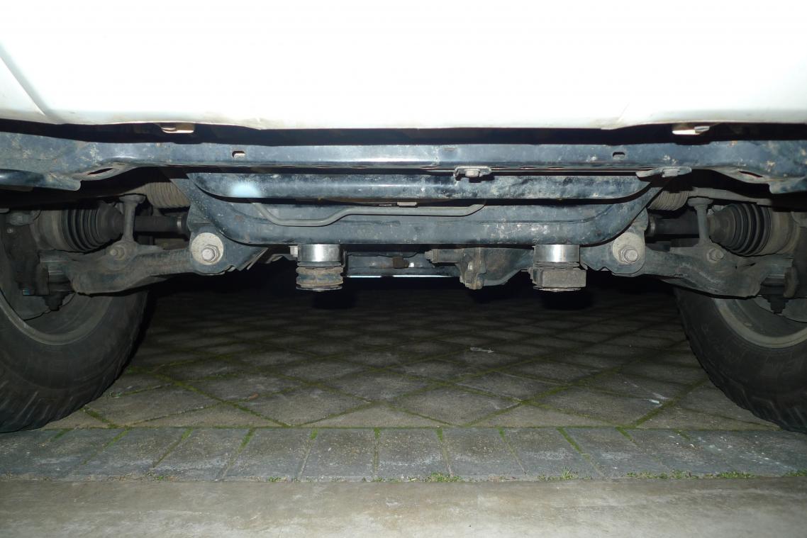

    • Tonight I installed my diff drop kit to make sure that the bashplates are going to clear the diff. Here are the photos of the kit and with the kit installed. Took under half an hour.

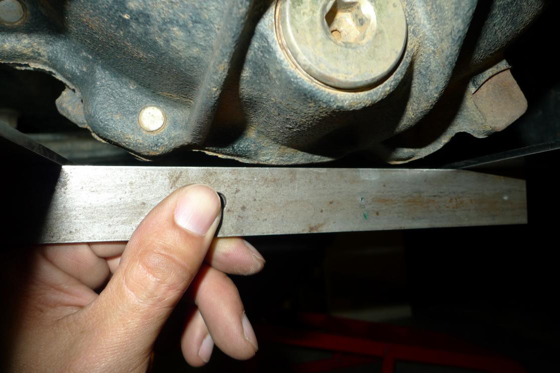

      • And here is the photo of the clearance of the bashplate to the diff. About a bee's whisker, or less than a mm.
        I also measured the clearance of the bashplate and I got 250mm. This is with the suspension settings on normal height (Grande), 40mm lift at the front & rear and 265/70R17 Wrangler MTRs with 40psi in them. I then ran out of time to measure the factory bashplate.
        I am now standardising the front plate so that it is common between the diesel, V6 and whether you wish to have a diff drop installed or not. The photo below with the <1mm clearance between the diff and the bashplate is the new standard plate. I am making cutouts to cater for the transmission cooler line brackets. This means that the ground clearance is the same for all Prado variants. The only variant now is the rear plate which needs to be longer for the diesels.
