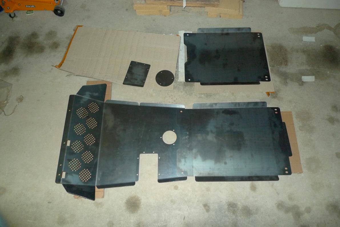

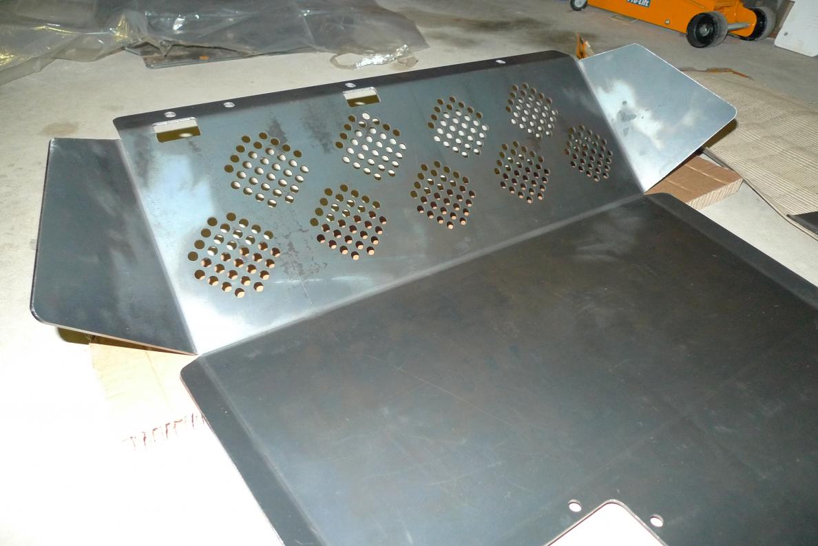

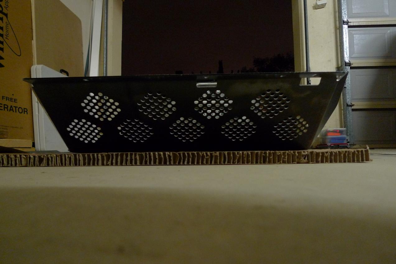

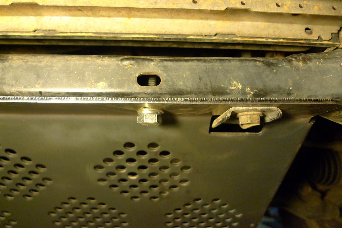

                          • Missus is down with the flu and everyone is finally in bed now. So I'm sneaking out to the garage now.
                            Edit: attached are the pics prior to going onto the Prado.
                            amts
                            Ninja Poster.

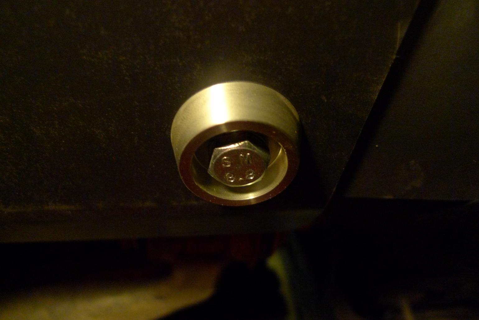

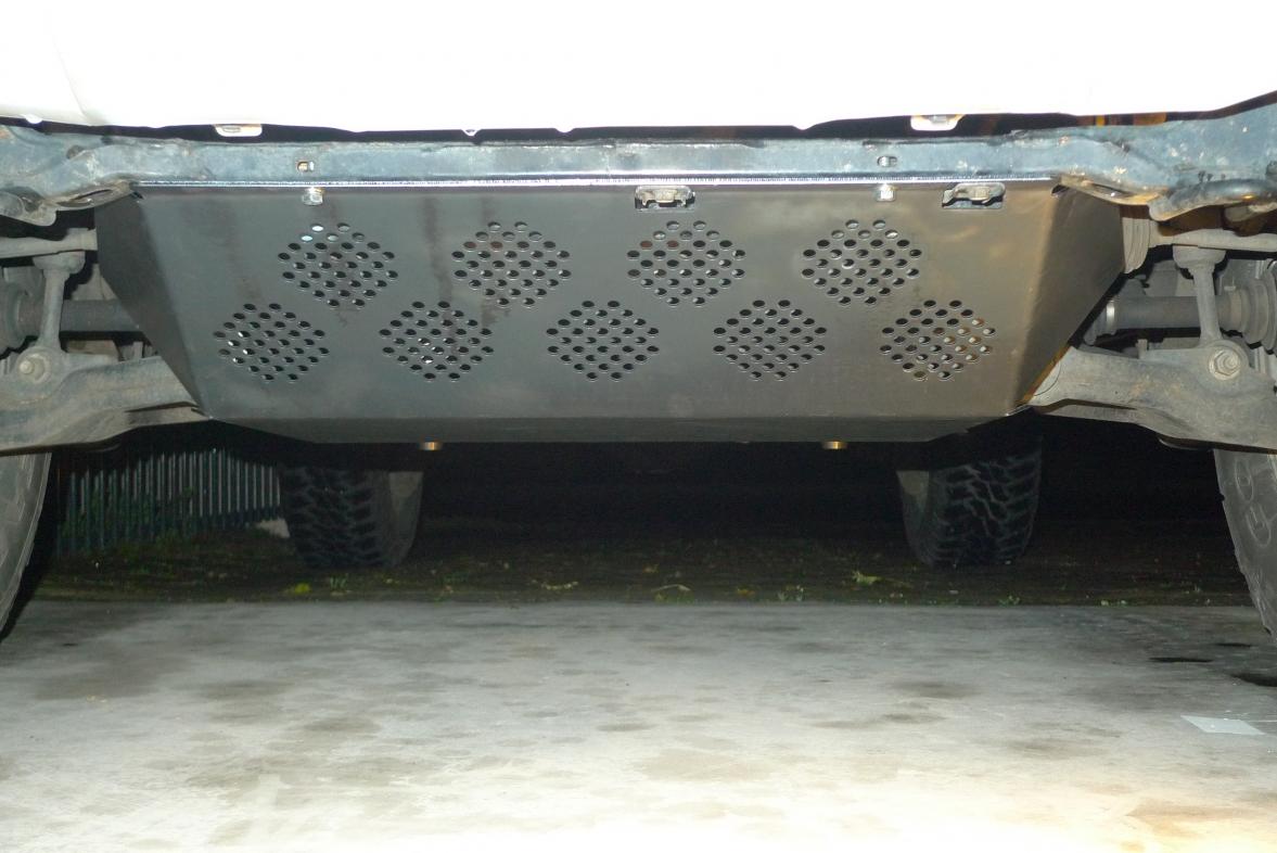

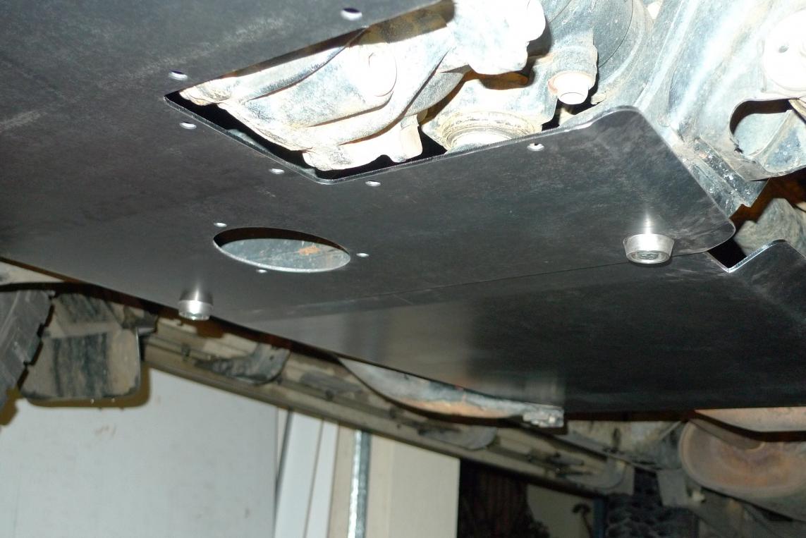

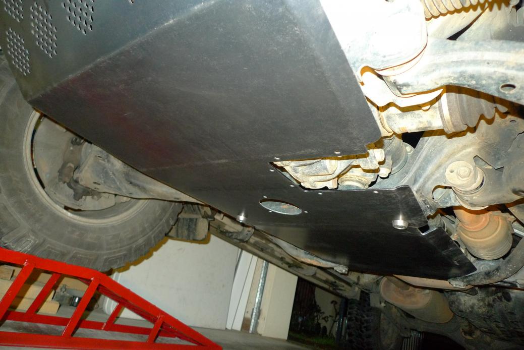

                            • More pics of the plates installed

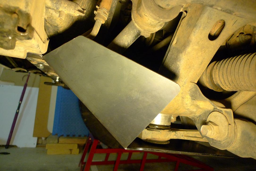

                              • Couple more...
                                The plates are almost perfect. It needs one bend to be angled more as it is currently interfering with the diff by 1-2mm.
                                Measurements taken on my car:
                                Front suspension height 772mm
                                265/70R17 Wrangler MTRs with 12mm tread
                                Diff mount 278mm
                                Diff 253mm
                                Cross member (aft of sump) 256
                                Bolt head protector 246
                                compared to voyager4x4 measurements:
                                Here are the clearance dimensions as measured on voyager4x4 with 760mm front. & 800mm rear. Running on 265/65R17 BFG ATs
                                Factory vs AMTS
                                Diff mount 247 vs 242
                                Diff 238 vs 228
                                cross member 228 vs 230 (aft of sump)
