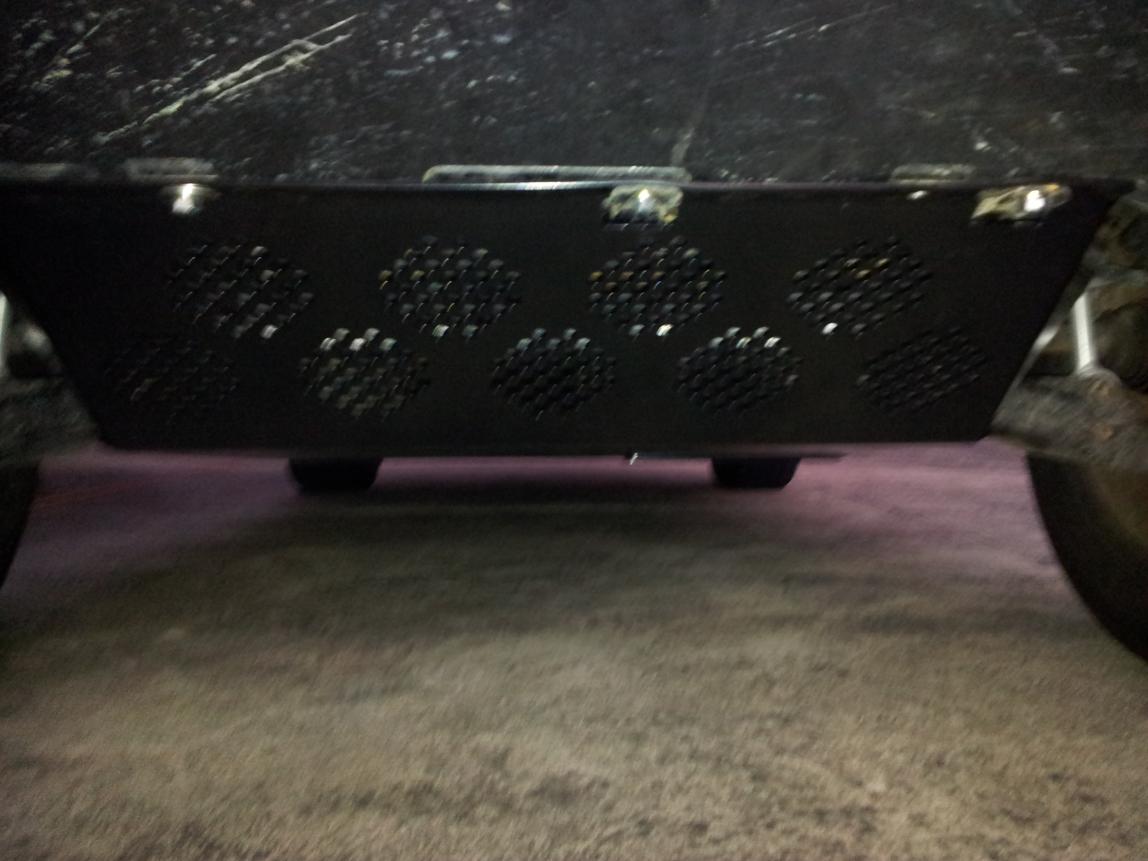

  • Wooo hoo.... AMTS bash plates are on !!! They looked brilliant, it felt bad to put them under the car. Thanks Andrew!!

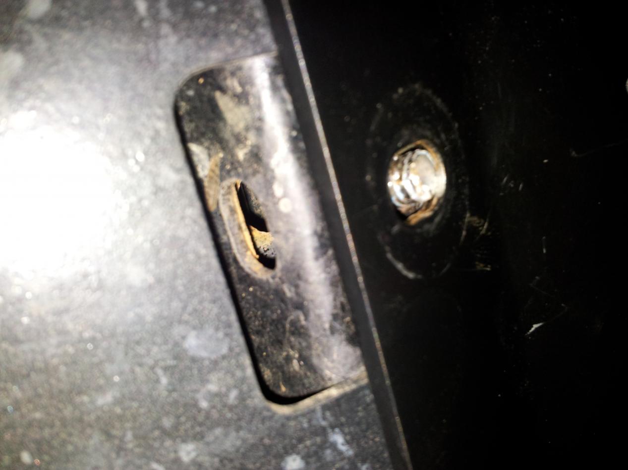

    Some how been me!! I managed to break one of the bolts by over killing it !!

    It could be tricky to get the bolt out.. so I hope 3 bolts at front would do the job till I manage to fix the other
      Thos are high tensile bolts. Sure it wasn't cross-threaded?
      Have a search on easy-outs. Should be right with the 3 bolts.
        It could well be cross-threaded. The fact that I was doing it alone didn't help
        I'll check easy-outs...
        • damn, you managed to bust a high tensile bolt...thats a good effort.
          I got a bolt out of that same hole with an easy out before. check my thread here http://www.pradopoint.com/showthread...-on-bash-plate

          • Originally posted by blackvx View Post
            Used a Breaker-Bar for the reach, didn't felt till it snapped. As amts suggested probably it's cross threaded.
            Thanks !! I might drop down to Bunnings at some point.
            • When you've got it out:
              [Easy way] run a tap through the hole. Then put the replacement bolt in lightly.
              [Hard way] Undo the radiator bolts and swing the radiator out of the way, run a tap from the top of the cross member, then insert longer bolt from the top of the cross member and use a nut at the bottom to hold the bashplate.
                I'll take the Easy way thanks..
