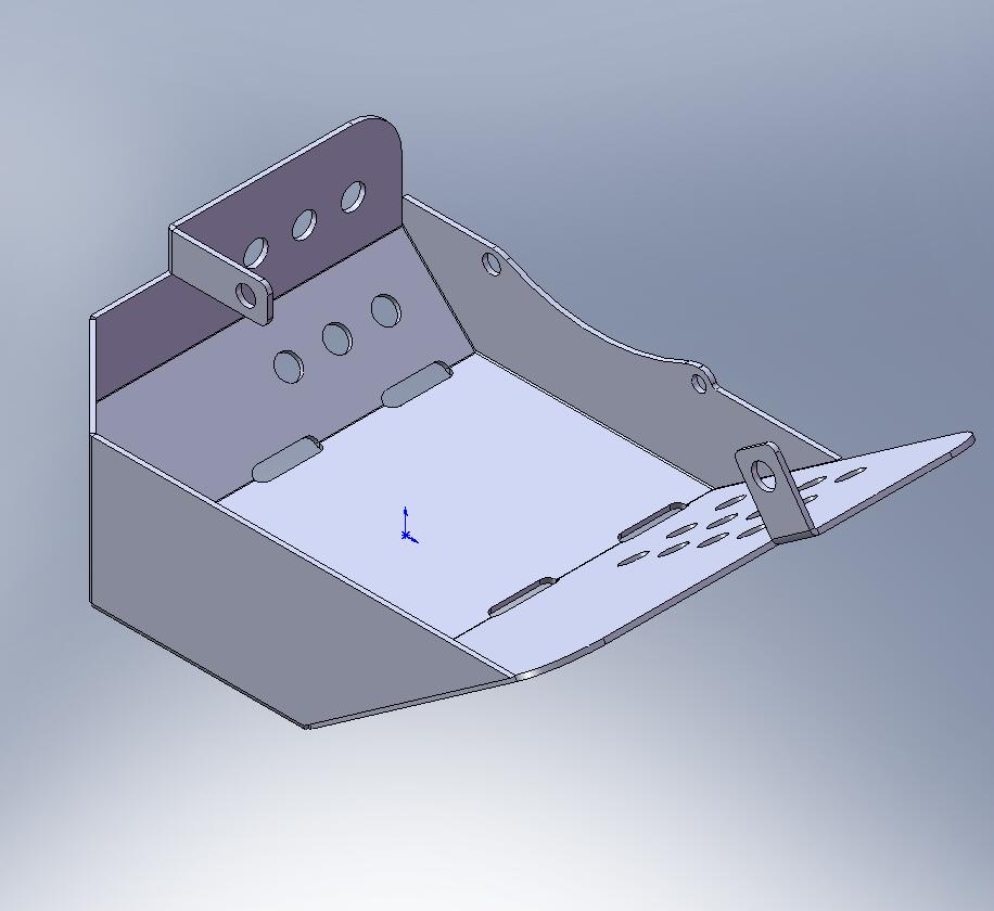

    Are there any holes to aid convection cooling? I noticed a TJM version (I think) that looked like it had cooling fins instead of an enclosed box. I presume someone must think this thing gets real hot?

      There are drainage holes along the bottom which can allow air to flow up and around the transfer case. With low range engaged, the speed of the car would be reasonably slow, so there won't be much forced air cooling in that circumstance. So I think a box would still be ok. More holes could be added to the sides near the front but not where the plastic actuator is.
      On the other hand, some brands don't even have vents at the front bashplate to get airflow around the front diff.

            • Pic of transfer case guard with a few vent holes.
                I think you are the 2nd PP member to ask. Happy to have a look if there were others interested? The person with the 150 that I measured up has now sold it and got a 90 series instead. So I'll have a donor 90 series to measure up. He may be the 3rd person.
