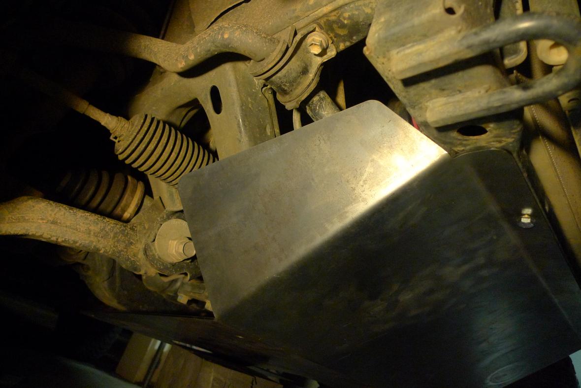

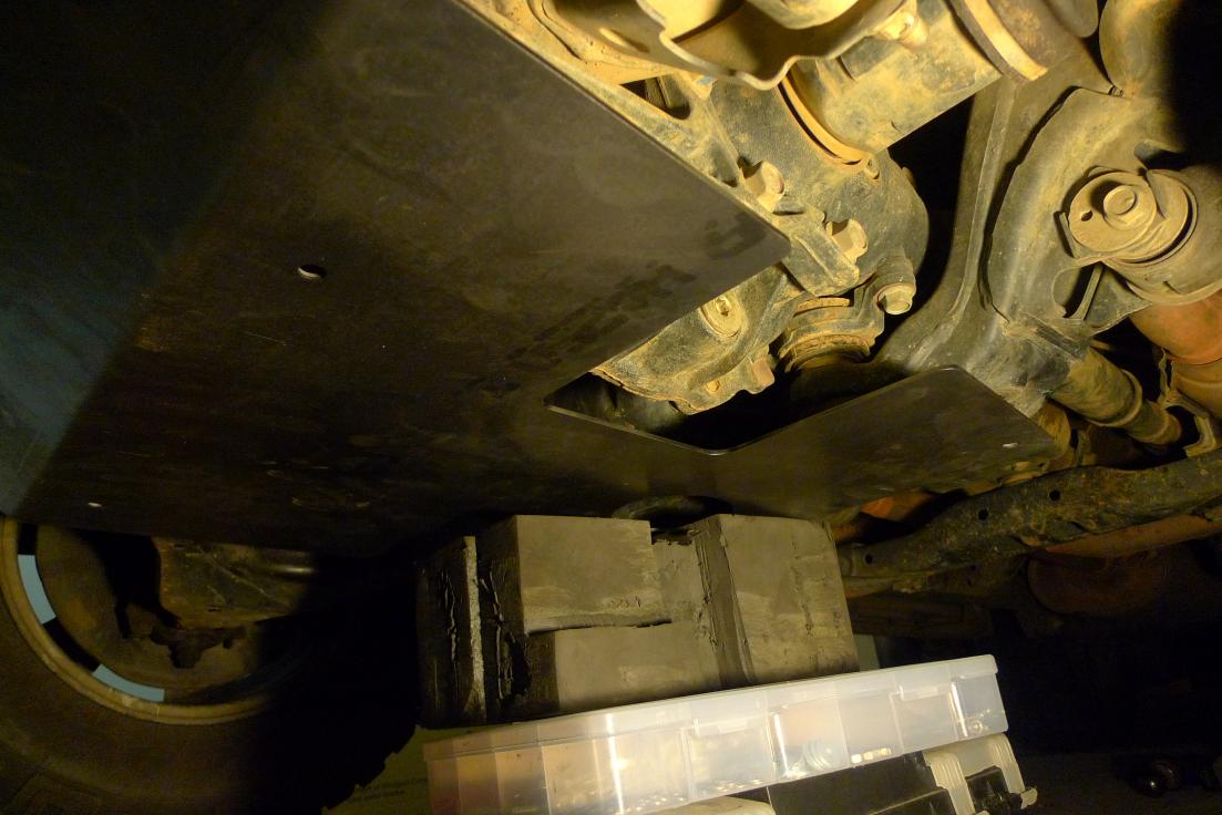

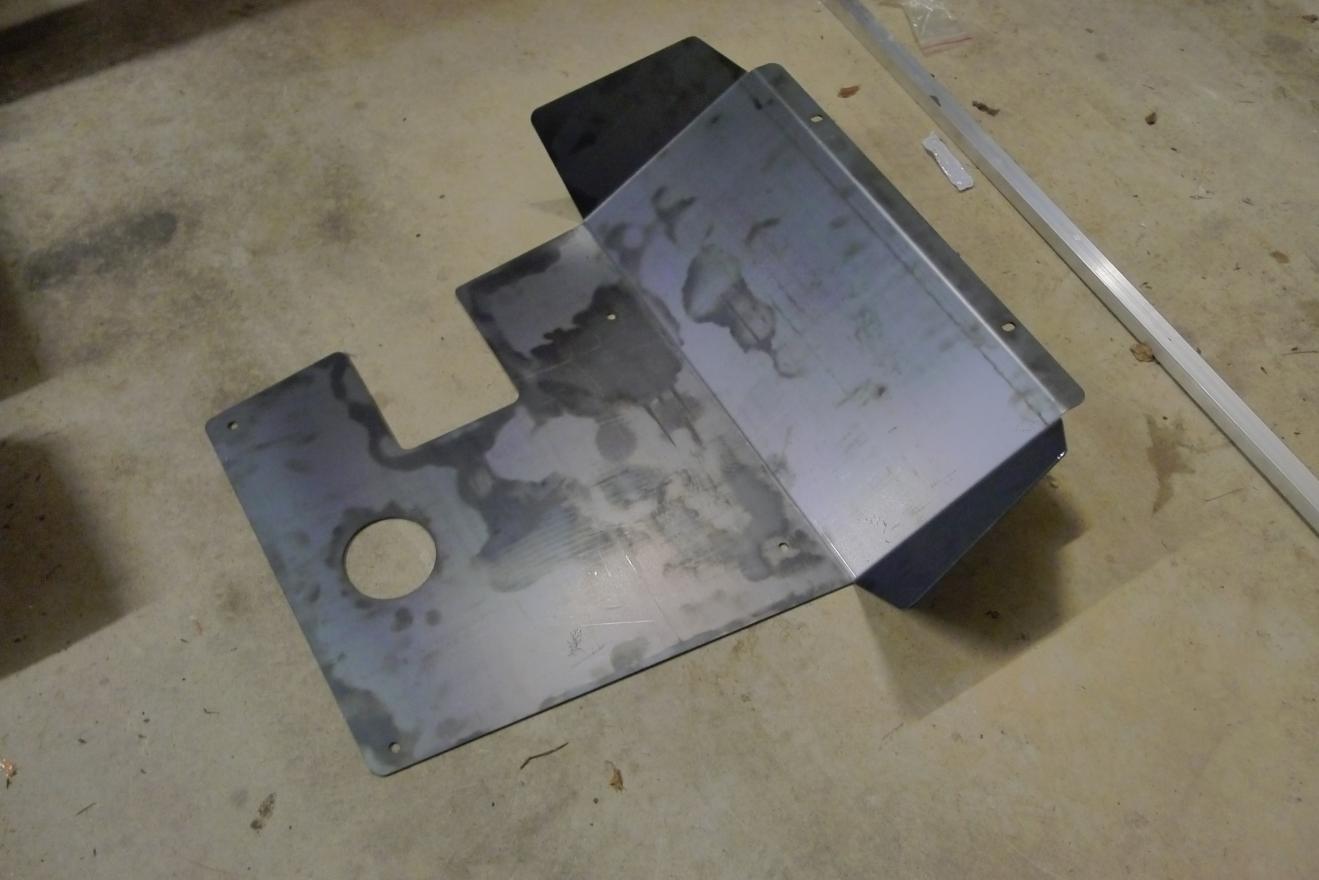

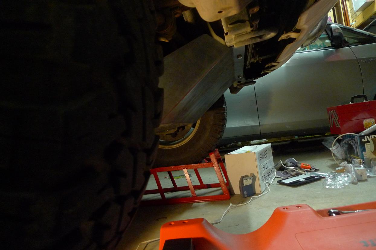

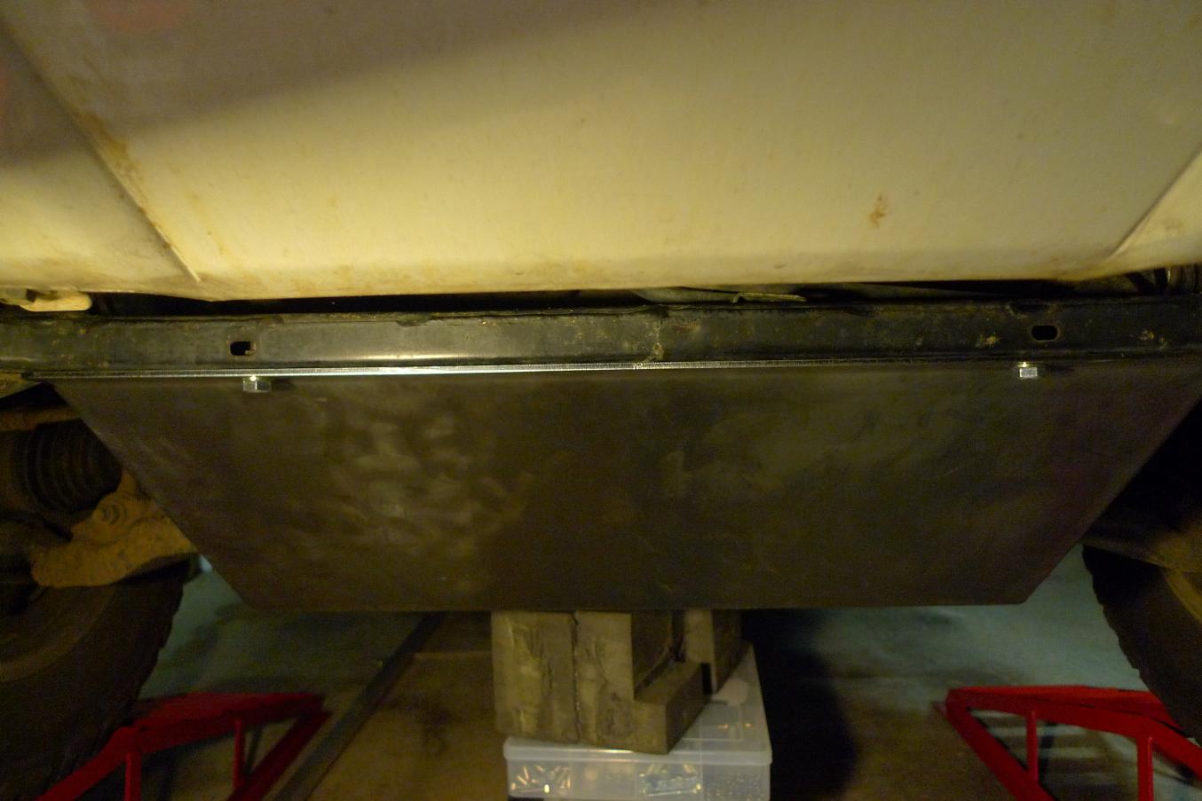

                        Attached are some photos. More in the next post.

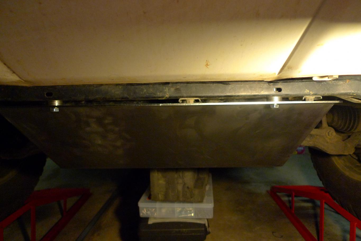

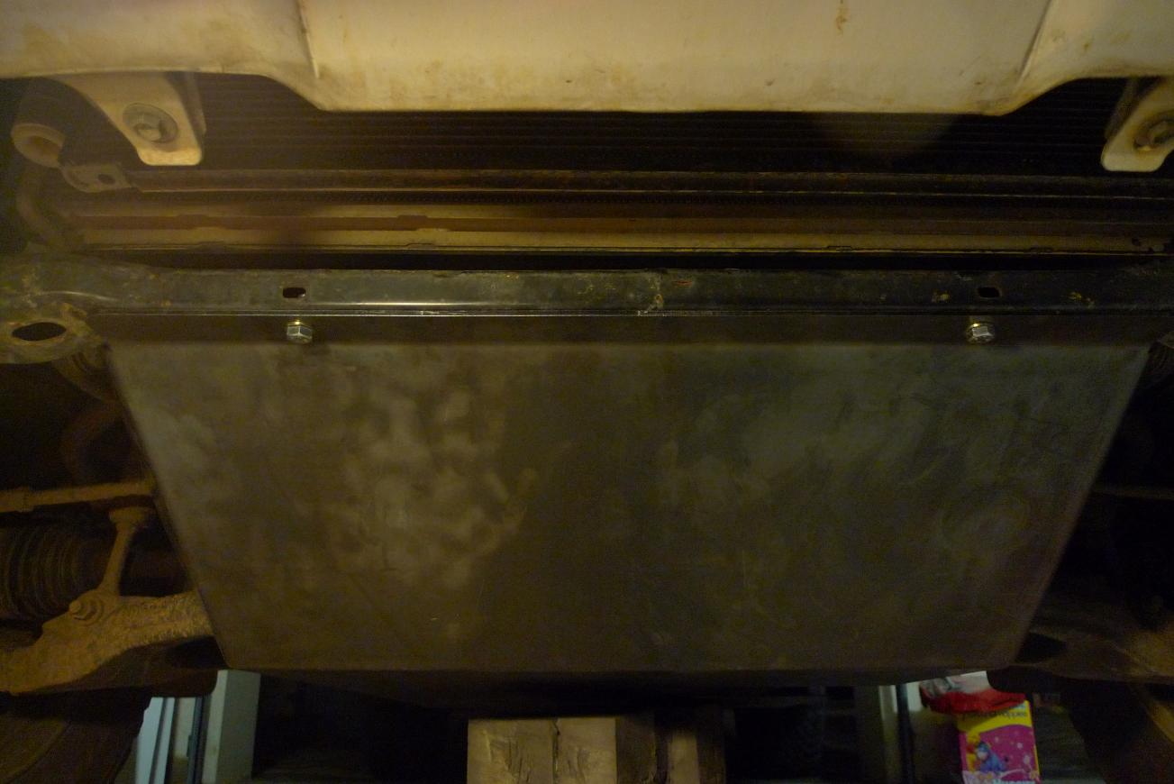

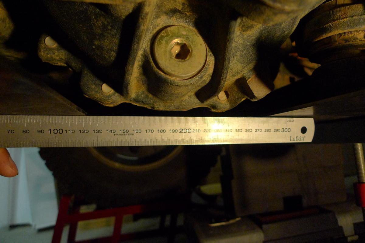

                        • Here are the rest of the photos.
                          There is a small glitch with the fold angles. I will get the fabricator to adjust it when I go back and see him tomorrow.
                          And to answer the clearance question, the bashplates will be nearly 10mm lower for the diesel and nearly 20mm lower for the V6 version compared to the factory bashplates.
                          • Sprayed and drilled for ventilation I presume?
                            Otherwise looking good...
                            • Noobie,
                              Not quite sure what you mean but the prototype has been stripped of most features but only the essentials to check manufacturing processes and that the mounting holes line up.
                              • this is looking good, can't wait for the whole thing to be ready. I guess you meant that the vent holes as per your first post will be installed in version 2?
