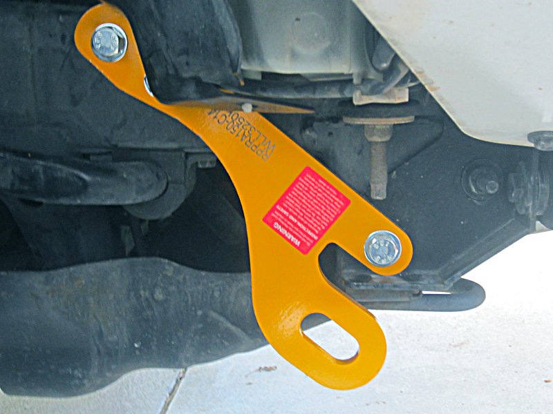

    Hey, has anyone had trouble fitting front road safe recovery points?. I have a 2003 Prado 120.
    The top bolt will not fit through from the radiator side.

    Don't they go on the outside of the chassis rail? I'm not 100% certain on the 120, but the 150 ones sure do
    [LEFT]Silver 150 Facelift
      Yep. Bottom bolt fits into the chassis - chassis is threaded. Top bolt come in through the engine bay. Radiator needs to be loosen but the hole in the chassis is smaller than the bolts supplied.
        Couldn't fit the 120 recovery points on mine due to having an Ironman bullbar fitted. Ended up getting a pair of 150 ones and they fit perfectly!

          dagree! you are a legend, did you have drill the top hole or was it already there? I'm having the exact same issue, I have the same setup with the ironman bulbar. I am couple days from biting the bullet and going to a steel fabricator to get him to make me up a new bull bar mount from thicker steel to mount recovery hooks on. So if the 150 brackets work that would save me a hell of a lot of mucking around
            If you don't mind waiting, I'm currently getting the next batch of recovery points that will suit 120 Prados that will bolt straight on. No mods needed.
              10 minute job to fit the AMTS ones. No buggering around with loosening radiators.
                Amts how much will they be for deliver to perth

                  $125
                    Yep, AMTS are solid as, well made and easy to fit. Having said that, don't use a cheap allen socket to fit them, or it will bust on the second torquing.

                      LOL - Yeah one of the torque figures is pretty high
                        Amts how long do you think till you'll get the next batch? and how much for delivery to Melbourne?
                          I reckon a couple of weeks. $125 delivered.
                            From memory the hole was there but had to be drilled larger.... Was more than two years ago when fitted
