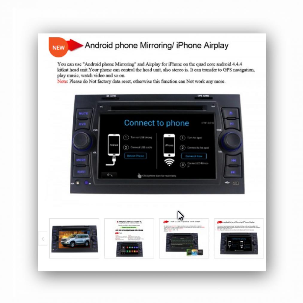

      BTW I also found this ideal unit for my 2009 GXL with Climate Air:
      https://www.carjoying.com/quad-core-...ch-double.html
      Dimensions are correct but not sure if mine has the two piece center console. This is Quad core Kit Kat, retains a single slot DVD, plus 32Gb Micro SD for data, 8Gb SD for GPS maps & front mic jack & USB. Also pairs with Steer wheel buttons. Most other types for Prado have 6in displays at lower res.
      But for our real time OBD2 data & GPS maps, the 7 inch HD 1024 x 600 would be great! This has all the usual phone / net bling stuff as well See this model at www.Joying.com.au AUD 409!

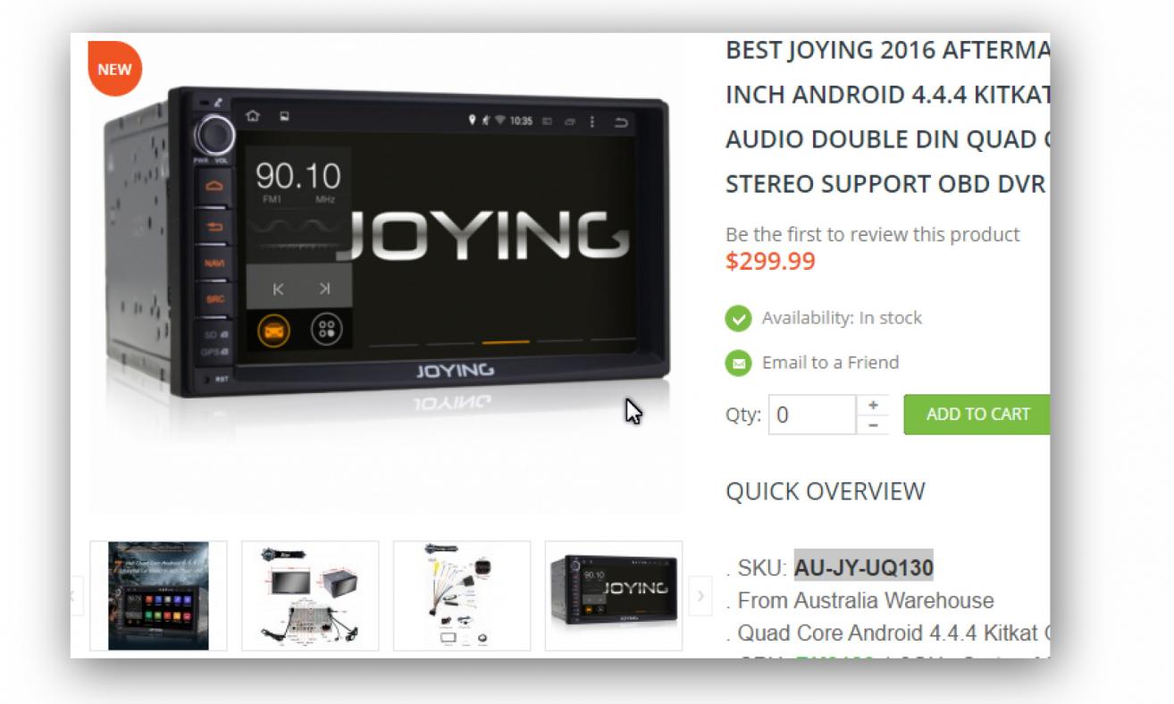

      Just had a close look at my center console facia, definitely a one piece, so the older Head Unit is no go. This later model Joying AU-JQ-130 at AUD299 would be better for me:
      https://www.carjoying.com/au-warehou...ew-camera.html
      Interested in the unit you chose?

        Interesting you to post that one. The Prado specific one. That was my original purchase, from car-dvd-gps on eBay. Three weeks after purchase, he still hadn't sent it. Excuses after excuses (HK electronics fair, Tomb Sweeping Holiday), so I demanded a refund, which he honoured. (USD fluctuation actually made it come back to my account with an extra $9, so party hard).
        Believe it or not, I spoke to carjoying about the same model, the Prado specific one that sits flush in the dash with the 1024x600px screen and quad core processor. They tell me "trust us, we assure you this will not fit your car". I own the 2008 Prado 120 Diesel GXL, and apparently that doesn't fit? I assume they're trying to push existing stock in place of what they don't currently have on the floor, but yeah. Curious.

            Correct the Joying 120 Prado unit with complete facia, would only work if you cut the trim panel above the climate air controls. Doing this would make the mod to install a new MFD non-reversable!
            Hence my preference would be the Carjoing Au-JY-UQ130 with android 4.4.1 retains a hardware power/volume switch - this is listed at Carjoying Aus warehouse: https://www.carjoying.com/au. A later model JY-UL-135 is updated to Android 5.1.1 but their website forum indicates Android OS 5 implementation is buggy ATM - updates & some hard fixes reqd.
            I also note they plan to update DDR3 memory to 2Gb as some users run out of install space for apps. I guess that may be "coming real soon"!
