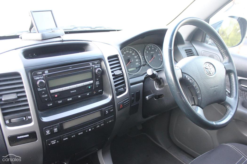

                          How did you go with this Trinedney, looking at the same unit as well
                          Assuming it will fit this dash
