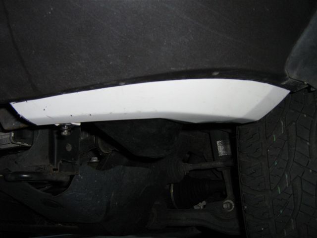

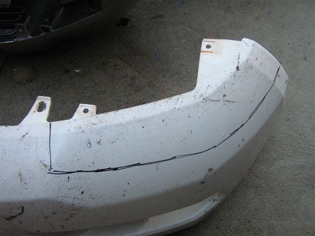

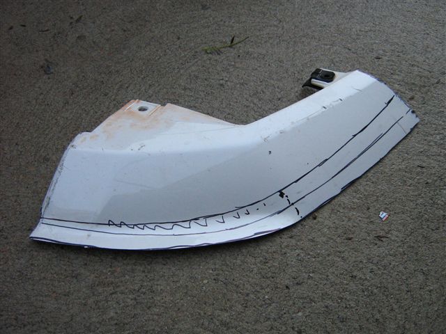

                    The front fender retainer is two pieces of plastic that fit between the inner liner and the bottom rear lip of the bar.
                    They stop any water splashing up into the air inlet. You can fit the bar without them then fit them after, be prepared for a shock two of them are over $80. I cheated and as I had a spare front bumper cut away the portion of the plastic bumper that fitted in that position leaving about 50 mm to spare. then I placed the cut out pieces into position and screwed them into their original mounts with the cut edge sitting on top of the bottom edge of the bullbar. Mark the edge of the bar along the plastic then remove and cut of at about 25mm out from the mark. Use a heat gun or a gas torch and gently heat the plastic until its soft then quickly bend the plastic back ( I did this by pushing it down on the concrete so the fold is square). By a bit of trial and error you can mould the plastic to the shape of the edge of the bullbar. I just used some small selftappers to screw plastic to edge of bullbar. A coat of black paint and you woudnt know .
                    I took photos as I went along fitting the bar
                    [attachment=2:32uzl7f2]Prado liner1.jpg[/attachment:32uzl7f2]
                    [attachment=1:32uzl7f2]Prado liner2.jpg[/attachment:32uzl7f2]
                    [attachment=0:32uzl7f2]Prado liner3.jpg[/attachment:32uzl7f2]
                    amts

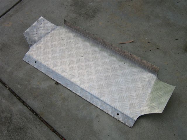

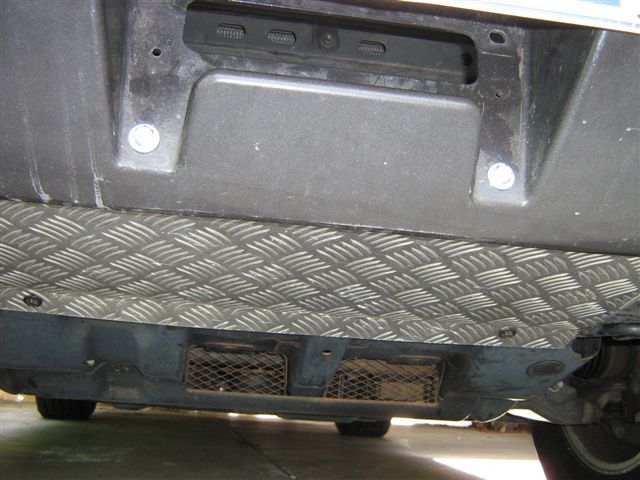

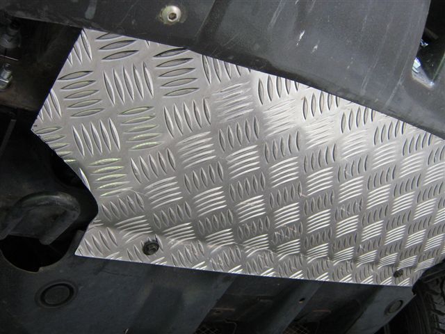

                      I also knocked up a bash plate that picks up the two existing bolt holes at the front of the standard bash plate and is bolted up inside the bullbar using the two holes behind the numberplate where the winch rope comes out.

                        Sparksy, very nice work. I love improvisation like this...
                        I called MANY MANY places yesterday looking for the correct plates, no one has anything, anywhere. I'll have another ring around today, to see if I can find a bumper bar, I only need the passenger side half. The plate I have is the drivers side, so my air intake is safe in this respect.
                        Also, Do you have the dimensions of the bash plate you made and what angles you had to bend? We have all the kit at work to make these (maybe not out of checkerplate), so if you can supply the details, I'll get a couple made.
                          Re: Sovereign bull bar fitting instructions
                          Sparksy, Your a lifesaver, The missus has been at me to get rid of the front bumper bar that has been in our spare room for 18mths ops: and I said i may need it one day. Well that day has finally come and now I know what i'm doing on the weekend Cutting up the old front bumper.
                          Thanks heaps
                          Greg

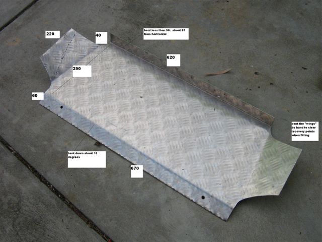

                            Did a quick measure up of plate.
                            The "wings" may have to be trimmed to clear the recovery points, I took the measurements off the spare one I made up. The one in the photos show how I had to trim the wings . I bent them up by hand after the final fitting of the bolt holes.
                            the front of the plate is bolted up through the two lower holes behind the numberplate. the back edge picks up the two unused threaded holes at the front of the existing plate, I marked them by holding the plate in place and used a sharpened bent welding rod to mark through the top of the holes. Two of the bolts that held the bumper on were perfect as they already had a large washer fitted.
