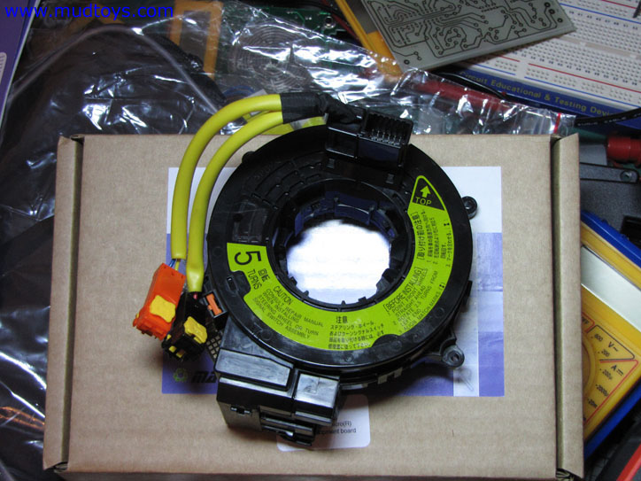

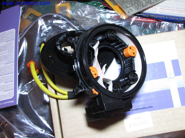

    11. Insert the steering spacer in the rag joint (under the steering column inside the vehicle – you need to be a pygmy contortionist to get there. BIG WARNING…. DO NOT spin the steering wheel while doing this – we did, and destroyed the spiral Switch in the horn cover – Mr T wants £200 for a new one. So now I have no hooter, no air-bag and no cruiser control!

    Anyway, it’s done – a new Spiral Switch is on it’s way from flea-bay, and that will fix the last electronic niggle. I still need to decide what to do about the rear bumper cover – I feel a custom build coming on …

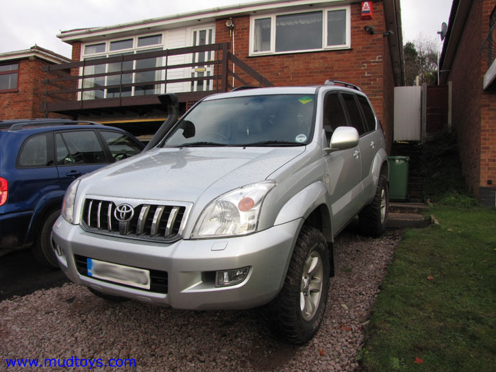

    Some photos were taken, but as the problem list grew longer, time grew shorter, and the camera was left alone. I’ll post what I have later. The final result is this:
    Thanks to Chris Jerman, without whose skills and abilities this would still be in bits in a driveway :lol:

    And this is the bust Spiral Switch

      Those airbag spines are a pita, your not the first to break one, apparently they are only good for a few turns each way, best thing is to remember to lock the steering before starting.
