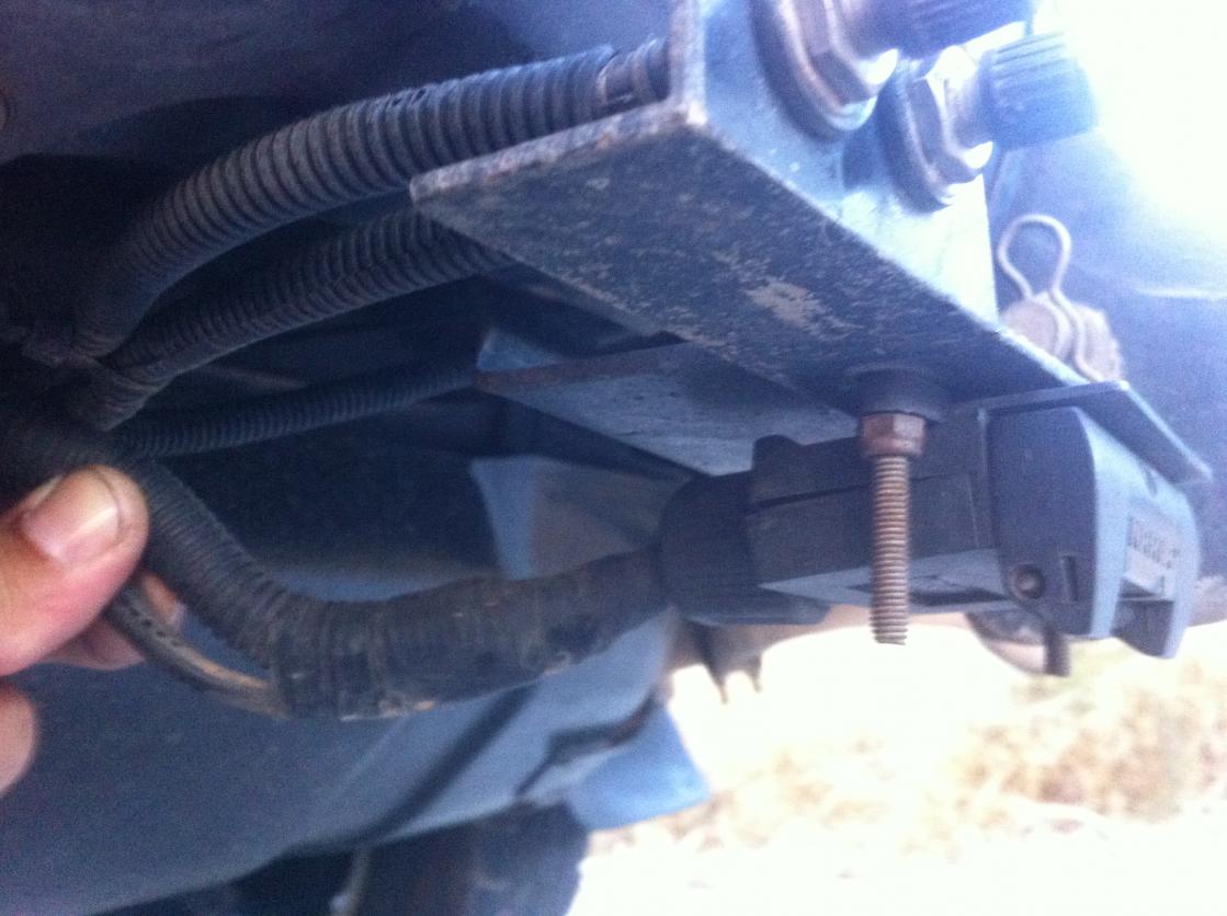

    Hi all, I just bought a 2005 GXL Prado and it was advertised as having a electronic brake controller. I have looked everywhere and can't seem to find anything that looks like a control box. I think previous owner may have taken it out.
    Did the 2005 come out with a factory fitted wire harness that is a plug and play? And if so where would the plug be located under the dash and what would it look like?
    The Narva 7 pin plug at the tow point seems to have what looks like extra wiring spliced in, more than any of my other vehicles.

        So any idea what the extra wires are that are spliced into the 7 pin?

            What colour is the extra wire? If its Blue then odds are its for a brake controller, if its not it may be a Power wire for accessories in a trailer.
            If it had a brake controller that was removed chances are they left the wiring in place, have a look around under the dash for 4 wires, they should be black, white, read and blue for a brake controller. If you find a non genuine plug with that wire combination then you are likely on the money and you can check continuity to the trailer plug to determine if they are in fact the wires you are looking for.
