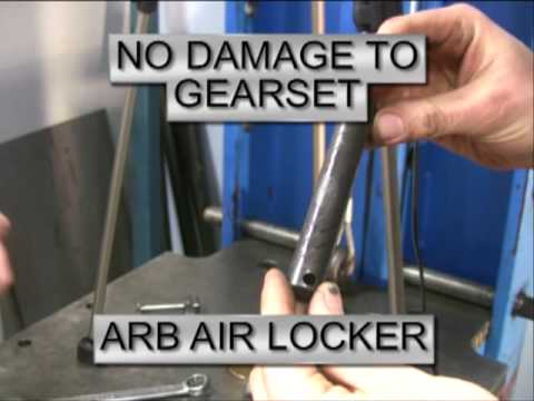

            ARB Air Locker vs Yukon Zip Locker
              Very impressive. I'm not likely ever to have a locker, but what an eye-opener this is.
