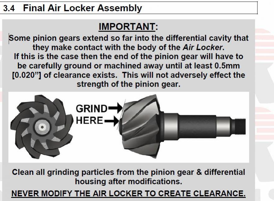

I have a set of ARB lockers to fit. My Prado has done just over 100K with no noises from the axles.
What are peoples opinions on the following?
To replace the bearings as a matter of course?
What brand of bearings to use? Are Koyo bearings a good brand? http://locktup4x4.com.au/hd-master-i...rear-1690.html
Should I fit a solid pinion spacer whilst it is all apart? Can the pinion bearings be safely reused?
Pros and cons please folks?
