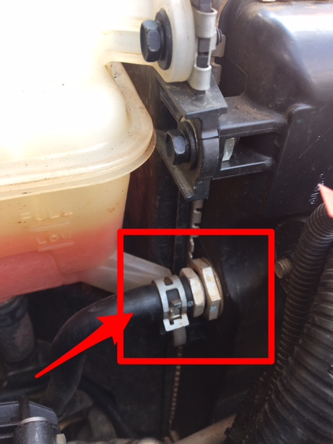

      Yes that is how I got onto the whole transmission cooler stuff at first place. But he has 150. I guess it is this hose I need to connect to the coolerClick image for larger version
        Yes that is the correct port coming out of the radiator, which then goes into the trans cooler.
