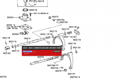

          Does this help? I'm not sure why when I attach pics full size they end up this small.
Name:	parts transfer shift.PNG
          The 1GR transfer is a top shift by the looks of the parts diagram, you won't be able to mod the high low rail (the one with stop) as that butts onto the outside front face of the transfer to limit the rear most travel of the rail. On the 1GR one the shift gate is inside the transfer case. Need to rethink that one. The lock gate (the one widened) will be just the same mod.
Name:	1GR parts transfer shift.PNG
            thanks
            cant quite see it as it is small
            which is the left rail & which is the Right rail ?
            on the lock unlock shaft is that the one with the new wide slot?

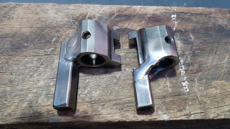

              Modified gates
Name:	shift gates modified not yet cut to length.jpg
              These lugs aren't the finished dimension, I waited until the transfer case was back out of the car to cut them to length.
              I used 10mm square bar tool steel. The gates are manufactured from case hardened steel for durability and wear resistance. This gate isn't subject to much force in use, the shift rail moves the lock hub fork on a double spring arrangement for lock and unlock plus the detent spring and ball pressure. There aren't any real worries the mod will weaken the gate to the point it would fail. If that were to happen, the broken part wouldn't cause any issues because the gates and gear lever are in the transfer case adapter void, not the transfer case itself.

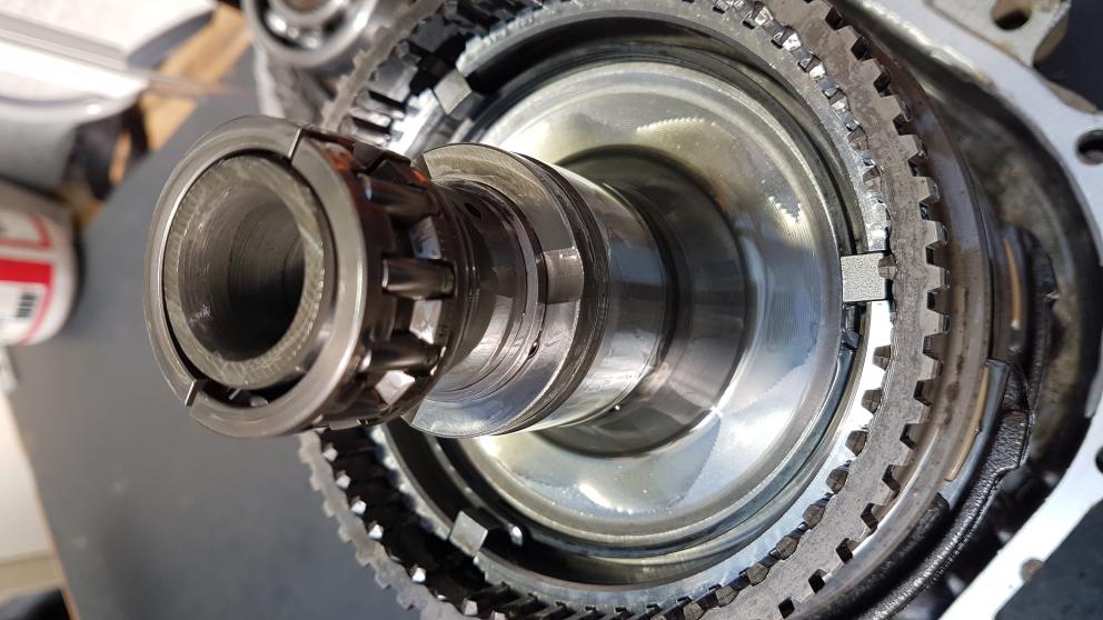

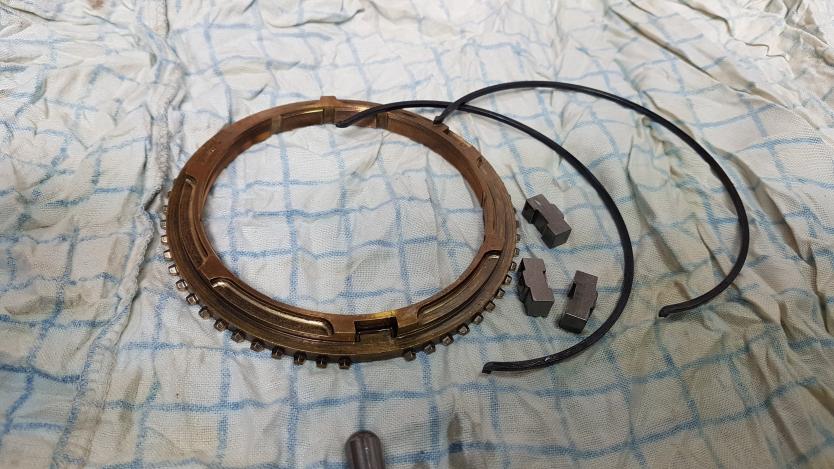

              Stripping the box is pretty easy, though there are 3 synchro dogs in the high/low range synchro hub, that are held in place by 2 spring loaded rings which probably will fly apart when the front casing is removed. Lose one and you are up sh!t creek.
Name:	high low synchro hub 3 dogs.jpg
Name:	dogs and spring synchro cone.jpg
              3 synchro dogs held in place by the 2 spring clips

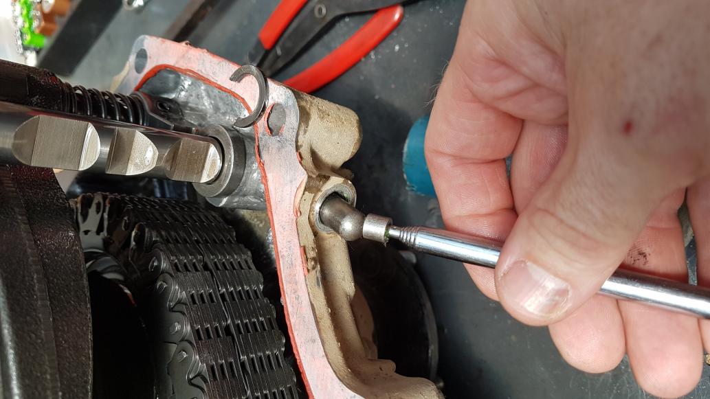

Name:	remove interlock pin and circlip.jpg
              Removal of the interlock pin and circlip. Remove one of the plugs on either side of the case, remove the spring and ball, lift the rail shaft and use a magnet to remove the pin. Drop the rail back in and refit the ball and spring. Seal the plug threads with silicon sealant.

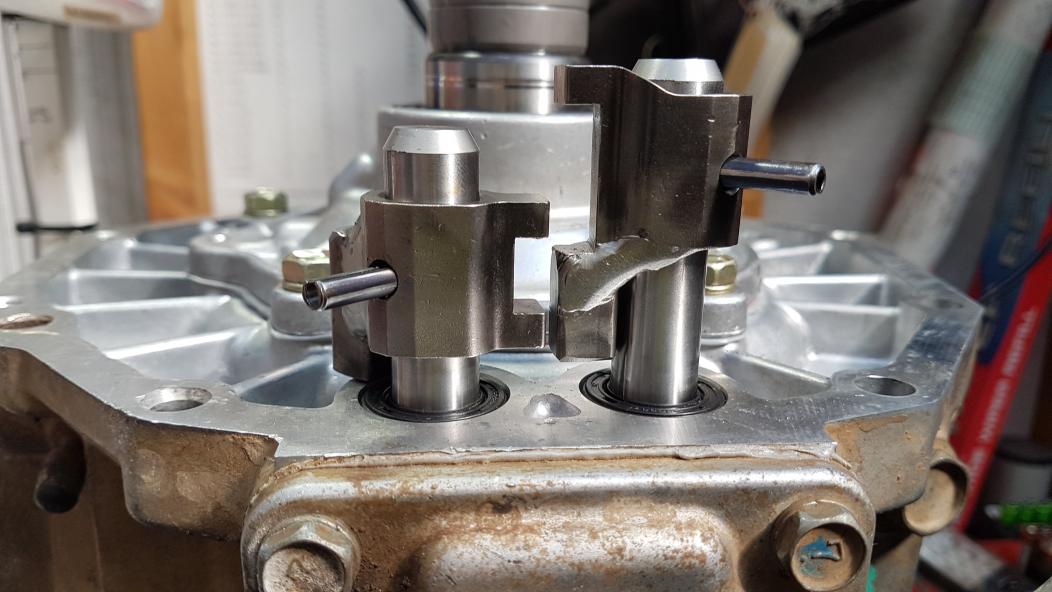

                Finished modified shift gates
Name:	modified gates on transfer.jpg
