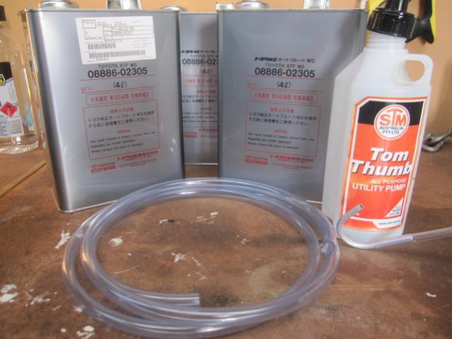

        Completed the flush tonight.
        Went to Toyota and got 12 litres of the WS ATF fluid and into clark rubber for some 10mm clear vinyl tube. Straight forward job, especially with the tom thumb pump. This is my favourite service tool along with my magnetic spark plug socket.

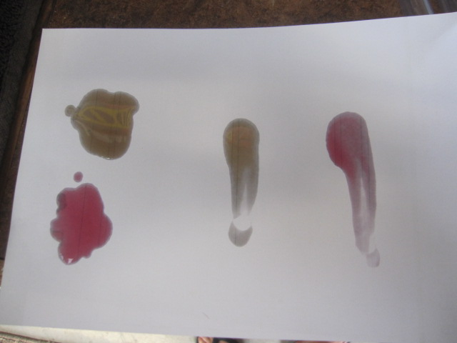

        Fluid was pretty dark but didn't smell burnt. I'm guessing it hasn't been changed before. Car is V6 5 sp and done 135k.

        Took it for a quick spin and certainly noticed that the gear changes are sharper.
        Thanks for all the valuable advice, certainly gave me the confidence in getting the job done.
