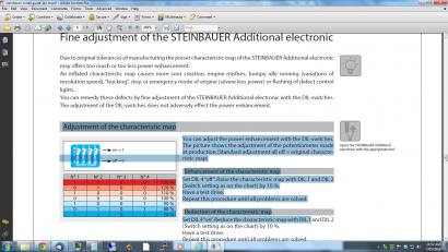

      My Steinbauer's adjustable..
        Tell me more......... Couldn't see anything about adjusting them on their website.
          Here's a screenshot of the Steinbauer install manual
            my Steinbauer is also adjustable
              Signed up to Steinbauer and was able to download the instructions that show they are adjustable. Thanks heaps for your comments.
