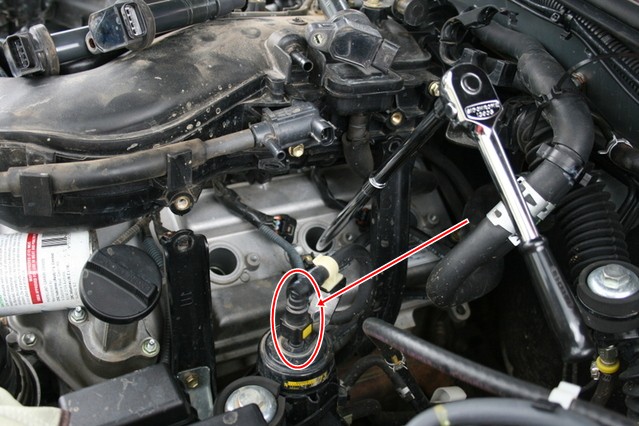

    I have tried and tried and tried. Does anyone know how to get this clip of the fuel filter.
    I have tried pushing the 2 yellow clips in while pushing the connecter down, i have tried everything i think. :roll: and still cant get it off.
    I am doing my 80,000km service and are changing fuel filter.
    Oh and i stole your pic Matt from your Spark Plug change, hope you dont mind cheers :mrgreen:

    Yes you only need to push the two clips in and pull on the connector....Have may have to depressurise the fuel system first.

          I think you need to push the 2 yellow clips and pull up not down. Because the two yellow pieces clamps onto the fuel filter spindle.
          Hope this helps.

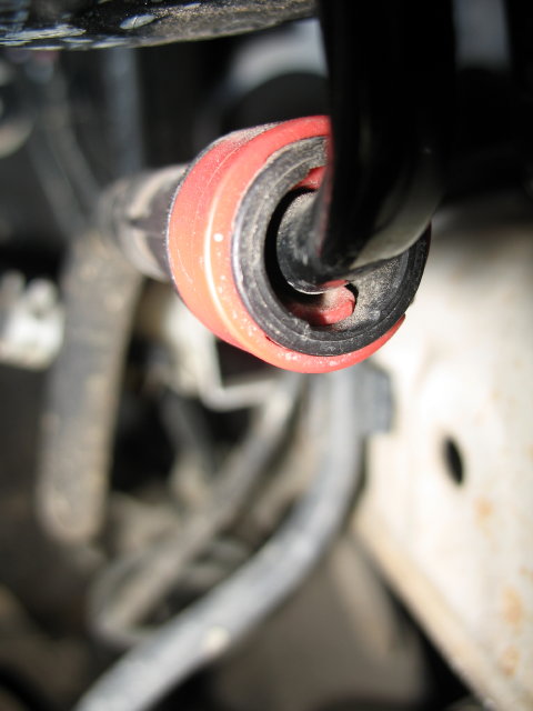

                    Apologies for reviving an old post...I'd like a steer on how to remove the bottom hose on the fuel filter...which way to turn and or move the red clip, have attached a picture to clarify which clip I'm referring to.

                    Just replaced the orig picture with a better close-up of the clip.

                      I am also trying to undo the hose with the red clip. Dont want to accident use to much force and break it. Anyone know what the go with the clip is?
                        Got it, just need to peel the red clip back. The red clip itself has a little retainer and a "tooth" that clips to the hose.
                        Peel the retainer part back until the tooth detaches. Then pull the hose off
