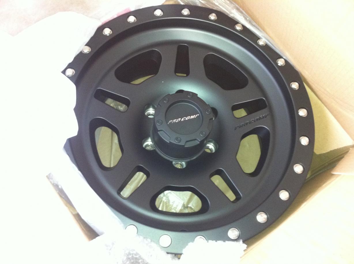

    Hey guys,
    I am soon installing procomp 5029s on my 2005 LC
    Someone told me that the OEM lugnuts will not fit ?!?
    Anyone has experience with that?
    What lugnuts should I buy?
    I attached a pic of the wheel
    Thanks so much
    to me it looks like you will need just a normal tapered nut, the standard alloy wheel nuts have that large collar on them that wont fit with those wheels, you can pick up replacements for about $1.50 -$2 per nut, dont pay more than that (toyota want $7 per nut)
    anyone confirm?
      PROCOMP can supply you with a new set of wheel nuts with a socket to suit.
      the procomp wheels have a smaller bore for the wheel nuts, which means the standard 21mm nut will fit, but not the impact socket. a thin wall socket will do up the 21mm, but it will take the powder coat off the wheel.
      best to get the wheel nut kit off procomp.
