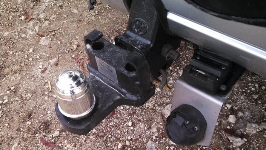

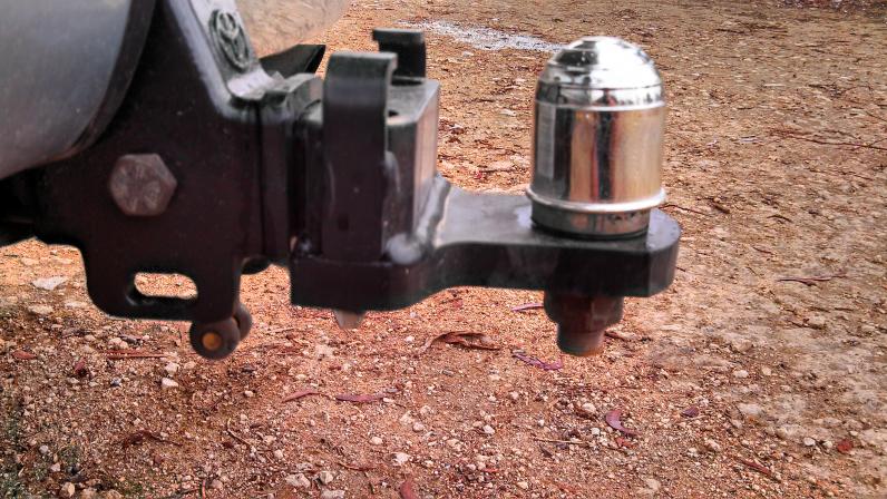

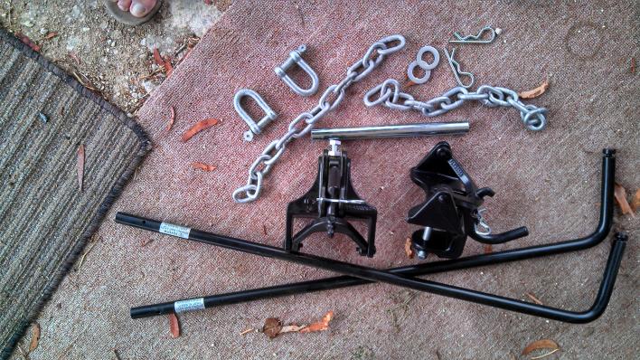

                  • Toyota do make a Genuine WDH kit and if you have a Toyota tow bar with an after market WDH they will replace it with a Genuine one, had mine checked on Monday 30/12/13 all ok and my replacement WDH is on back order.Click image for larger version
ID:	646085Click image for larger version
ID:	646086Click image for larger version
ID:	646087 Hope the photos explain.
                    Cheers Johnx3
